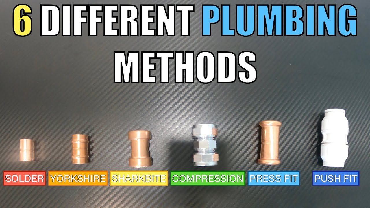

After studying several very good videos, meticulously reading the documentation for the faucet my wife ordered and praying a lot, I successfully installed all the new hardware and faucet today. Not even a hint of a leak either, which was my biggest fear. Did you know that there are now six different ways to plumb water connections? There are probably more since there is PVC and PEX piping now. But here are some of the options depending upon tools and skill level.
Here are the ones:
SOLDERED FITTINGS
YORKSHIRE FITTINGS
PRESS FIT FITTINGS
COMPRESSION FITTINGS
SHARKBITE FITTINGS
PUSH FIT FITTINGS
from this video:
In any case, I used compression fittings to replace the old soldered ones, bought some new flex hoses and everything looks much better now.
