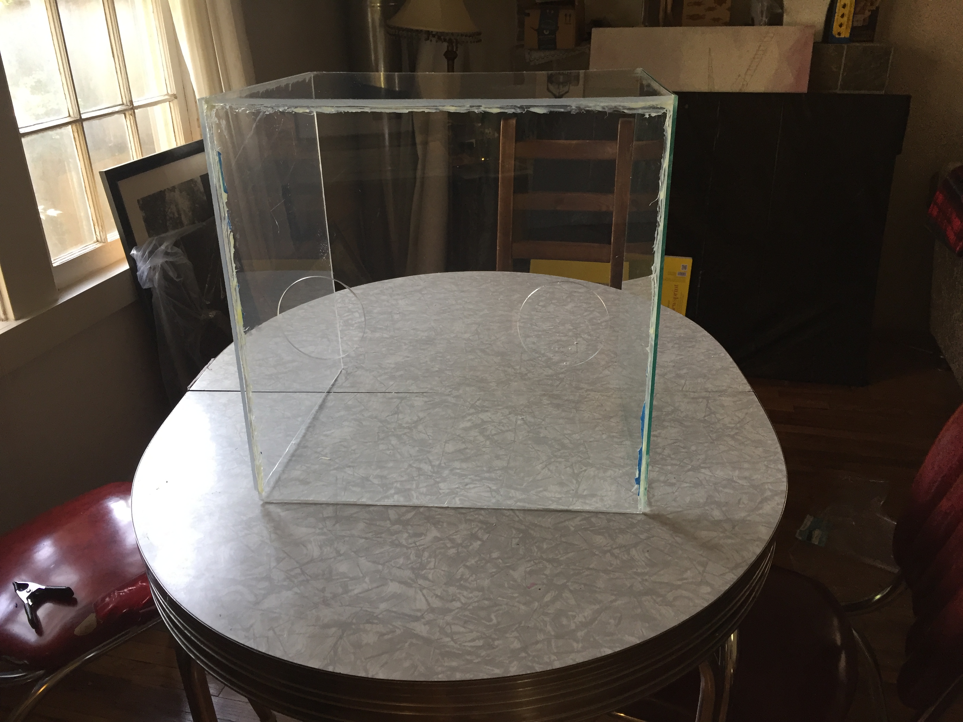

Does anyone know of a location/space in the area that can cut plastics while the DMS is closed? My sister in law is an ER doc, and she asked me to make an aerosol box to give a buffer between the patient while doing invitations. I made a prototype (see attached), but it really ghetto since I had to cut and glue everything by hand. I was hoping to use the laser at the DMS (or table saw), but could use other suggestion to make a couple more units. Thank you for the time and help!

Sorry, but laser is also a poor choice. Laser cut edges will crack and craze when you use the glue.
Your best choice, if you can find it, is a table saw (with a plastic blade if possible), and then clean the edges with a router before gluing. A sawed edge is insufficient for a solid, stable glue seal.

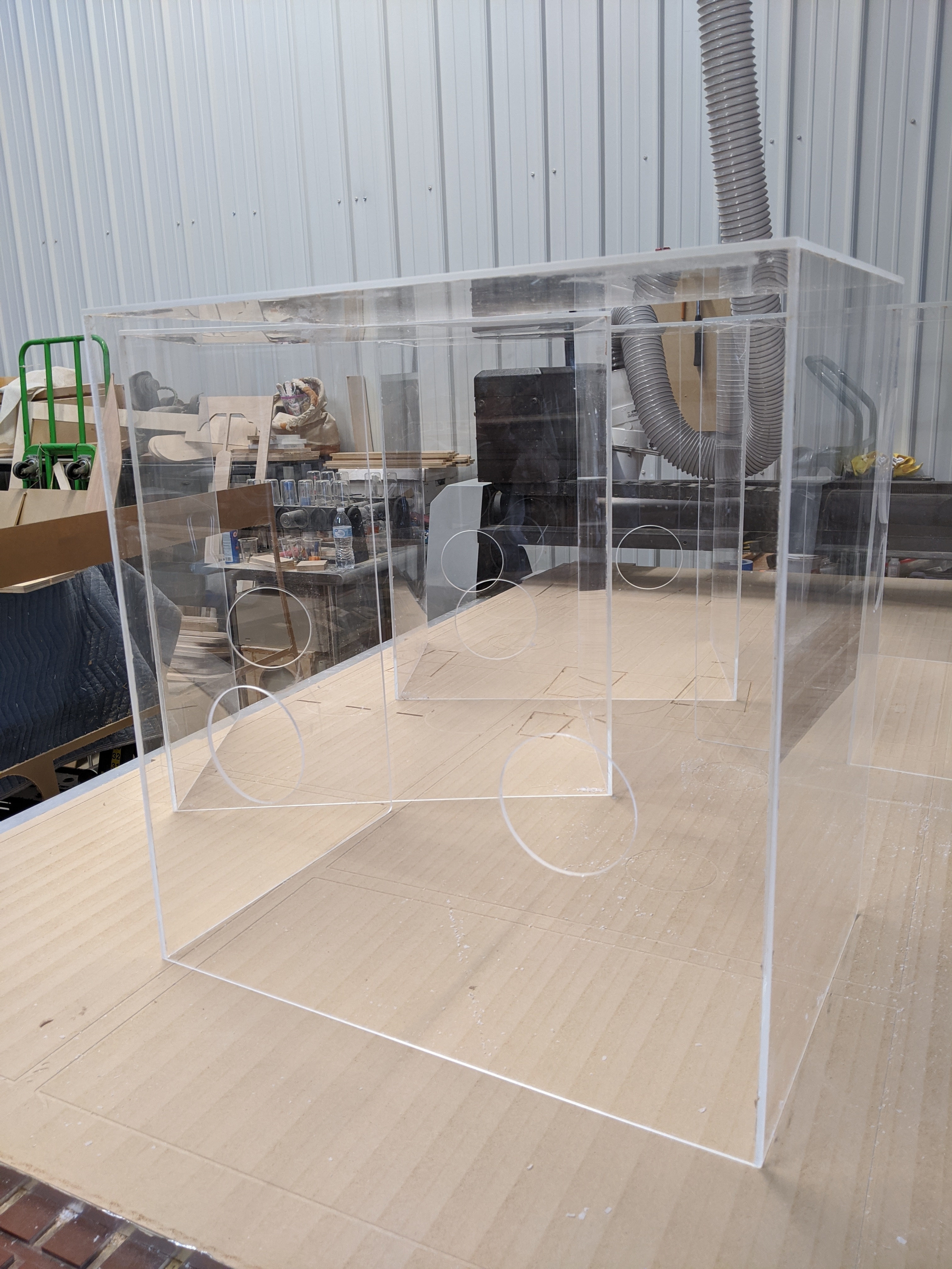

Just a follow-up on this request. After Josh got hospital feedback on the prototype, modifications were made to the design and 4 aerosol boxes for intubations were completed today.
