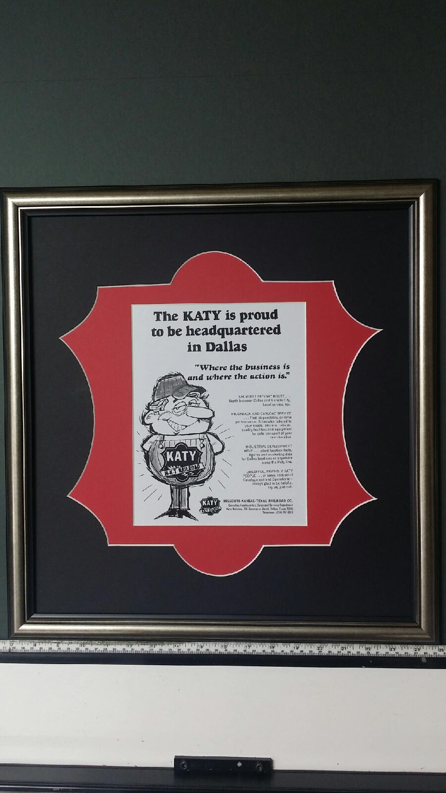

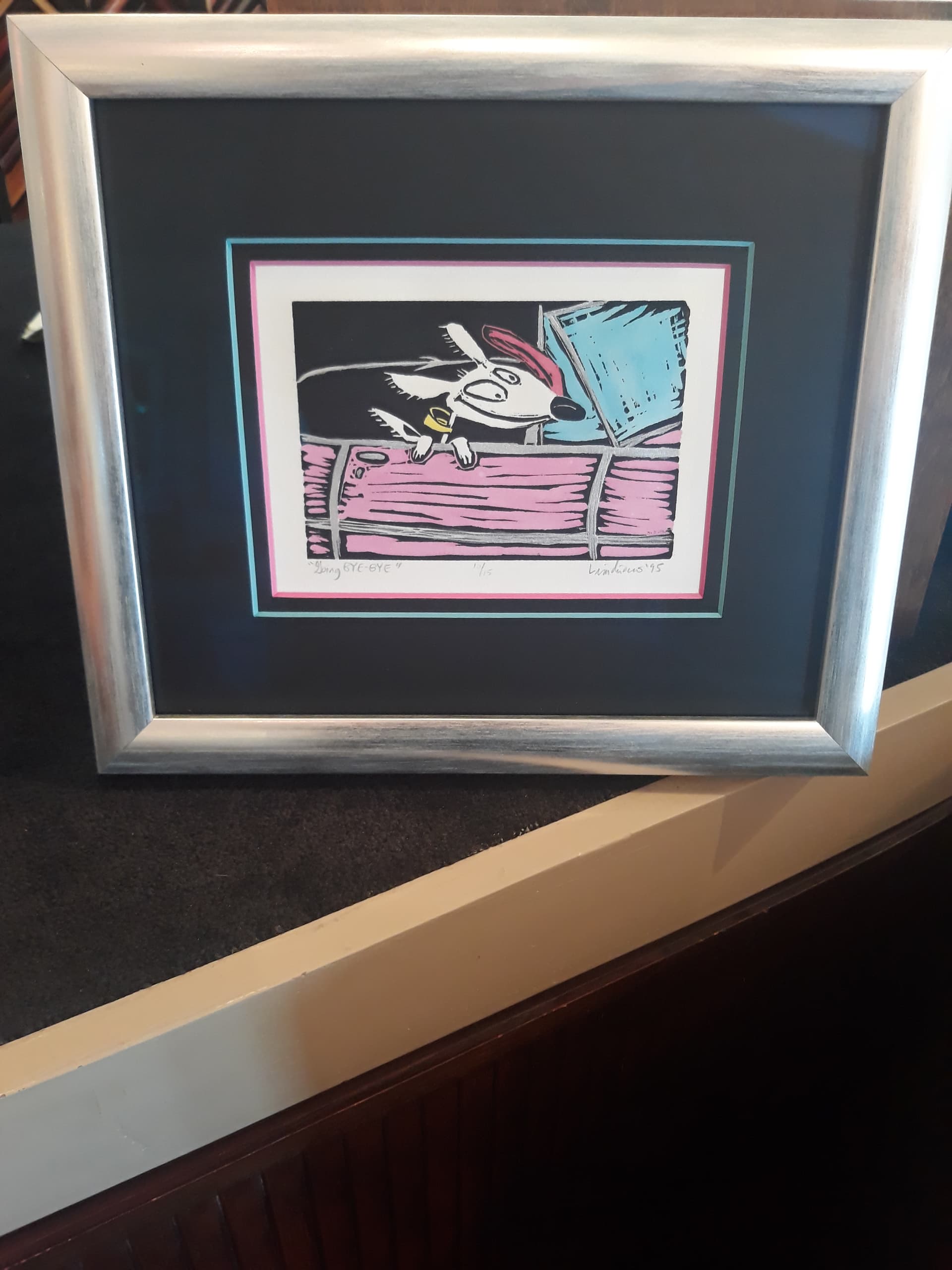

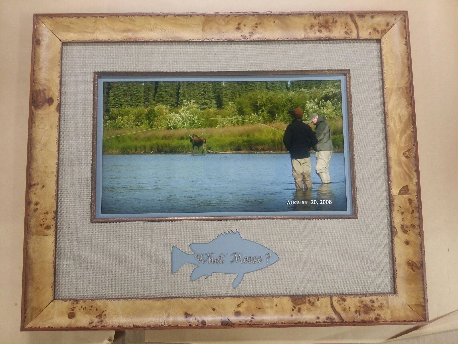

Below are couple of “just for fun” projects.
The 2 blind guys fishing mat was cut via a DMS laser - the other two were from misc scrap in my frame shop with one of my computerized mat cutters with the white and coloured bevels showing.
The katy railroad was something I donated for one of their fundraising events.
