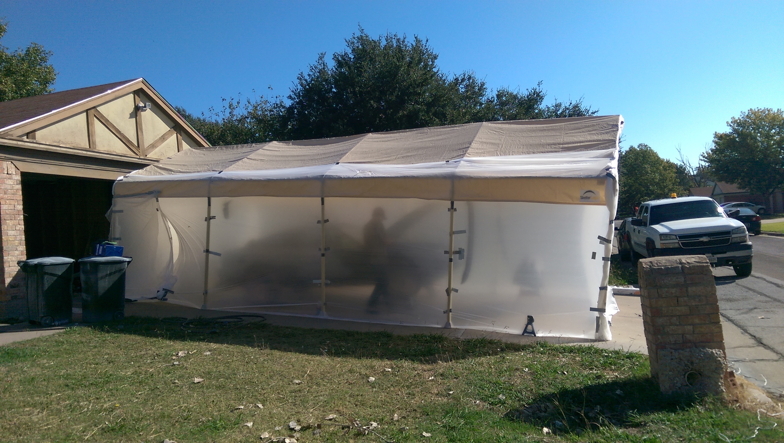

This is the setup I used to paint my 240SX last October.
In hindsight, we should have come up with a better design for the sidewalls than duck tape-secured plastic sheeting. I’m still considering riveting button clasps into the roof panel and some tarps to make a better set of walls.
While it was all up, it did great keeping overspray in and dirt out. Since we were working with a gun, the paint was dry by the time it hit the ground, so cleanup wasn’t a problem. Aerosols don’t always have this advantage, though keeping the floor from getting painted is easy with sheeting.
With that said, even with the ventilation we could get from having it outside, it still filled up with a mist of particulate, which may or may not have been highly flammable. We wore respirators all day.
This would not be appropriate indoors without a significant ventilation system, and likely fire suppression to keep the regulators happy. (Warren G doesn’t like it when you have volatile mist everywhere)

Yes, for general painting like that, you can get away with a surprisingly small space. Painting a whole car, though, I think the smallest you could reasonably get away with is about a 20’x10’ area. We painted my 240SX in 26’x12’ and it was just the right size to pull the bumpers and paint them off the car, with just enough room to move around everything. Of course, at the size of that booth, we could reasonably cram a crew-cab pickup truck in and have just enough room.
