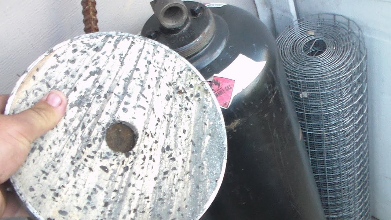

Not sure how to estimate. We always had big tanks and when the pressure was low they were replaced. But we, students, weren’t running a lot of gas for very long so was never an issue. Acetylene tanks aren’t empty. Go to 6:20 and you’ll see what is inside. They have acetone in there that the acetylene dissolves into and everything is in a porous mix that fills the tank - acetone has been removed from this tank.
