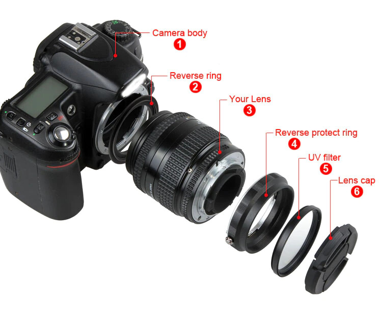

When you have an object that is say 1" wide and your lens is over twice that width (60mm) you get distortion the light at the edges are bent a lot, you can use a lens reversal adapter which allow the lens to be mounted backwards on the camera. The lens that exits inside the camera usually less wide that the 36mm, closer 20mm. So the light isn’t bent as much.
Nikon lens reversal adapter 1-3 Body, adapter, lens
