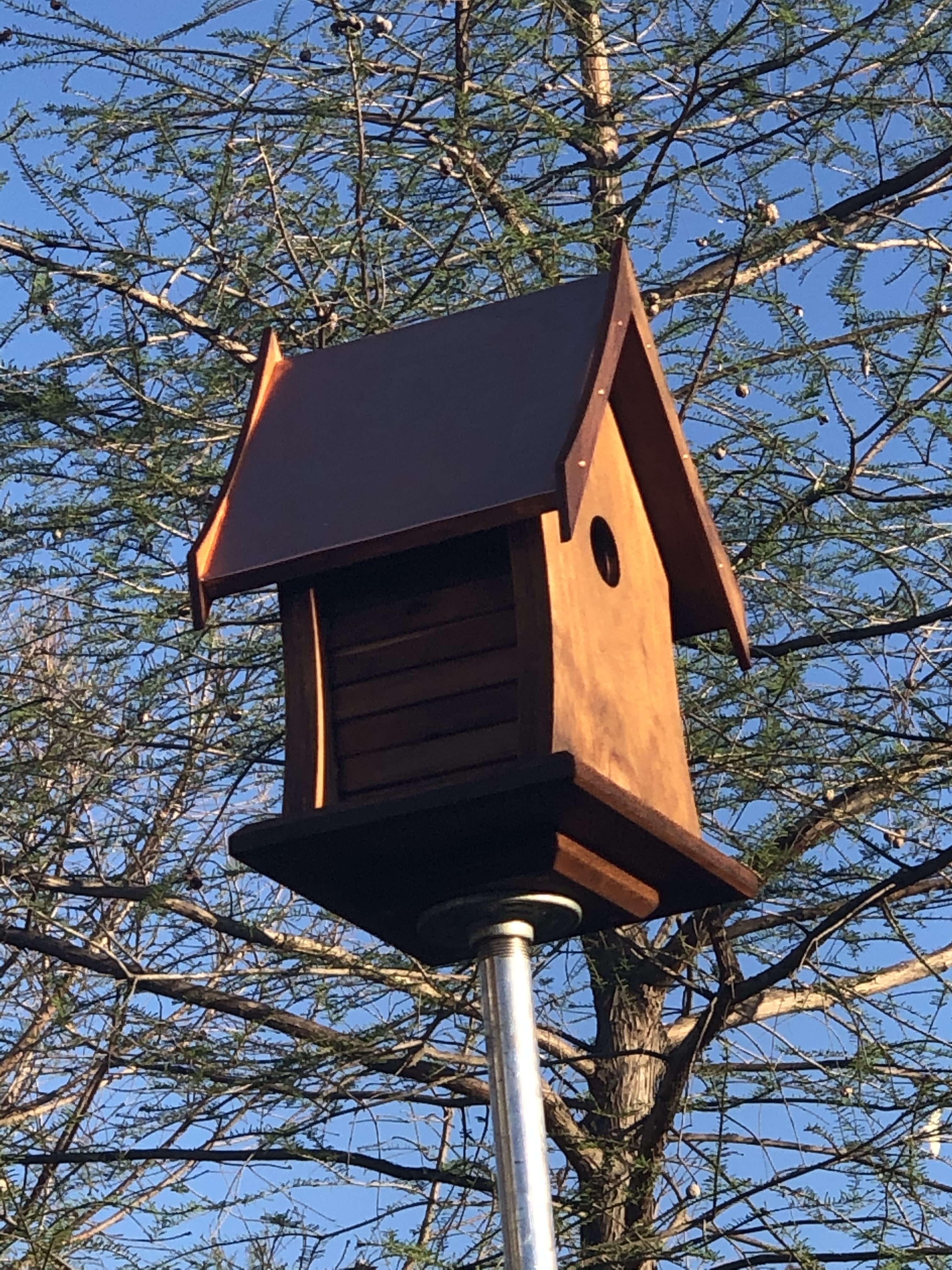

Needed to make siding for a birdhouse like below.

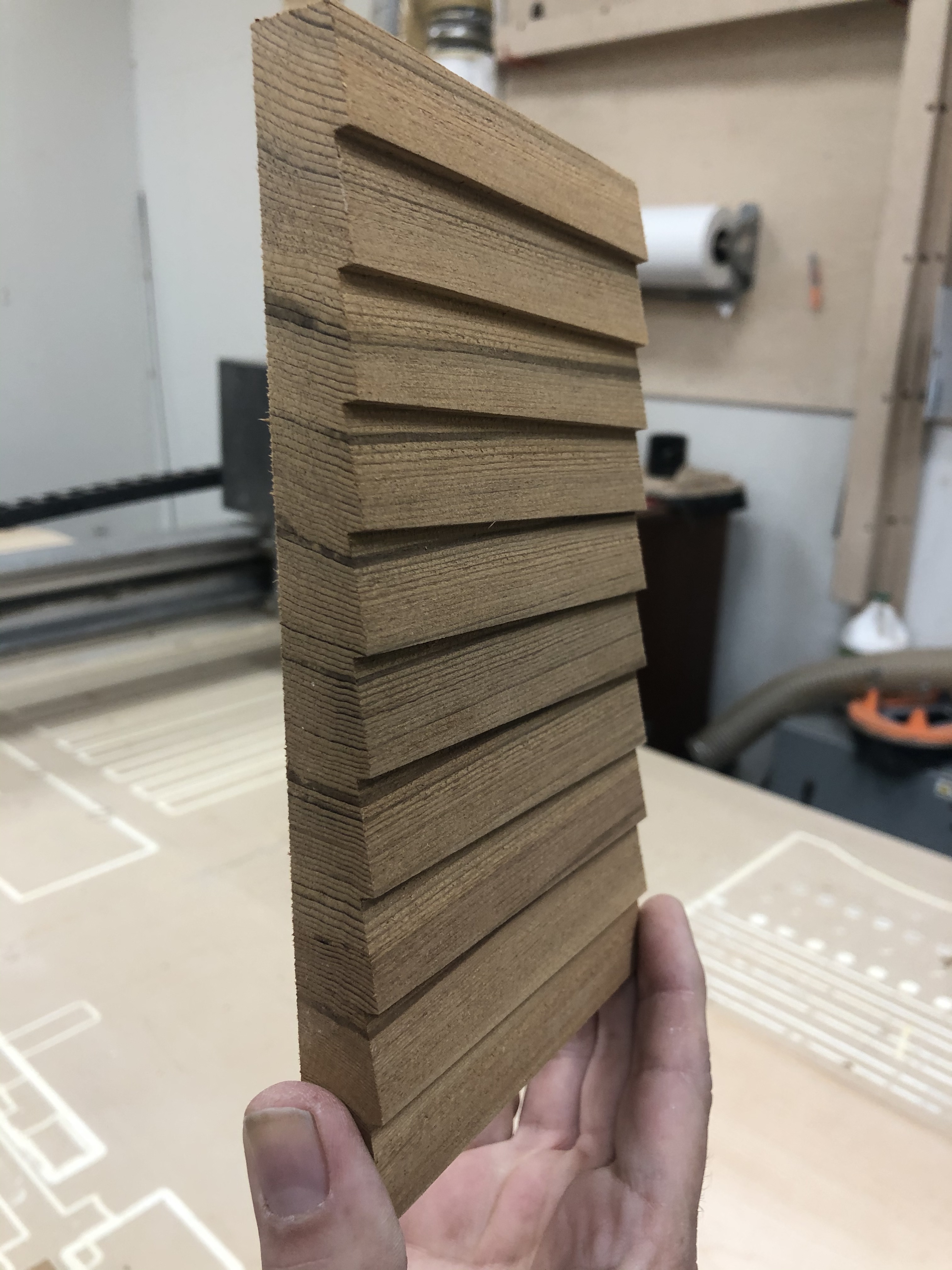

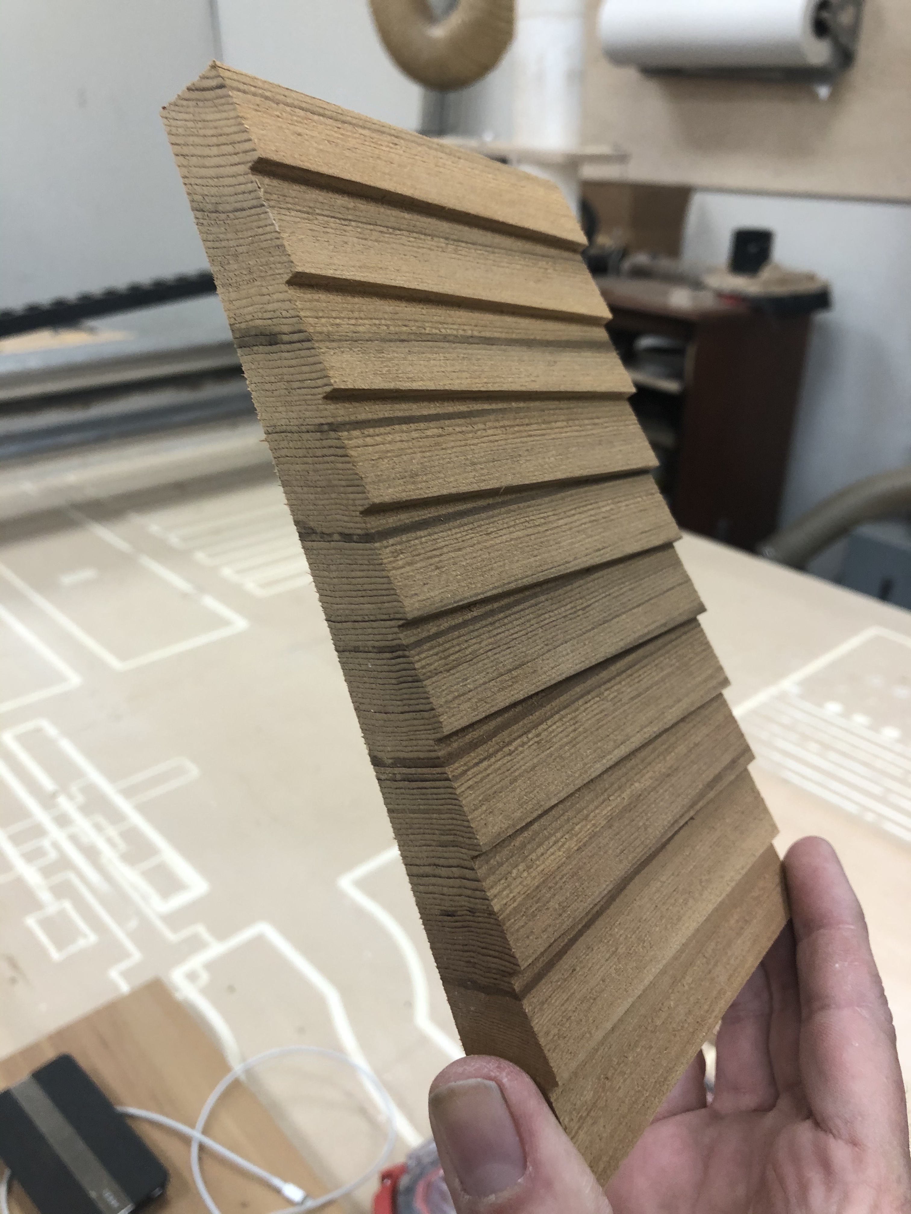

Have some dark grain through here: don’t confuse for cuts.

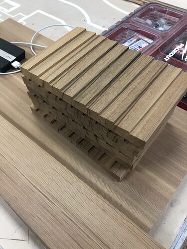

This is nothing but adjacent rectangular pockets cut at 1/8” starting depth from each other(0”, 0.125, 0.25.,0.375, 0.50, etc.), each 1/8” deep. The angle of the board controls everything else.
