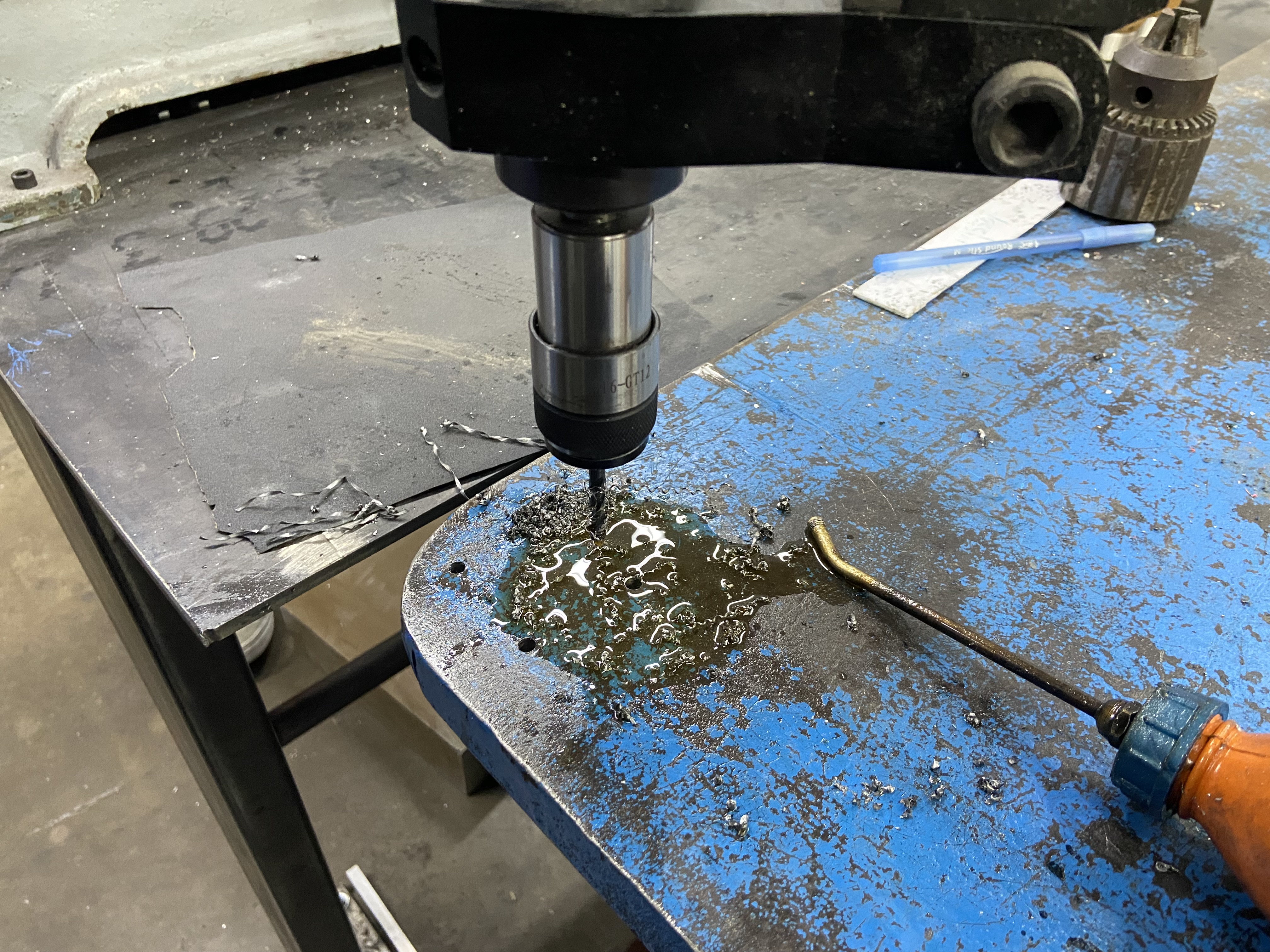

Hello all,

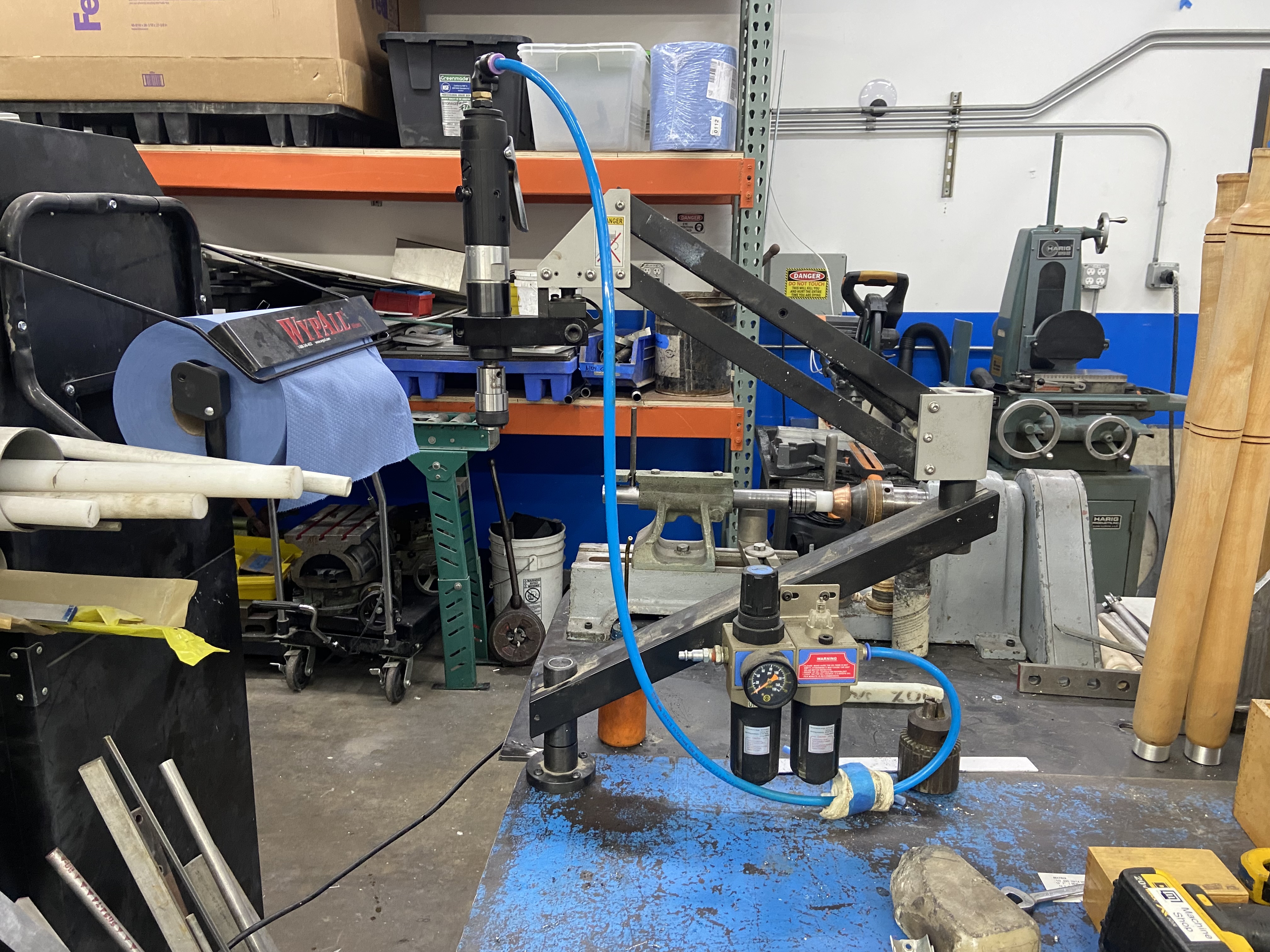

We have finally installed the new to us tapping head on the Machine shop blue table. We will be installing the airline to it soon.
In an ironic twist, I used the tapping head to tap the holes in the table for the tapping head.
What is a tapping head you may ask? Well you use a tapping collet with the appropriate sized tap. This will allow you to tap straight holes in materials. We will be installing an organizer underneath the table for the taps & tapping collets.

I have used a similar device a lot . The device is clutched so the air motor won’t over-torque the taps (probably) Small taps in tough material may still be a challenge . You also get much better results using spiral form machine taps . Straight flute hand taps will be more likely to break because they don’t clear chips the same way.
Spiral flute certainly is the way to go. This head isn’t too fast. I’ll have to look up to see if it is torque limiting or not. I don’t have the model number in front of me, I have it in my pictures but that’s a needle in a haystack trying to find it.
I can’t find our exact model. This is the closest I can seem to find.
This appears to be it. Found it on YT of all things, linked to a site that no longer sells them. Took the model number from that video to google it.
It appears the collets themselves can create the torque limiting in this style. I will track down a set.
