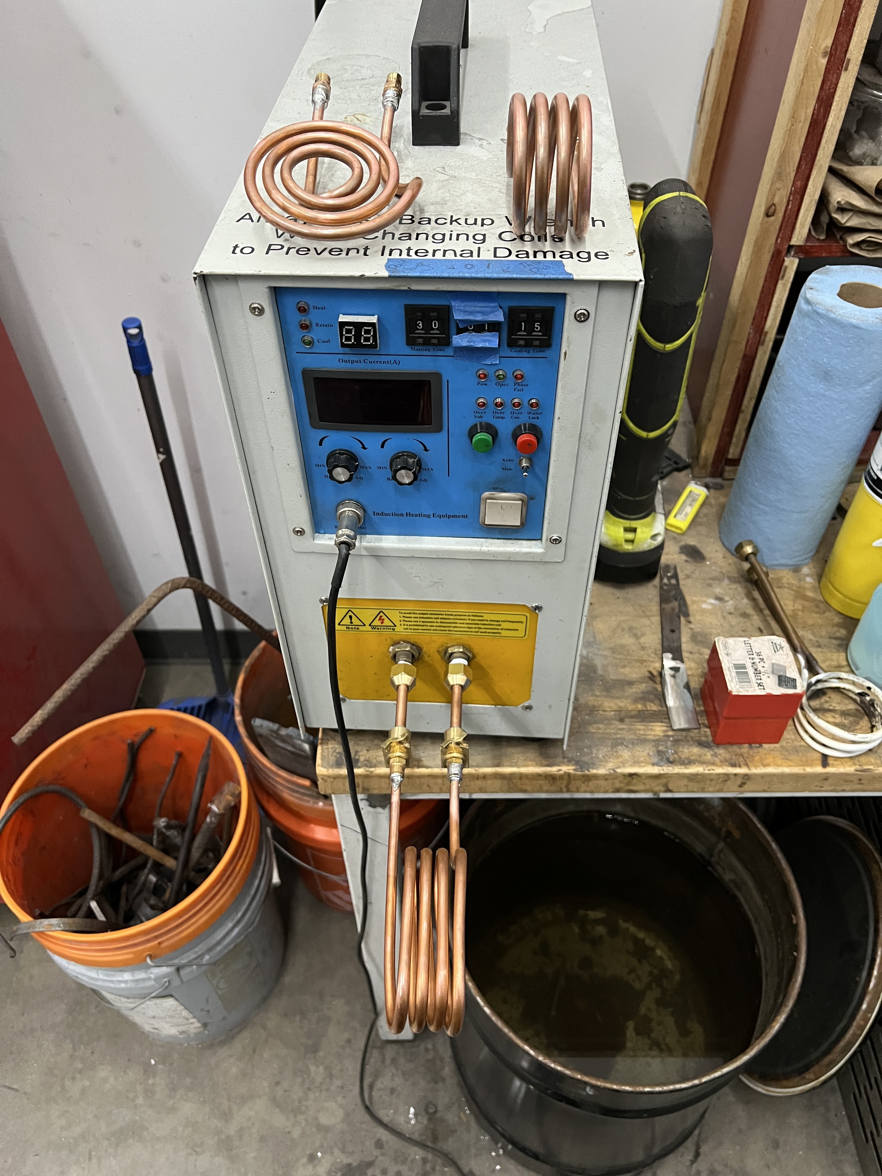

For those who use the blacksmithing induction forge for anything. There is now 3 new coils that have quick disconnect features. Which means if you need a different size coil for your work it’s a super simple way to get the coils swapped. Some warning before if you see this and are curious. If you are heating something up and need to swap to another coil give the coil a moment to cool and once cooled turn the induction forge in the off position so water doesn’t spray everywhere. I can see us getting some more coils in the future though these work great and have huge power output increases.

I hope this prevents the need to replace the connections on the induction forge. I’m glad that now we have multiple coil choices again. Great Job getting it installed.
