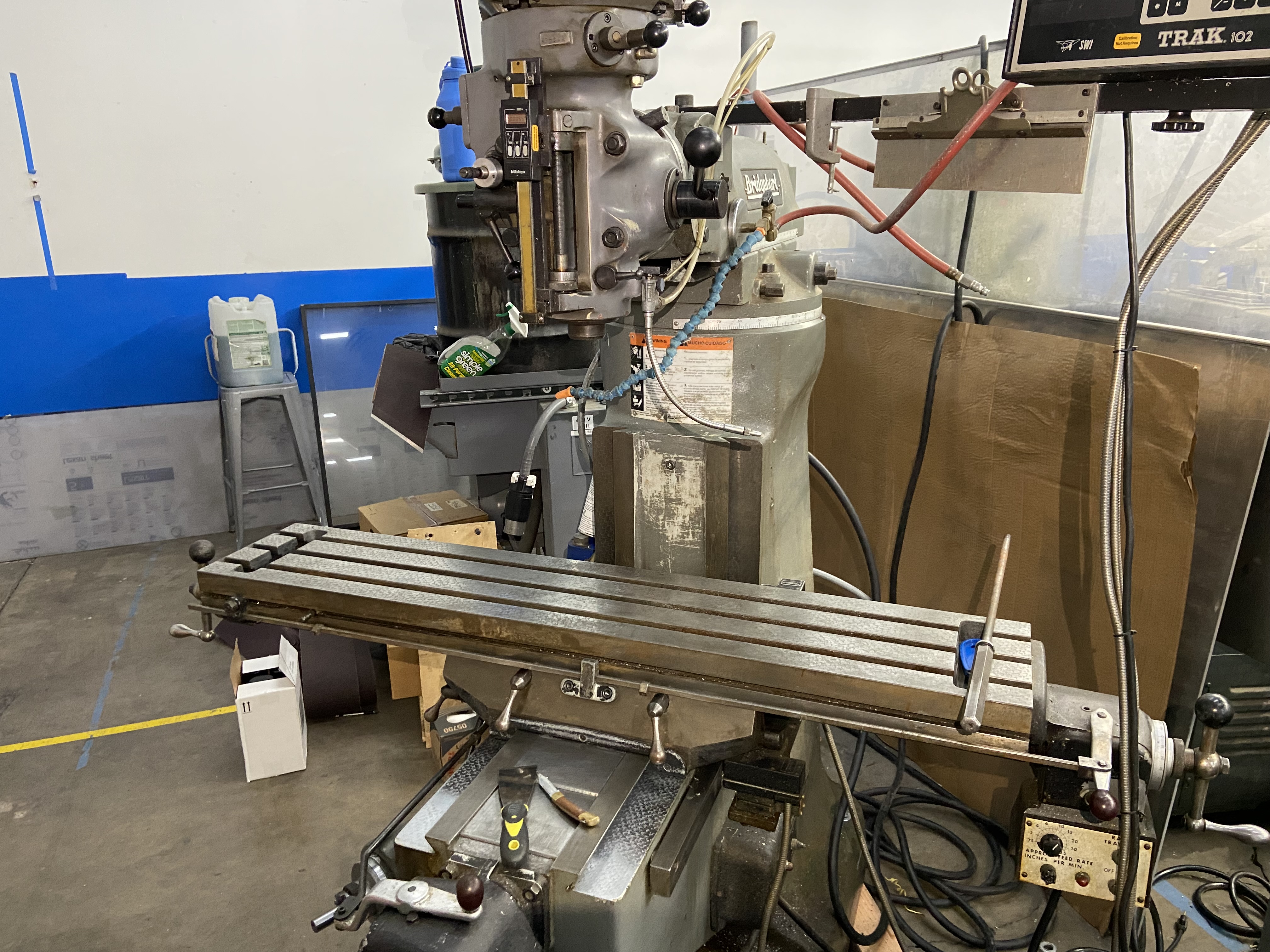

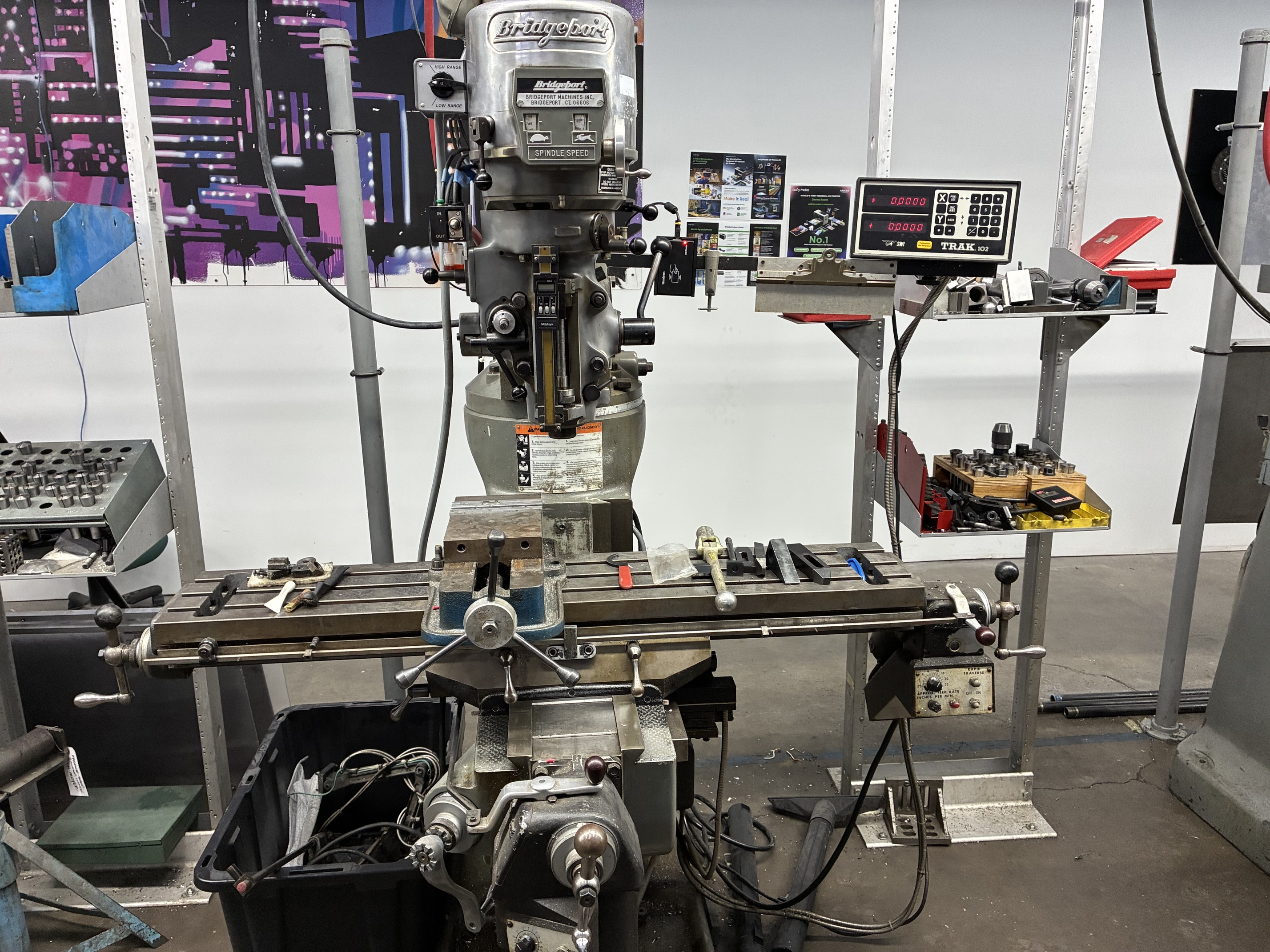

The new to us machine is coming along well. It is a newer machine. My looking around, it appears the head is 2000 or newer based off the Serial number.
The wiring for the motor has been re-wired for 208. It rolls in high speed to 4200 rippems. Upper spindle bearing/wave washer will likely need to be replaced.
The ways look really good(the hand scraping is almost pristine) , the oiler appears to be doing its job. We will need new felt wipers, I will be ordering those.
