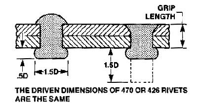

My first guess without looking is you probably have the incorrect Grip length and it is too long of a rivet and are having to upset more then you need.
Second, is the hole the correct size? If it is too big, it doesn’t take much, the rivet will move around making it hard to get a smooth upset. Upset should be about 1.5 times diameter of rivet shank.

I think my issue is holes to big…drilled some holes smaller and it worked rather well…now im just trying to figure what to do with most my holes a little to big…they dont need to be aircraft or structural grade…just hold. To often they keep rolling and then when they take…the copper the brass bars are mounted on often gets mangled…
Rivet should just slide in or lightly touch when put into hole, no side play. You’ll need to get the right sized drill for it.

i have tried on just copper scrap and the results are terrible. id say my problem definitely is holes to big…the rivet just tumbles. the ones that have “TAKEN” will hold for this but would certainly not be passable as proper shop heads. at first i was definitely using the wrong set. most of the successes have been when i did preheat the rivets. The rivets in the proper hole size fit and form with ease. The solution at this point is to replace messed up bars and to patch holes to large with a soldered in copper patch on the back side and redrill to proper size. its a pain but theres no way around this from where im standing. yes all of this has been very helpful.
