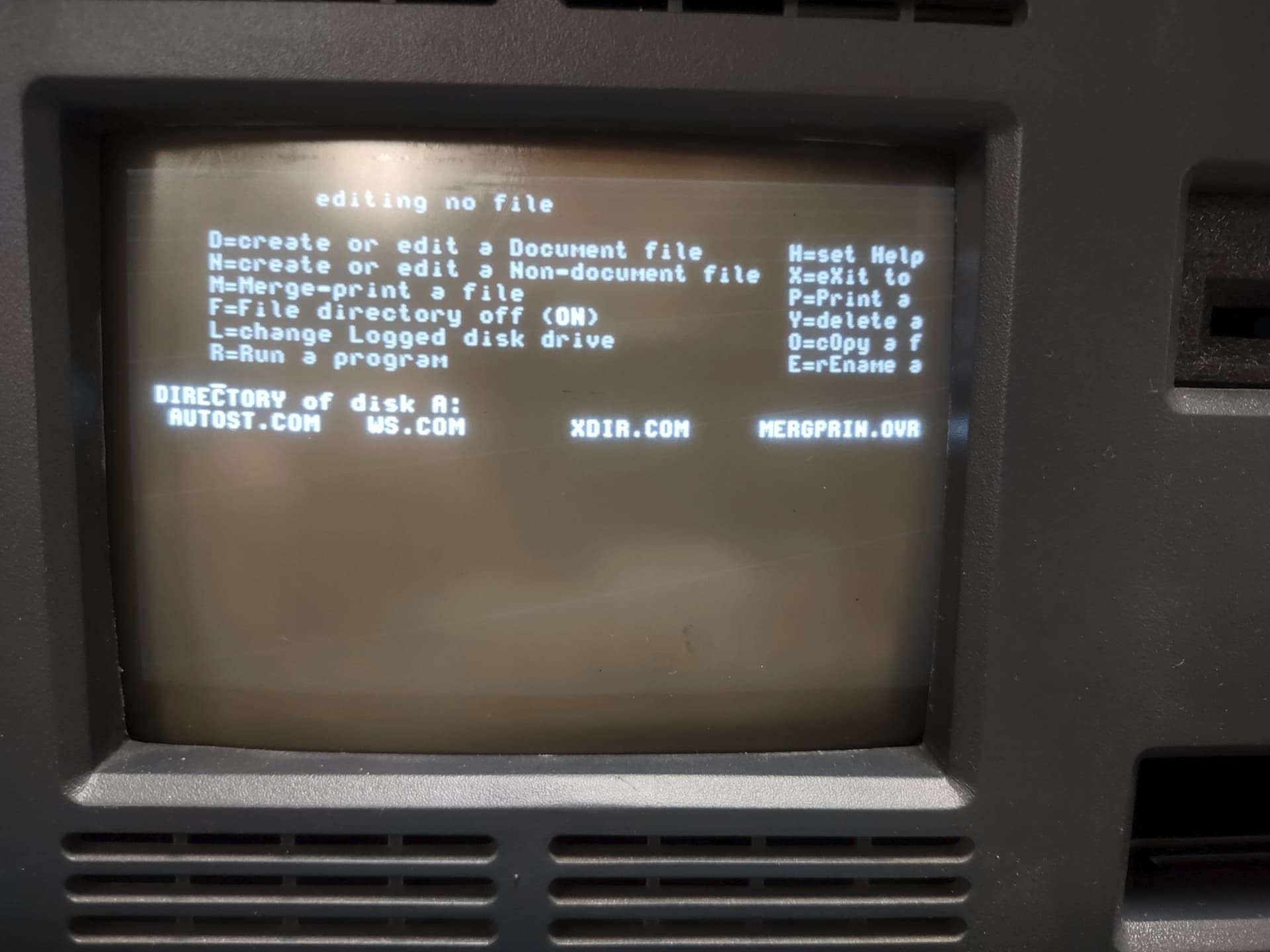

Disassembled it and found some screws floating around inside with one on the main board. Replaced one shorted Tantalum cap on the main board, 2 mains filter caps in the power supply were slightly bulging on top, and pulled the three RIFA caps. The screws went to mount the 2 floppy drives. Reinstalled those and tightened down the remaining ones.
