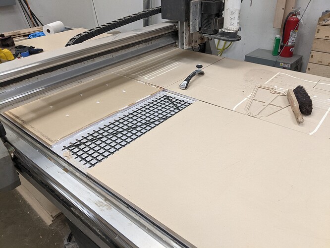

MultiCam Maintenance and Zone 4
The good news is that the double sided tape used on zone 4 has not left behind a horrible difficult to remove goo.
The bad news is that the double sided tape used on zone 4 simply does not work…
In addition about 1 mm of material from BOTH sides of an MDF wasteboard have to be removed. Just machining one side is not effective.
Brian, did it fail to stick to the MDF? If yes, was it before or after you milled the surface? Lastly, regular MDF or Ultralight?
Certainly YMMV. My experience has been no need to mill the bottom IF it is Ultralight. Also, when I put my spoil board down on the second CNC I recently acquired, I put foil tape on the edges and folded it under so the double stick was grabbing the foil surface rather than the MDF. So far it has held perfectly. Now to hope saying that isn’t a jinx!

I don’t know. I wasn’t there. Earlier I found the board loose with the tape well stuck to the bed and some bits of the board stuck to the tape.
I strongly suspect regular MDF. It has “finish” on both sides.

It’s LDF. 1234567890
That was me (with help). I needed to get a full width sheet cut and that zone has been marked inop for a long time. Knowing that a full spoilboard replacement is imminent, We went ahead and attached it as well as can be done with that tape, then surfaced the top side of the entire bed. That material is LDF. No foil tape was anywhere we could find it.
We’re going to work with @IanLee to procure a full 5x10 sheet of LDF and implement a plan for the entire top of the table.
On a happy note: based on observations during table milling, the spindle appears to be trammed perfectly.
What I’ve been doing for individual zones appears to be working well. Cleaning off goo from double sided tape is the time consuming part that we will not have to do again.
