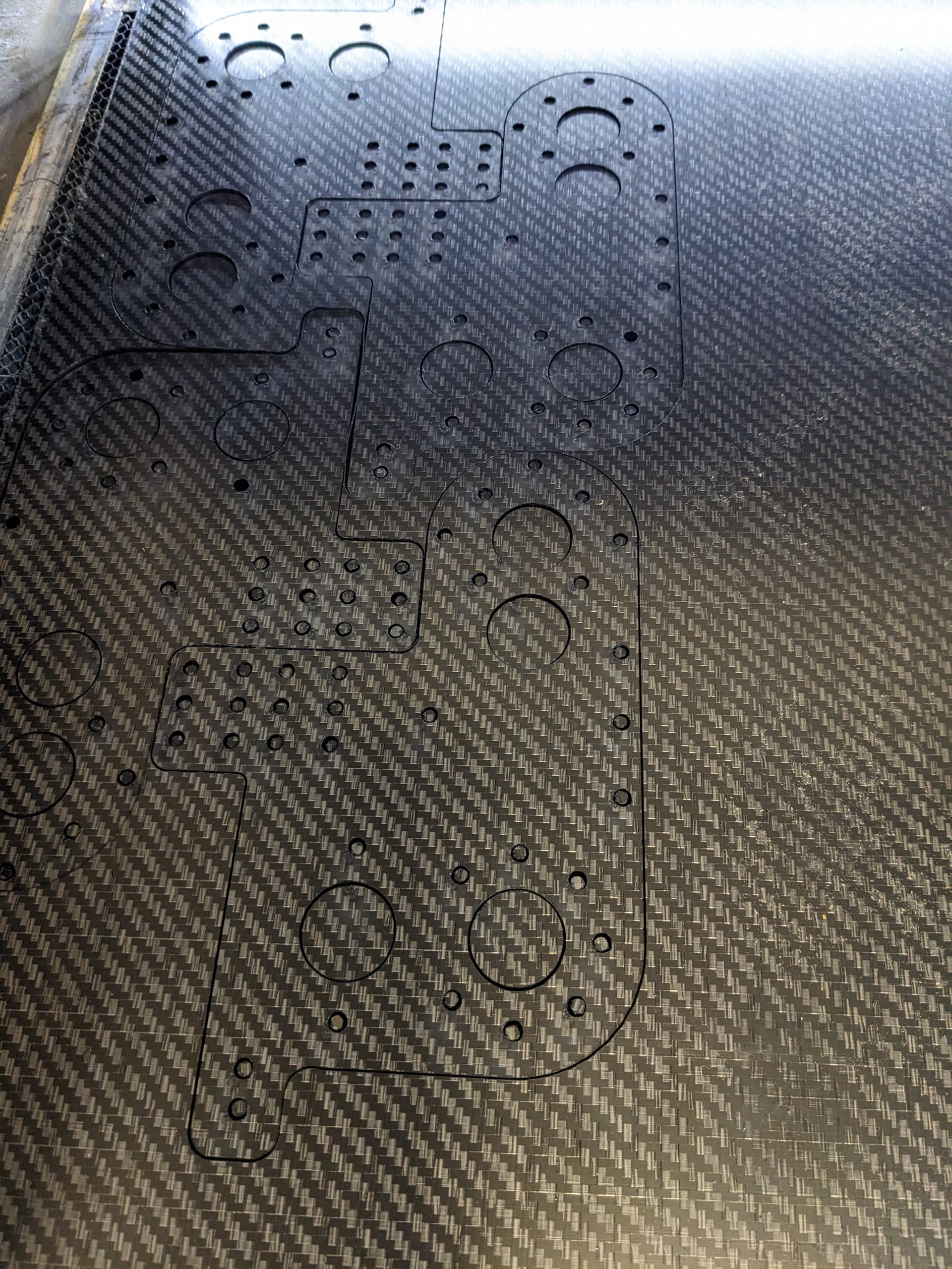

This is ~5mm thick SRPP (Self Reinforcing Polypropylene, generic name for Tegris) cut on a 100w CO2 Laser (not the DMS). Once you dial in your settings it cuts really nicely with minimal over melting and clean up.
