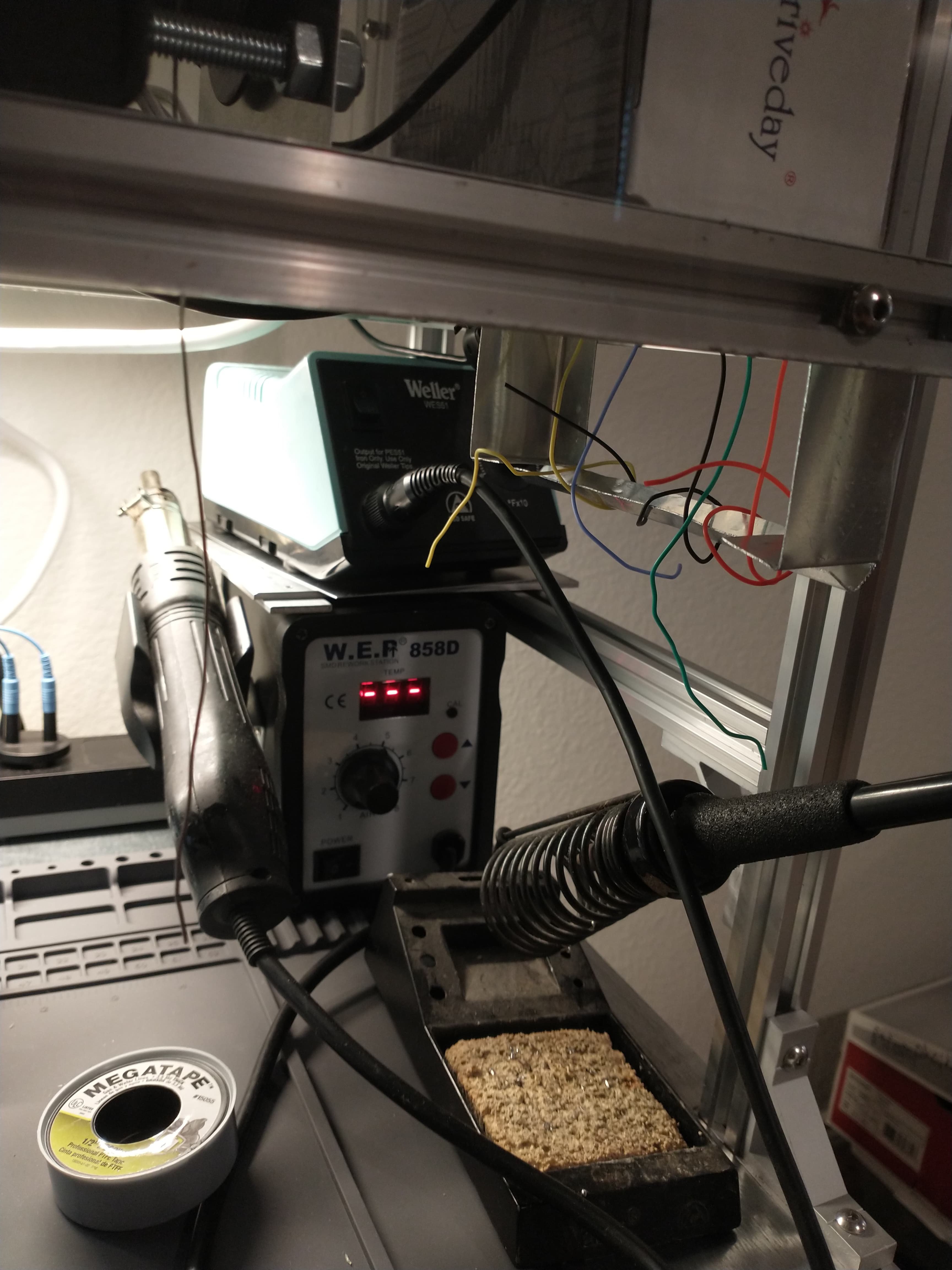

This is modular solder station. What improvements would you suggest?. The item contain one glass drawer one raspberry pi usb microscope. 2 solder pens, 2 hot air tools a drop for rosin solder wire.
wire rap and solder dispensor.
You should probably include a fume extractor and maybe an ionizer depending what type of work you plan on doing and where you expect to be doing it. Can’t tell if you include a wire to ground for a wristband, but that would also be good. Oh and if you want to go really crazy there are always some third hand alligator clips setups that can sometimes be helpful
