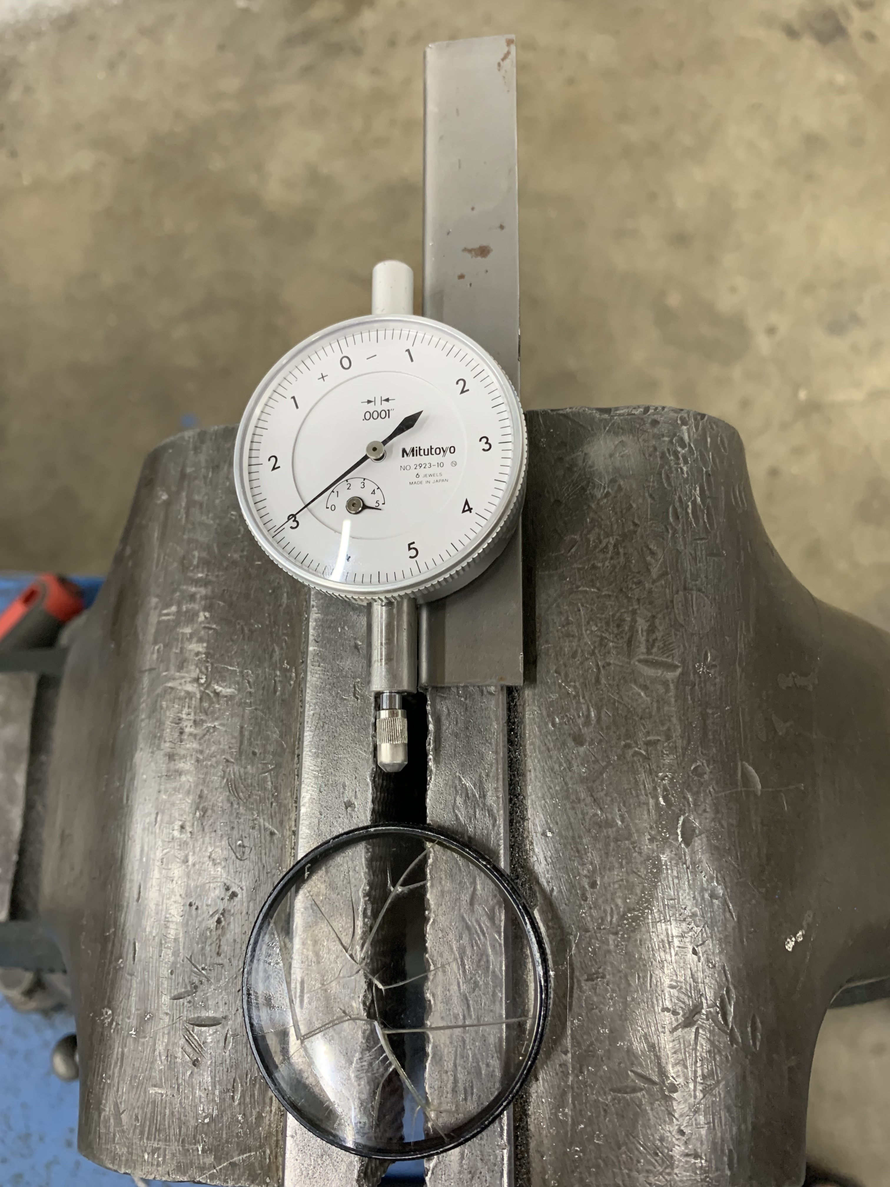

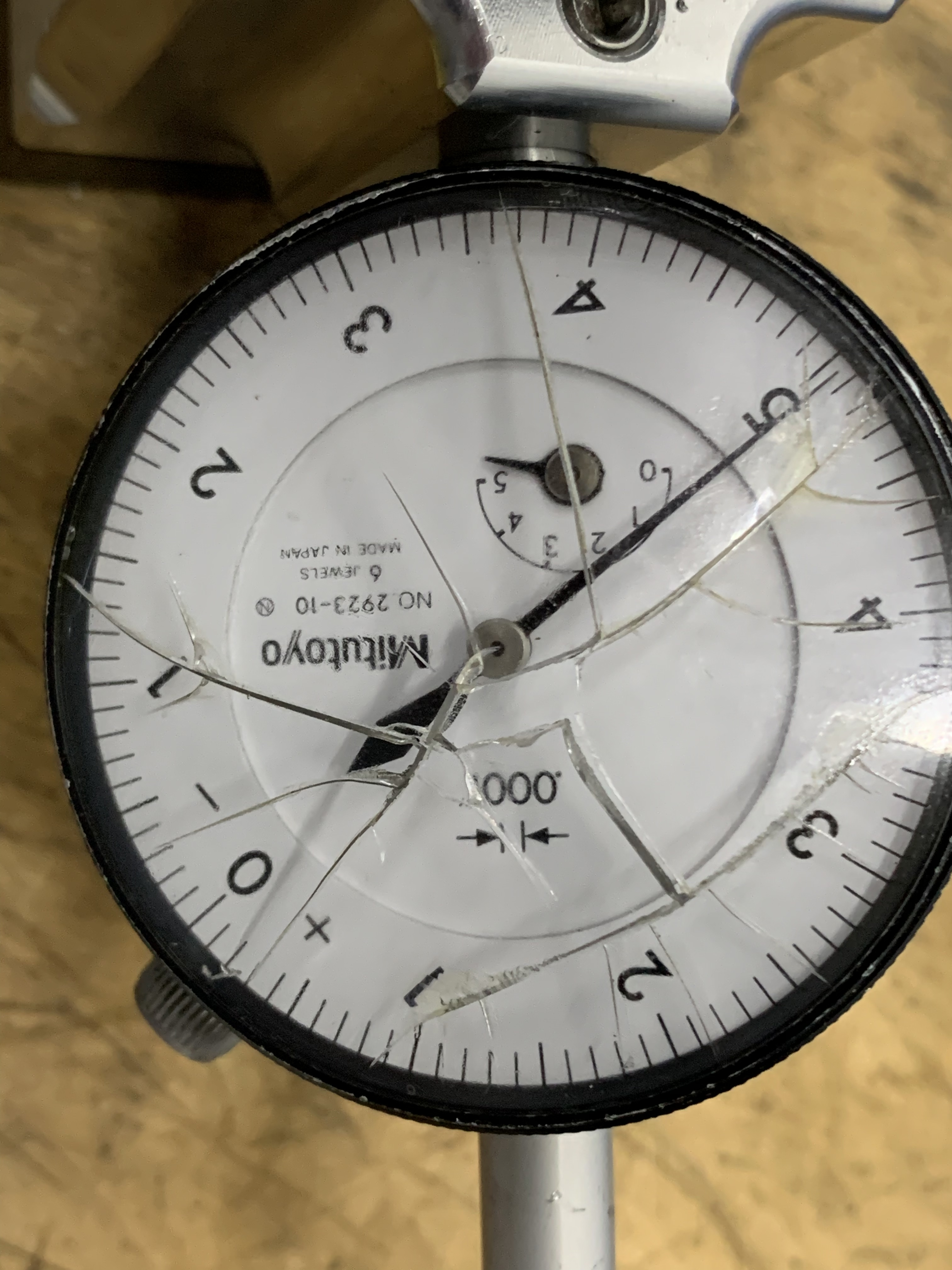

This was bugging me for a while….

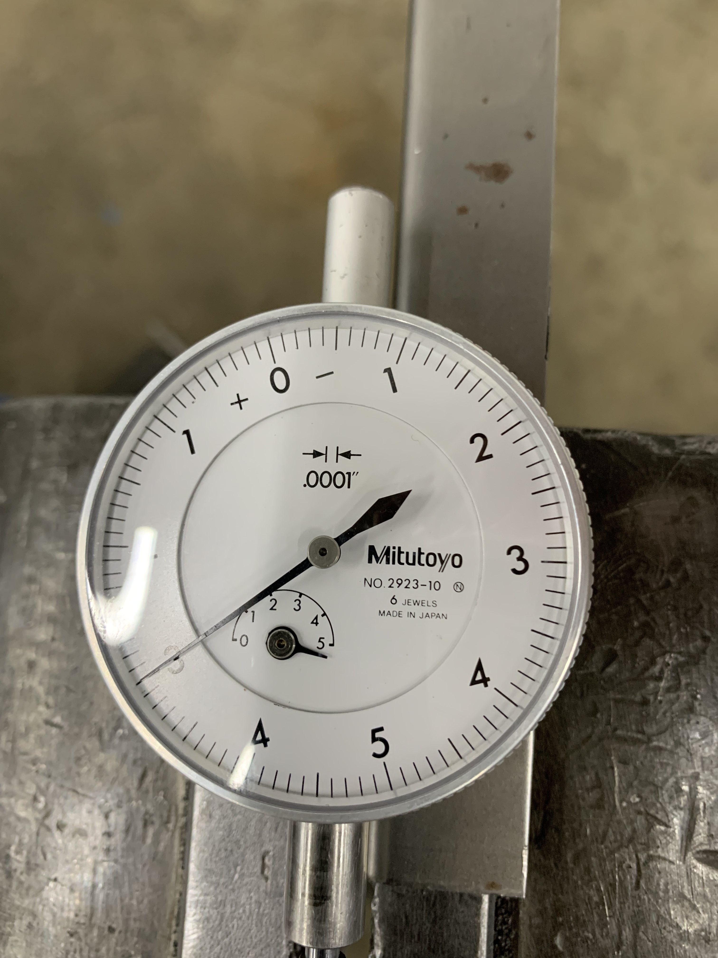

So I got on eBay and bought a replacement….eh about 2-3 weeks ago….excellent maker’s pace at job completion……

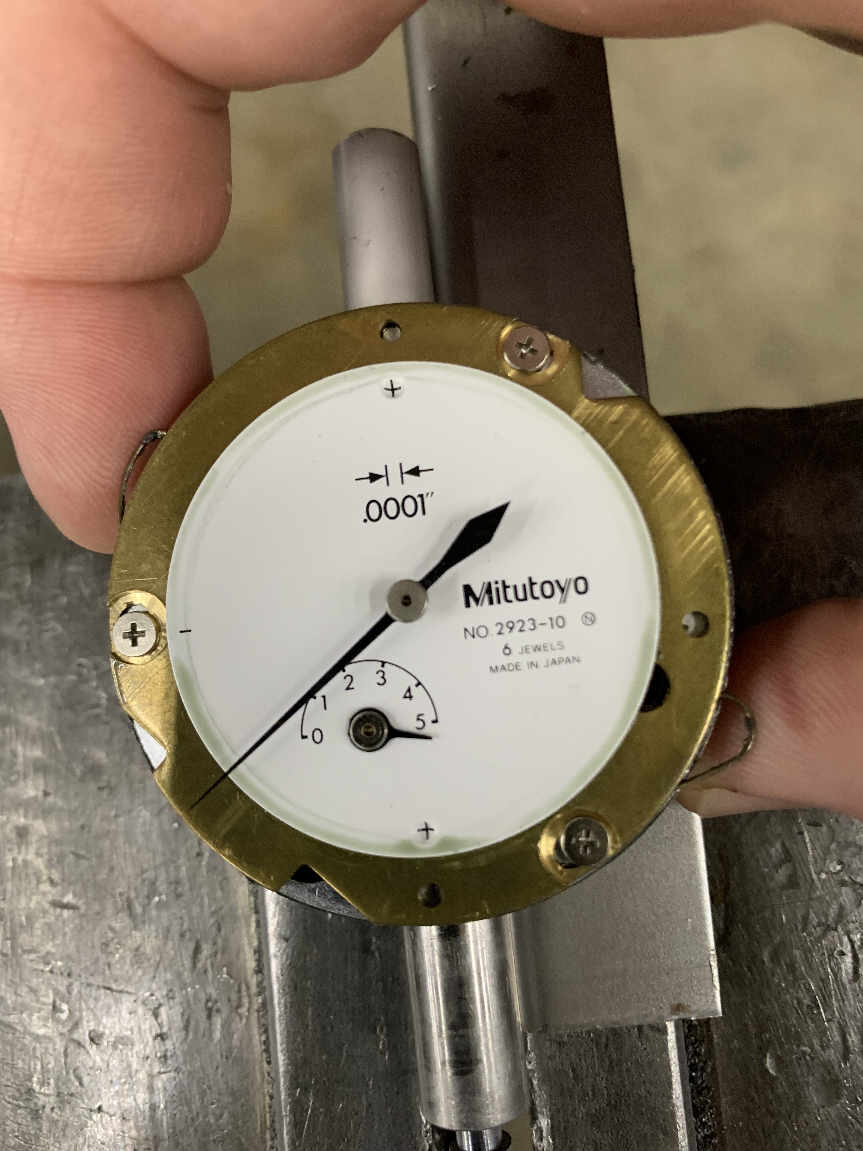

Popped the bezel….note the spring clips by my fingers for next time….screwdriver under the bezel to retain them while care is taken to NOT bend the needle….gentle pressure.
The rotating numbers part slides to the side and pop out.
