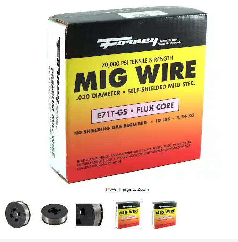

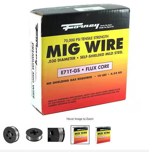

What wire are you using?
Flux core requires no gas, Solid wire requires shielding gas. The polarity is different for each too.
I believe this is the wire I am using or something of the like. .030 flux core
Your little 140 welder isn’t really made for 1/4 material in a single pass. It’ll probably do 3/16 at best. You will need to run a bead, brush off all of the slag, then run another on top until the gap is filled. Clean the material of paint,grease,rust, oil …ect really well.
