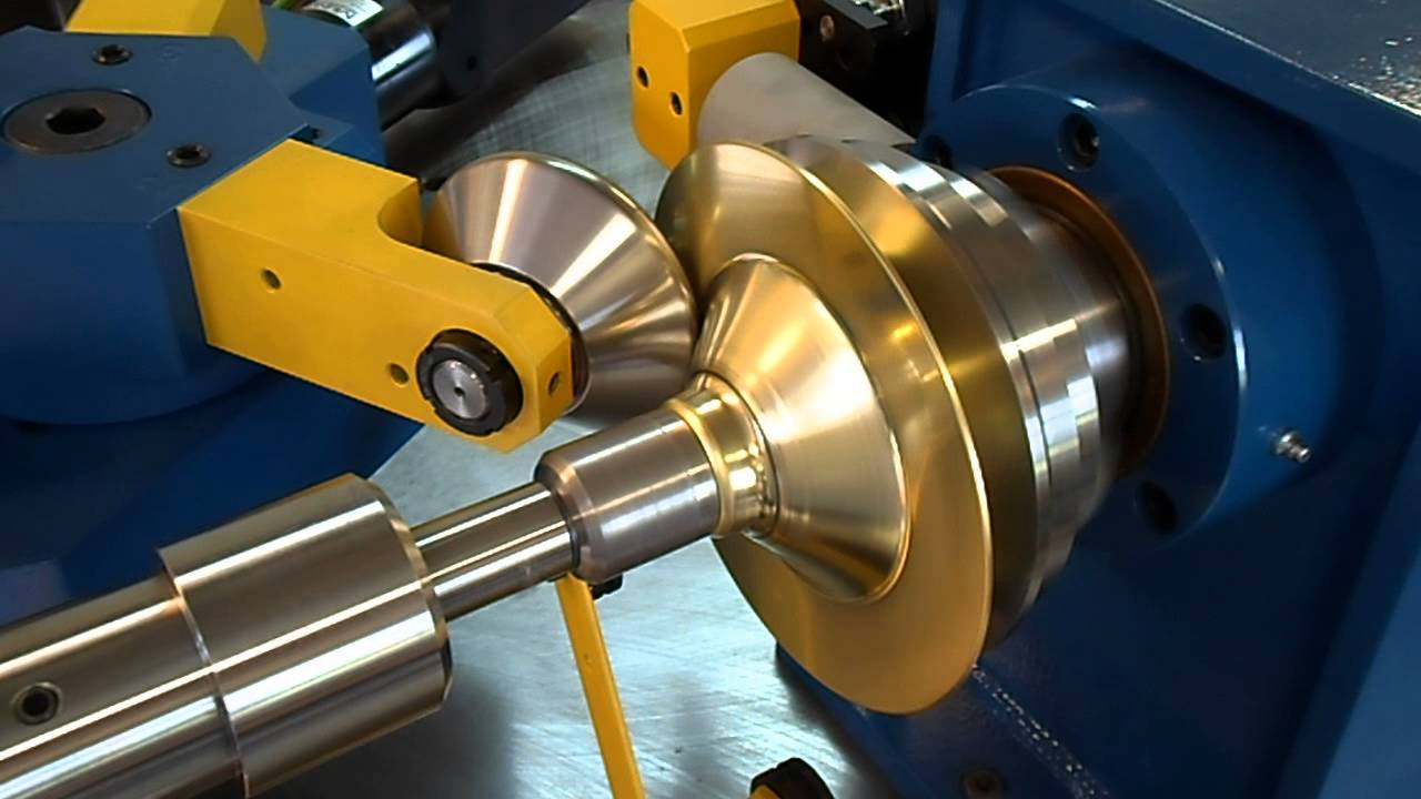

Here’s a CNC spinning setup:

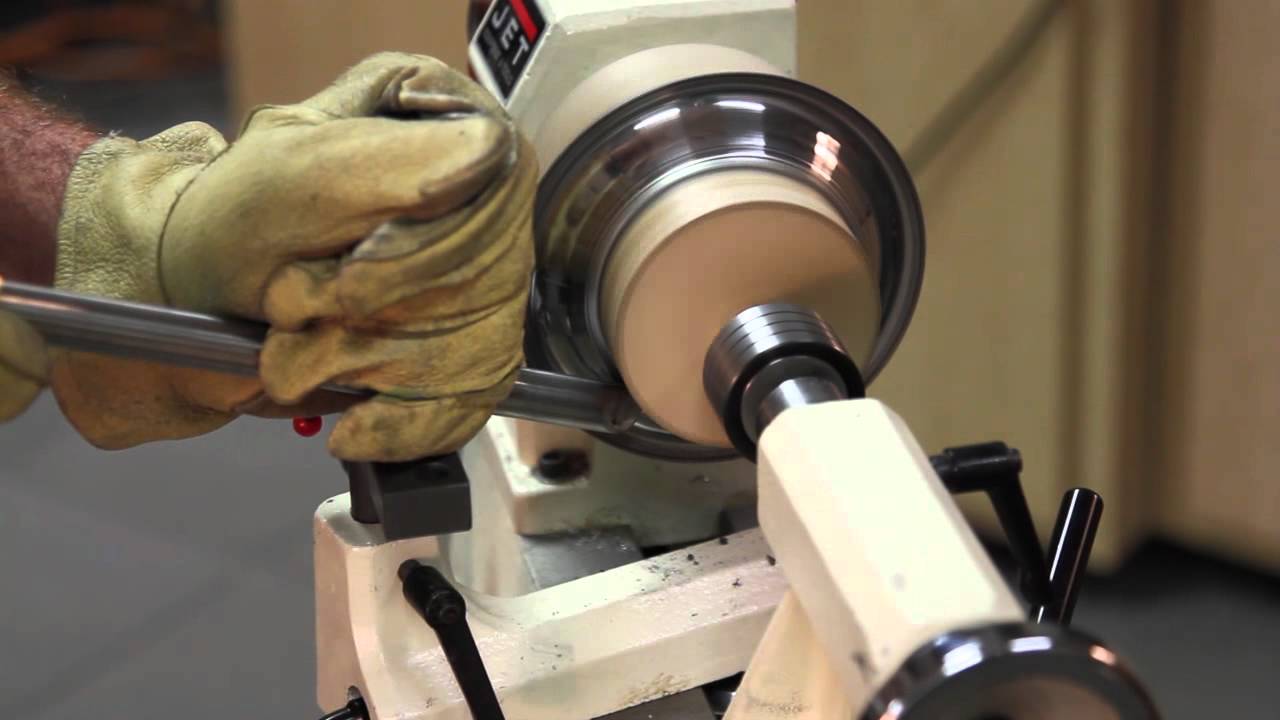

here’s a setup on (roughly) our wood lathes

The metal spinning I’ve seen done the chuck is more similar to the type that is used by the wood lathes to mount form to. On a standard metal lathe chuck and cross slide gets in the way. Those spinformers had tool rests like the one depicted where bars can be used for leverage. The slides are really used (except CNC spinformers).
If we were to do this in Machine Shop, I’d recommend getting a wood lathe that would take a large diameter, say 24" and setting it up for spin forming. They don’t need the power or torque that a cutting lathe needs if just doing pure aluminum, but if other metals, need more torque. Aluminum alloys and mild steel works well, we had some SS parts spin formed, work hardening was nasty (they were 60" in diameter when completed) it required stopping sending out for annealing about 4 or 5 times.

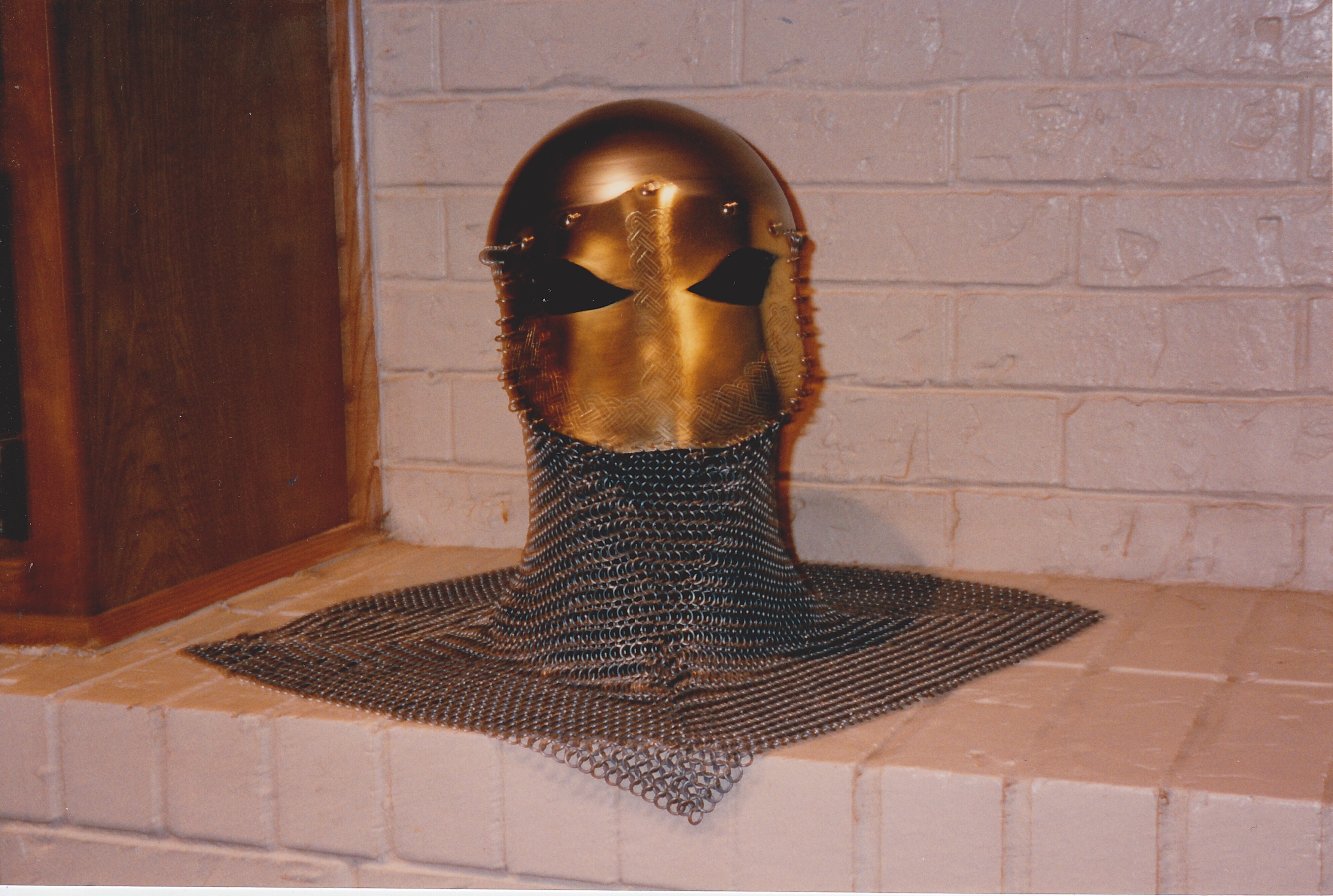

The top of my SCA helm was a spun piece and my elbow
cops and tmy shield co were from spun steel pieces
I think that his shows some of that
I did some metal spinning on a wood lathe when I was younger. always scared me with that sharp metal edge spinning. I demonstrated it a couple of time for the local woodturning club and for woodcraft. Sorby made the tools. eventually they dropped it.
