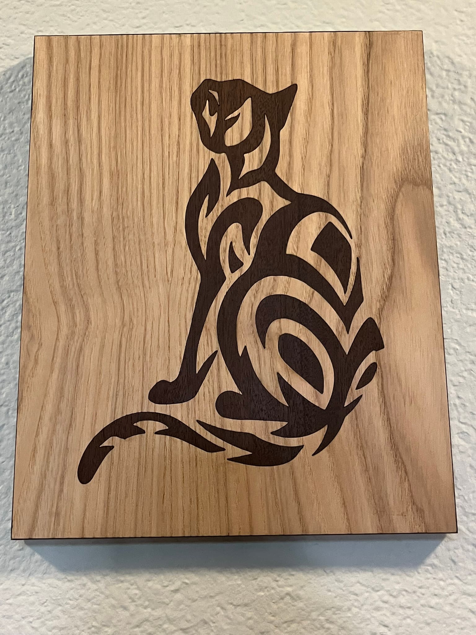

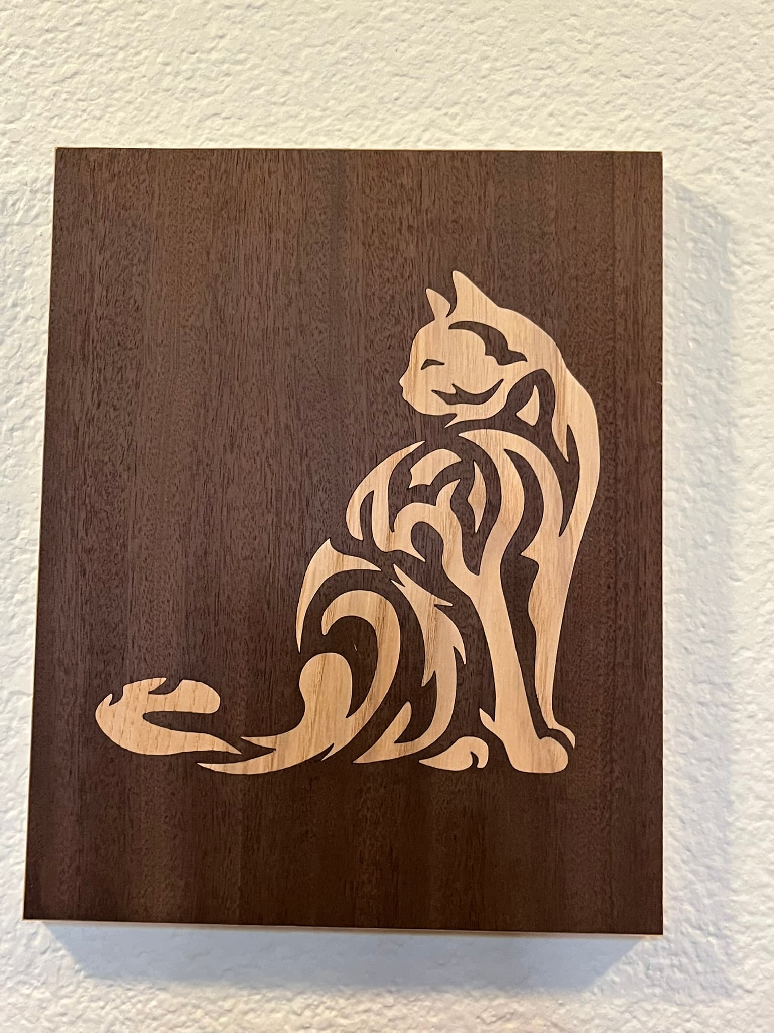

However, if you’re open to using the lasers with veneer, you can make something pretty nice if you’re willing to fuss with it and be diligent about perfection. (although technically, I think that, at least according to Nick Silva, this might be called intarsia). It’s all about cutting with as little power as possible, precisely measuring and adjusting for kerf, and doing multiple tests to get it perfect. And then of course lightly sanding it after assembly. (remember to use tabs on your tiny pieces so they don’t blow away!)
FWIW, these were made with some of the free donated veneer that @coloneldan brought over from Gulfstream.

Those are gorgeous! I took that class and still have the wood I was going to use, but I never got around to actually making anything. I may add that to my list…

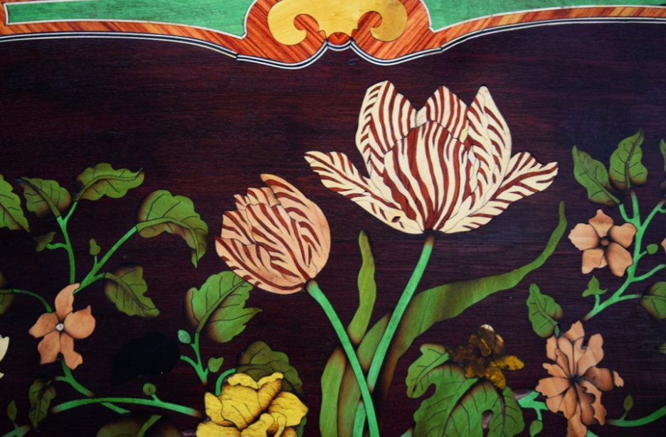

Alton Bowman in Flower Mound does amazing marquetry.
This is a top section of an table restoration he did years ago. He created a new top for this table to replace the leather imposter.

So John - are you in essence etching the board with the design so it is deep enough for the cut veneer to be glued in to the depression created?
You are using veneer for the outer design and the cutouts and cutting all the way through the veneer. I suppose you could etch … I haven’t tried that. It would be a fun experiment.
