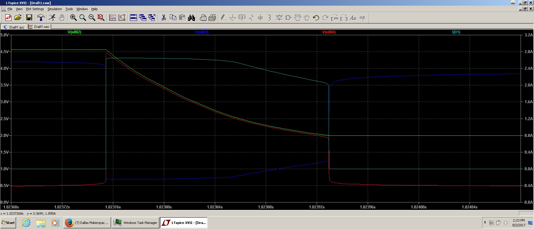

OK without to much rant and rave I managed to get the home ckt entered and simulated.
Ckt is here:https://dallasmakerspace.org/wiki/UsingLTSpicePart1
Here’s the schematic:
Ckt and simulation results
Simulation graph
Grn - C1 charge/discharge
Red - Q2 base
DrkBlu- Q1 base
LtBlu - current thru led1
Pgm allows you to zoom in on parts of graph.
