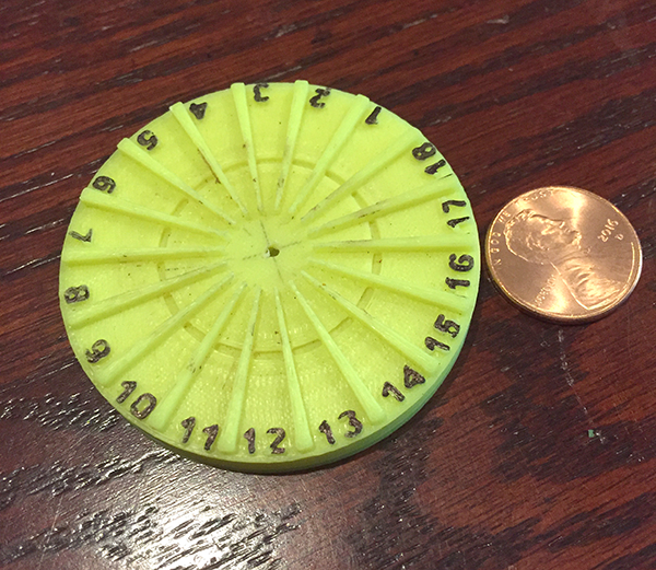

How small does your text need to be? I 3D printed raised text then just ran a Sharpie marker over it (obviously quickly - didn’t care about quality). This text is about 9pt text, I believe - so not tiny but also not huge.
This is a micro-lathe fixture, so pardon the fact that it’s a little grungy.
