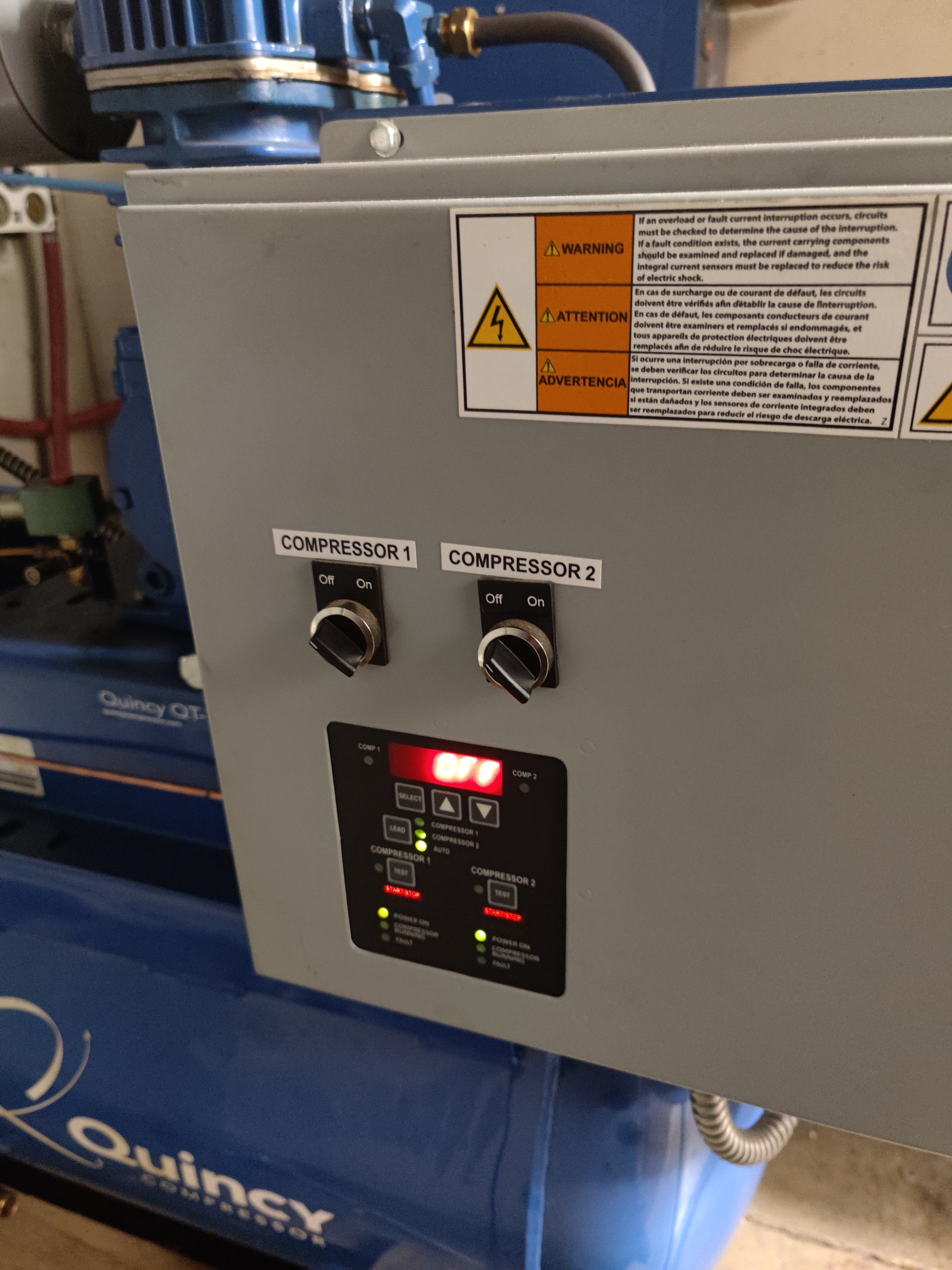

As I was leaving tonight I was turning off a few lights and I heard from the electric room the compressor running constantly and no one was using any equipment. I’m sure that it is not good for the compressor to be running like this. I am still at the space I can stay a little longer if anyone can tell me how to get into the electric room to turn it off.

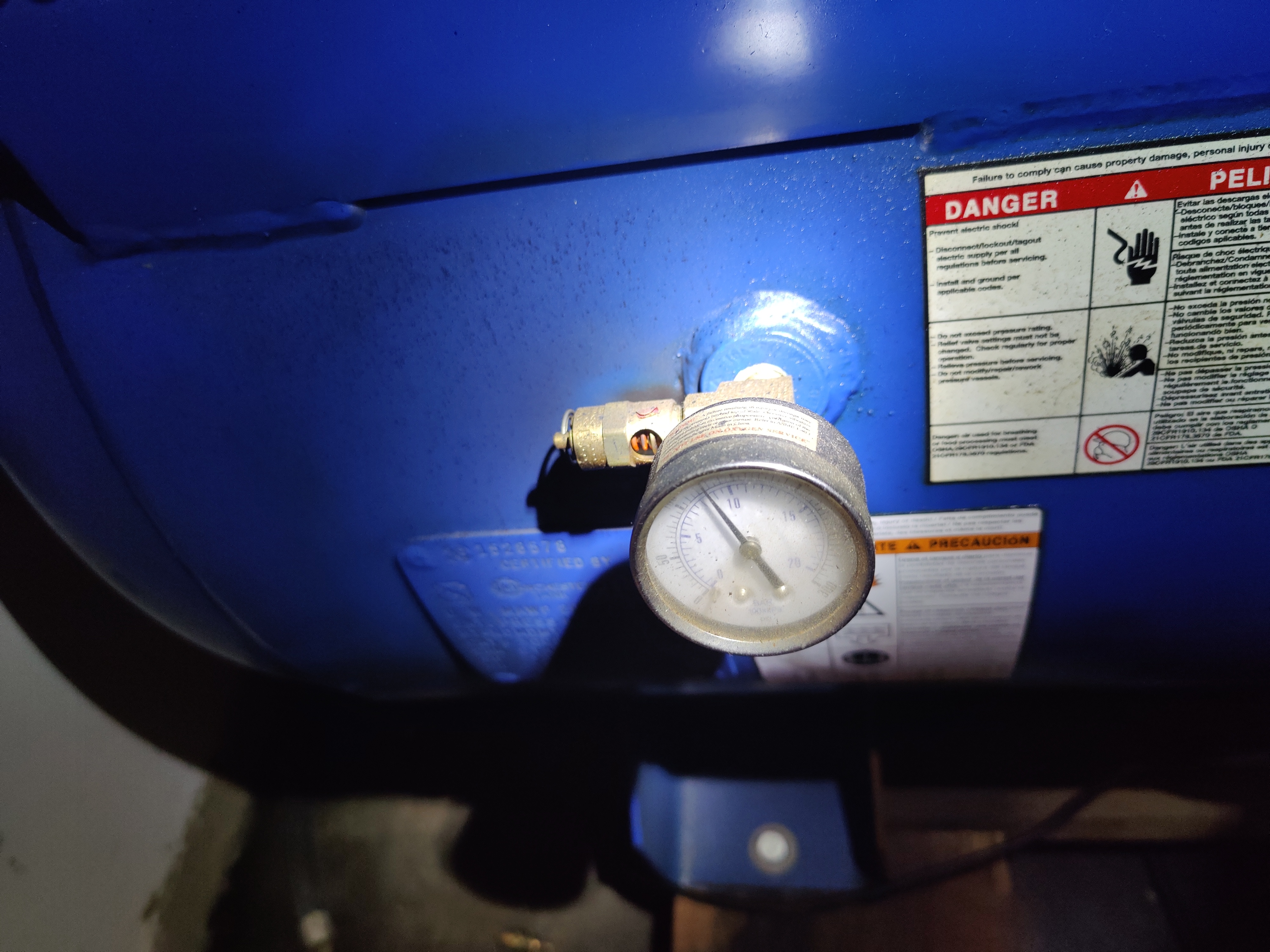

this was open and blowing air when I got in. 150 psi.
The control box didn’t work for turning off the compressors.

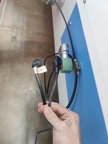

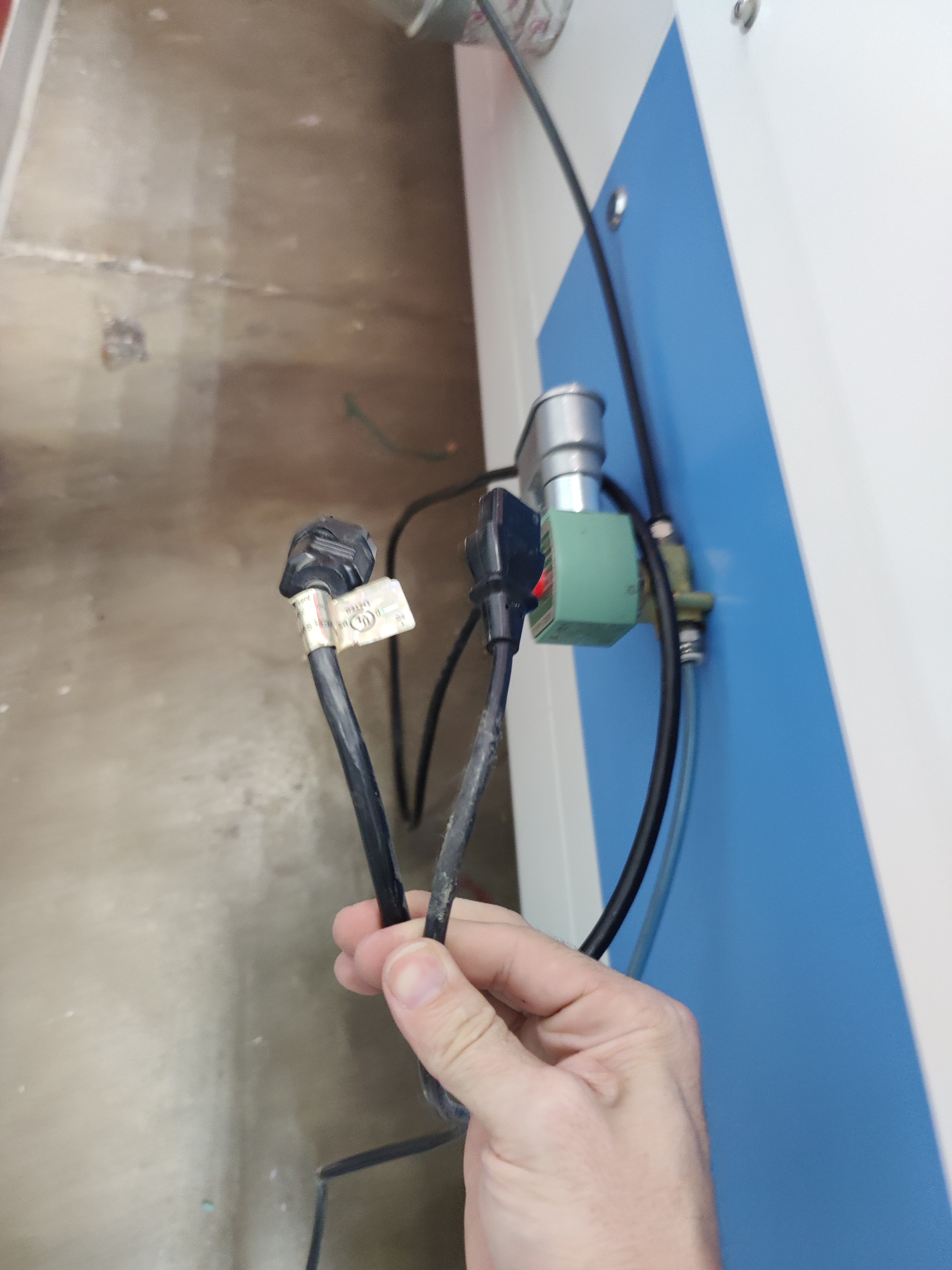

Big thunders air assist was on and no cut was running. I could only stop the flow by disconnecting the solenoid

I’ll take credit (blame) for the thunder. It’s air assist control broke at some point, so we’ve been running for a few days without air assist. That was why we’ve gone through two lenses since we reopened.
In an effort to keep the laser up I hot wired the air assist the stay on, reasoning that we had some leaks in the system and the laser wouldn’t be a significant load. Seems like I was wrong.
Big Thunder will need to be shut down until we can find the issue with the air assist control. It’s somewhere between the controller and relay as switching relays around inside the laser did not change anything.
I’m not sure that thunder’s air assist alone is the problem. Pearce indicating the blow out valve was purging the whole time indicates a different issue.

We have air but at half the capacity at the moment. The contactor for the second air compressor welded shut. Hence keeping the compressor running while it’s supposed to be off. Hence the pressure relief doing its job.
I will work on sourcing a new OEM contactor.
