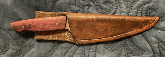

I sometimes make simple sheaths for forged knives I make. I like oiled leather for sheaths as it helps keep steel knives (non stainless) from rusting/tarnishing. Oil-tanned or oiled vegtan both work well. This is a vegtan sheath to which I added neatsfoot oil, lanolin, and beeswax.
Harness leather is another option: it is vegtan leather with oil, tallows, and wax added for durability and water resistance. Usually only available in heavier weights, so better for sheaths than rolls.

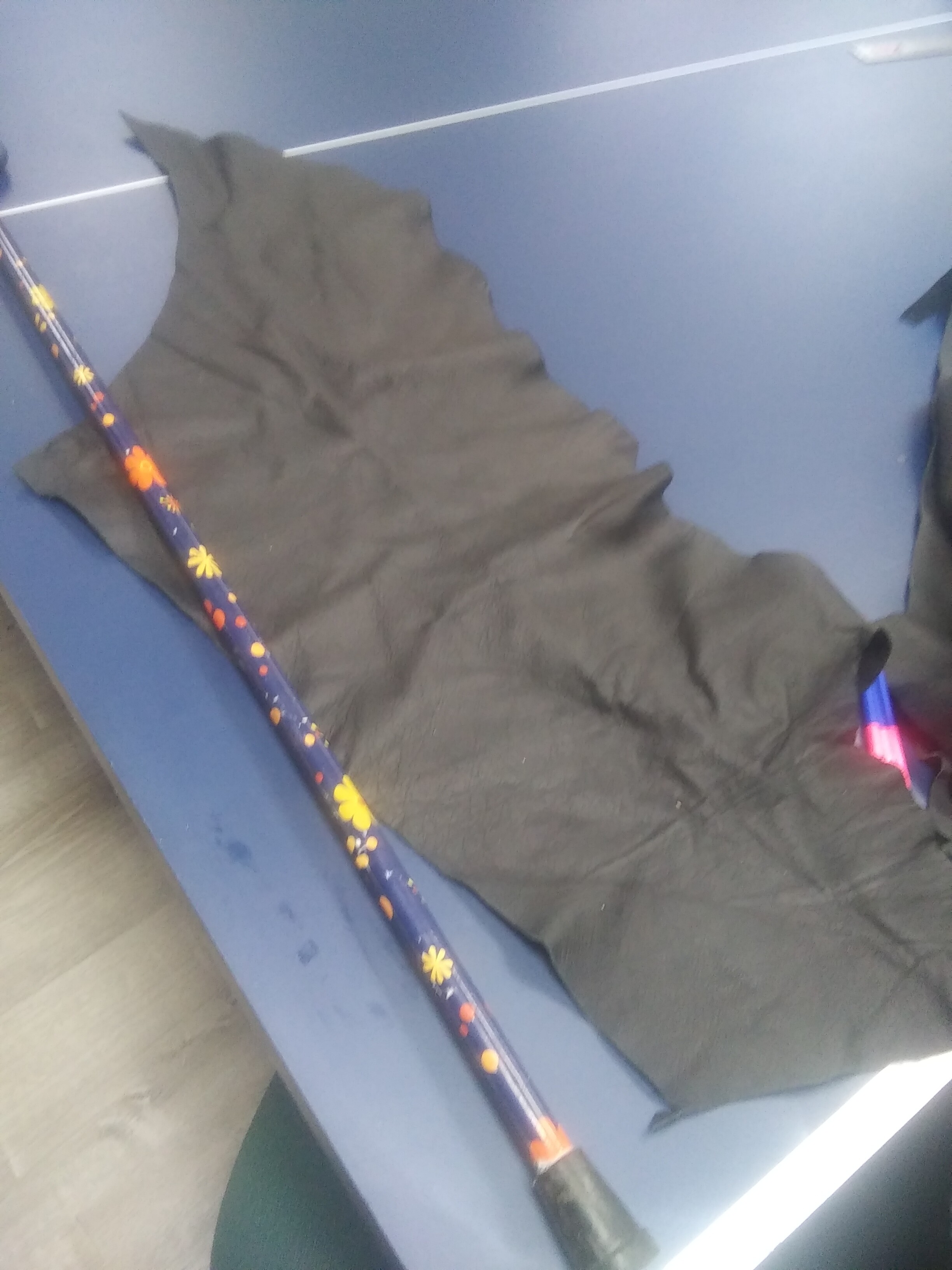

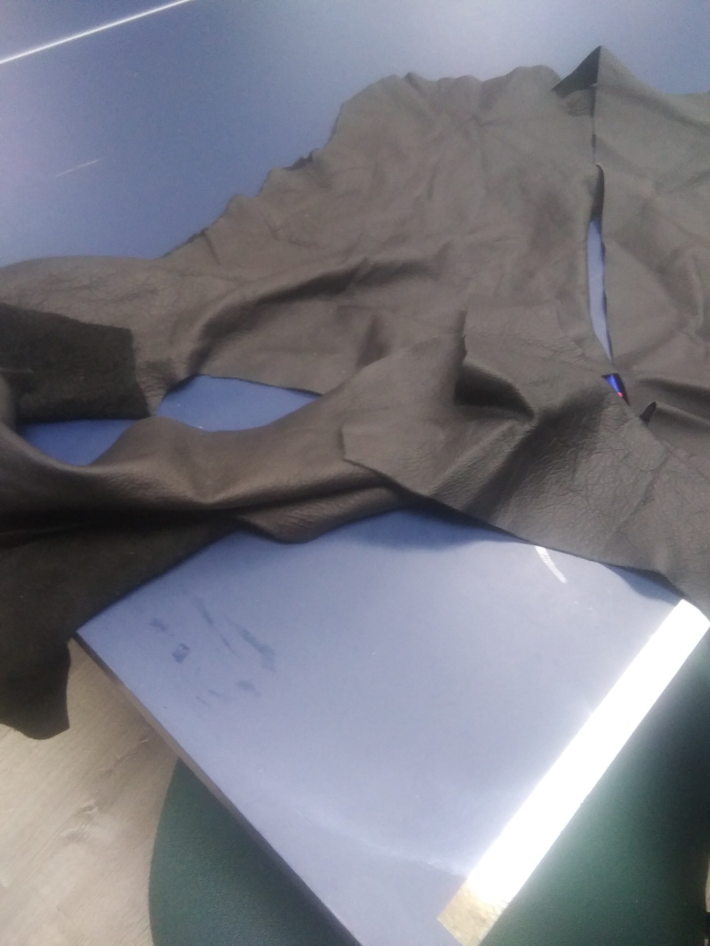

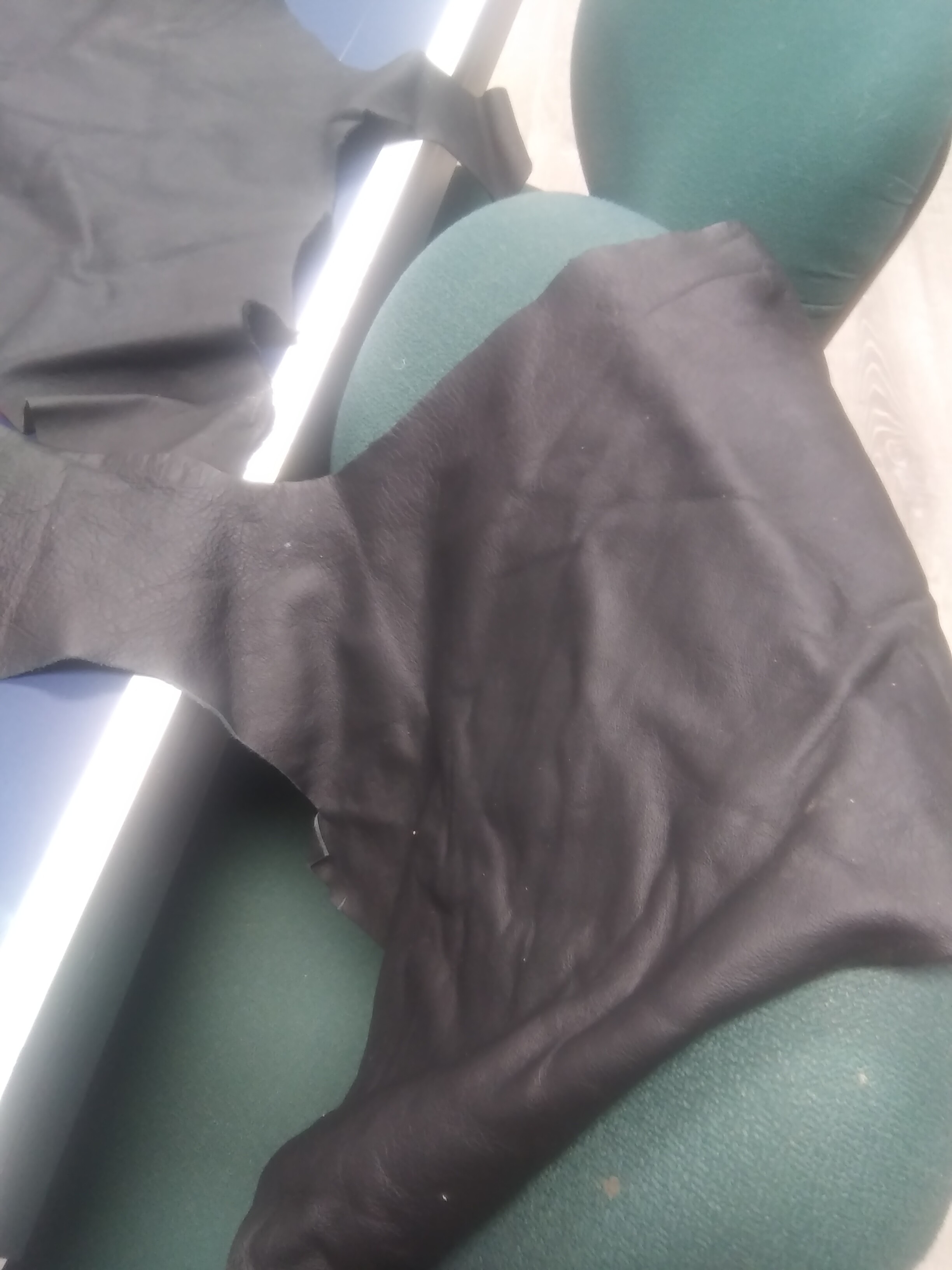

Since @HankCowdog has said that chrome-tanned hasn’t given him any issues, you may be able to purchase some lovely black from Creative Arts. And, you could probably rub that with some of the oil you normally use on the knives.

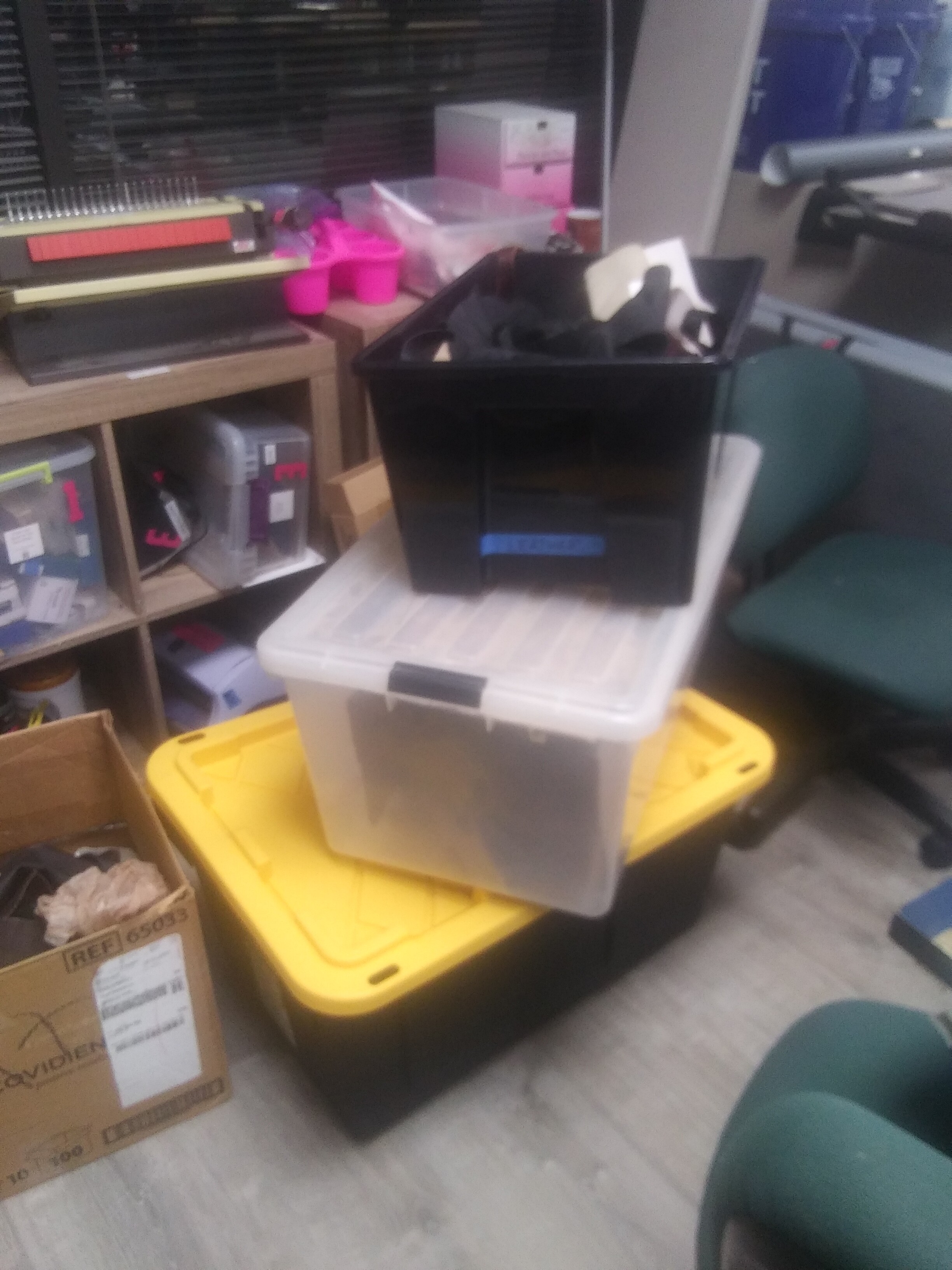

I’ll try to take a pic of what we’ve got when I get to the Space tonight. Although, you’ll probably still need Tandy for the rivets. Depending on where you live, the main Ft Worth store is also open. That may be it for the Metroplex, though. Capt’s had been going to the Allen store as they closed most of the rest of them, but from the Space, it’s not much further to the Ft Worth store, and they have Everything (everything that Tandy has, that is).
