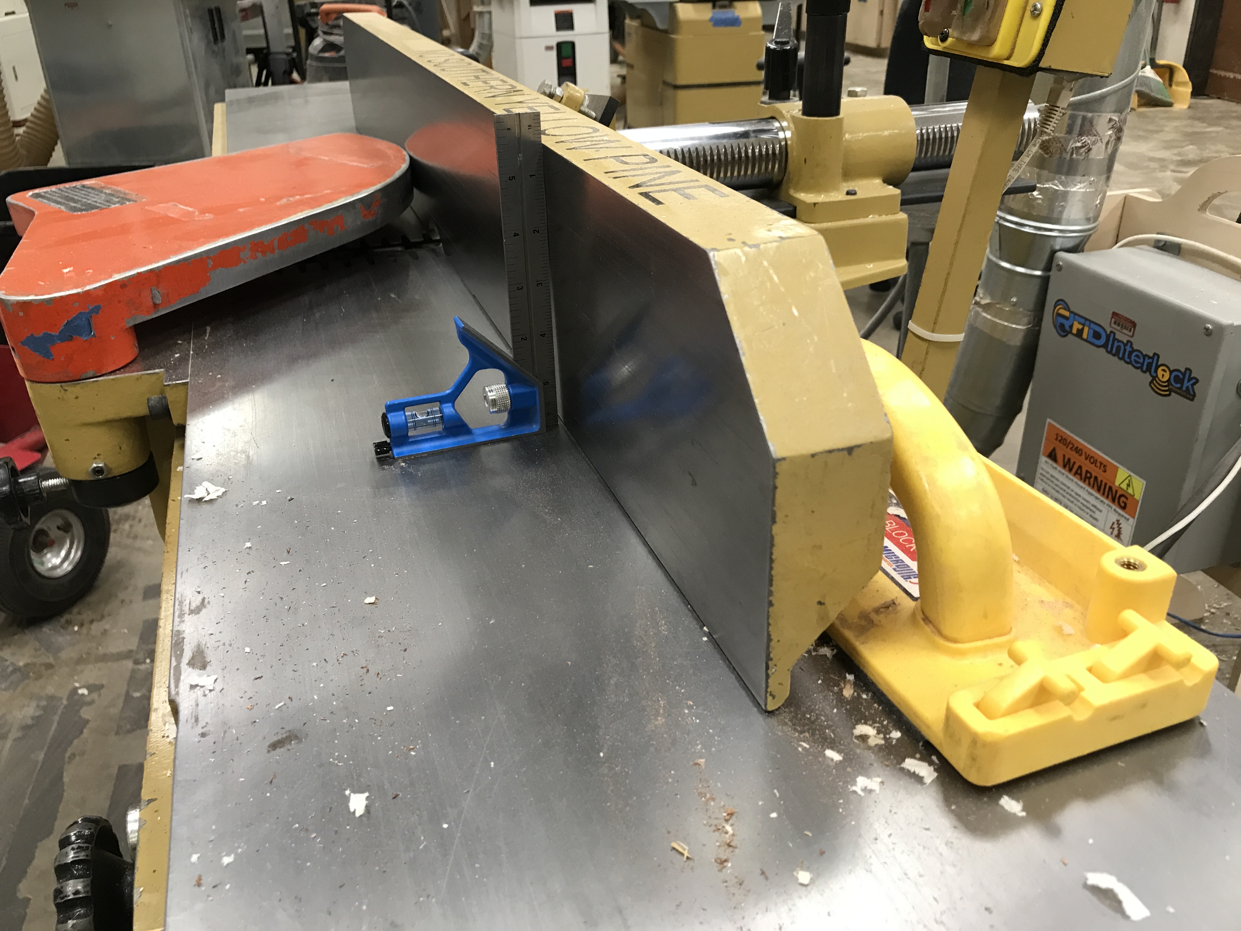

Not sure who wanted to use the less frequently used inserts, but it was a big fail.
Its easy to move the fence over, but must be a bit more difficult to square it.
Great reminder for members to always check the fence with your square or 1-2-3 block
This is how it should look prior to use. You know, kind of square.
oof. good call. reminds me that i need to keep my square with me.

On a machine as abused as ours isn’t it best to test your square on the outfeed versus infeed?
Ideally you would adjust the squareness of your measuring tool to meet the squareness of the machine, as the machine is always right you know.
/s
Nobody touch the ourdeed table, nobody talk about how the out feed table can be adjusted, nobody suggest the out feed table be adjusted! Please for the love of all that is perpendicular please only adjust the fence is you need to rarely and the in feed table other than that the jointer has no other adjustable areas
I’m not advising to make an adjustment to teh outfeed table. I’m suggesting when you are squaring the fence to the table, you should measure it against the outfeed, as that is where your board will end up needing to be square. If there is a half a degree difference in squareness between the fence to the infeed and outfeed, I want my 90 degree square on the outfeed table.

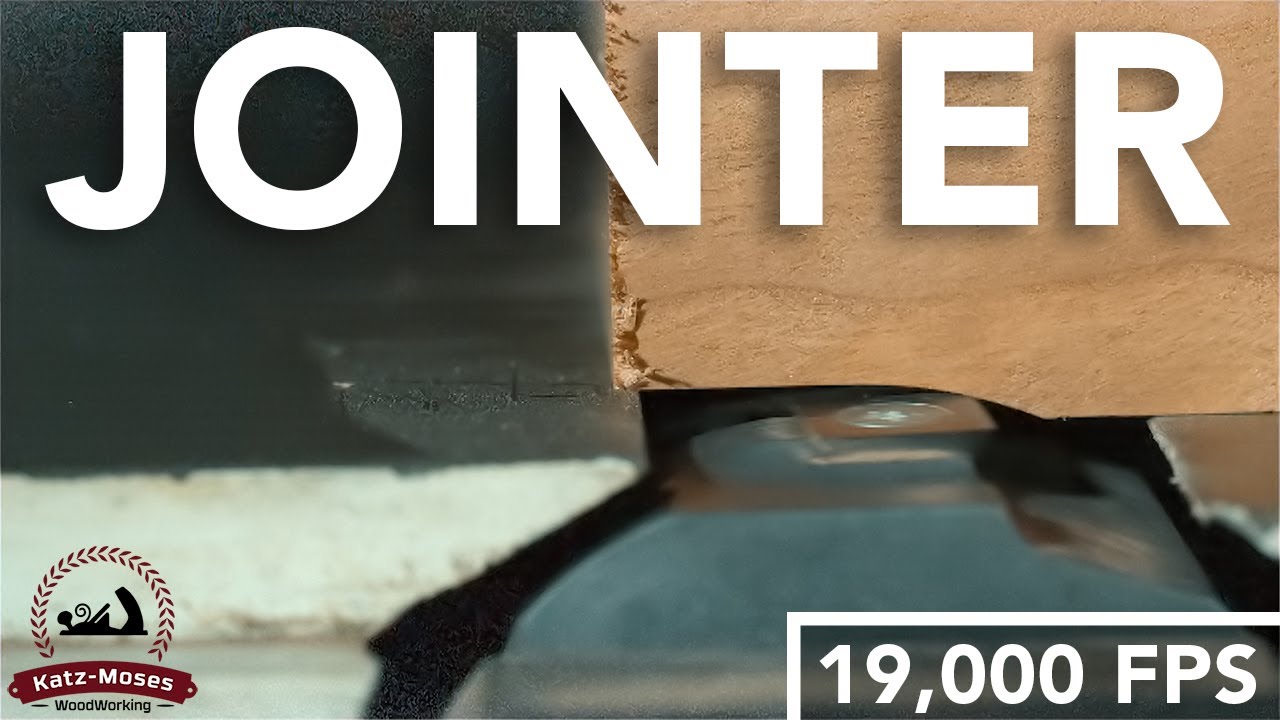

And YouTube’s take on the subject. The high speed camera is great.
