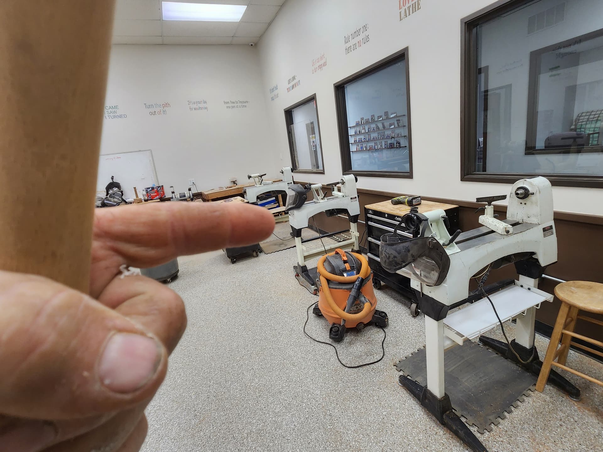

The 2nd jet lathe quit working during class tonight. I swapped for the spare and put a red cone on it. I believe there is a short in the switch. It would turn on forca second or 2 a turn off.

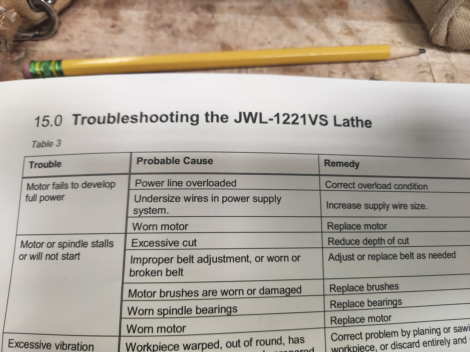

Voltage at wall was checked as per troubleshooting in the attached. I think we may have a bad motor.
