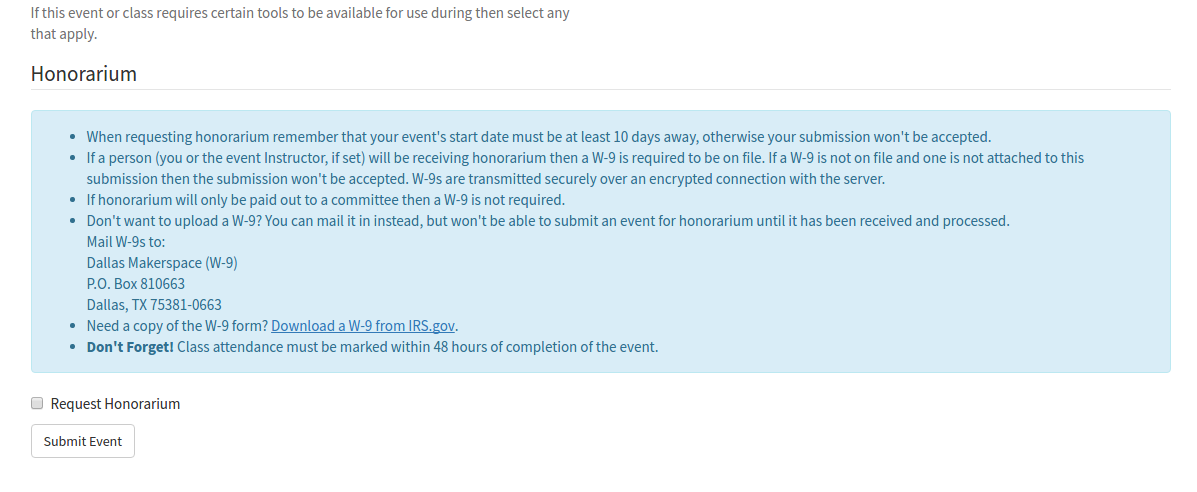

The IRS has a on line form use it and submit it
You will then need to print out a copy I did that at the space
there might even be some extra coppines on the printer, then physically submit that

IRS form: https://www.irs.gov/pub/irs-pdf/fw9.pdf
(mostly a summary)
W9s only need be submitted one time (not necessary with every class, if it’s on file, it’s on file).
The info (where to get, where to submit if in hard-copy) is available at the class submission page:
Everything is fillable except the signature, so you can fill and print, but if you use Adobe Reader X or newer and have a scan of your signature, you can add it and do this all electronically.
Correct. In the box, in an envelope marked W-9 with your name. You can also mail them to out PO box that is used just for W-9’s.
