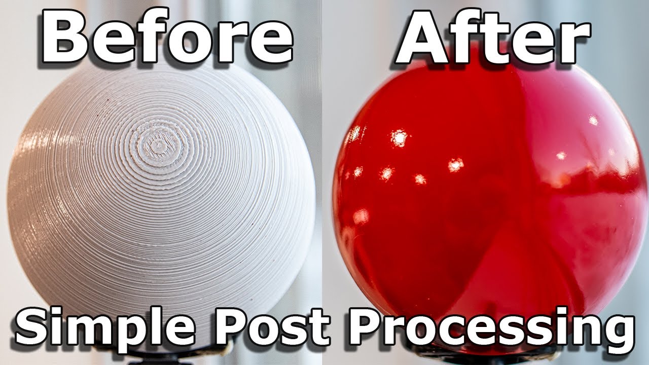

Tony, I’ve found that the best way to finish an FDM print where you care about the surface look is to (1) first sand the heavy layer lines, (2) use a spot putty like Bondo to fill in the largest gaps, (3) sand, (4) then spray a filler primer, sand, repeat until satisfied. Rustoleum filler primer is the cheapest decent spray I’ve found, but I think Duplicolor works so much better (at almost twice the price and half the availability locally, unfortunately). Depending on your patience, this should get you something that does not look at all like it was 3D printed.

This is a good video that further elaborates on the process that @SteveF has described.
