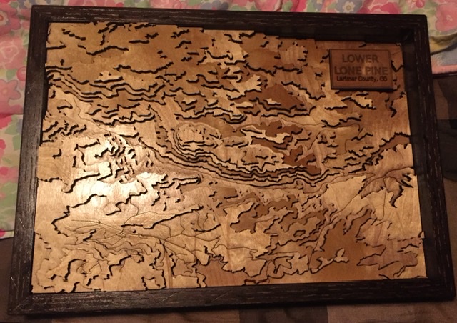

I used this approach to darken the oak frame of this 3D laser map I made a few years back:

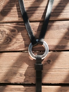

Similarly, this leather was blackened with vinegaroon (the same stuff):
No other dye or stain was used in either case.
