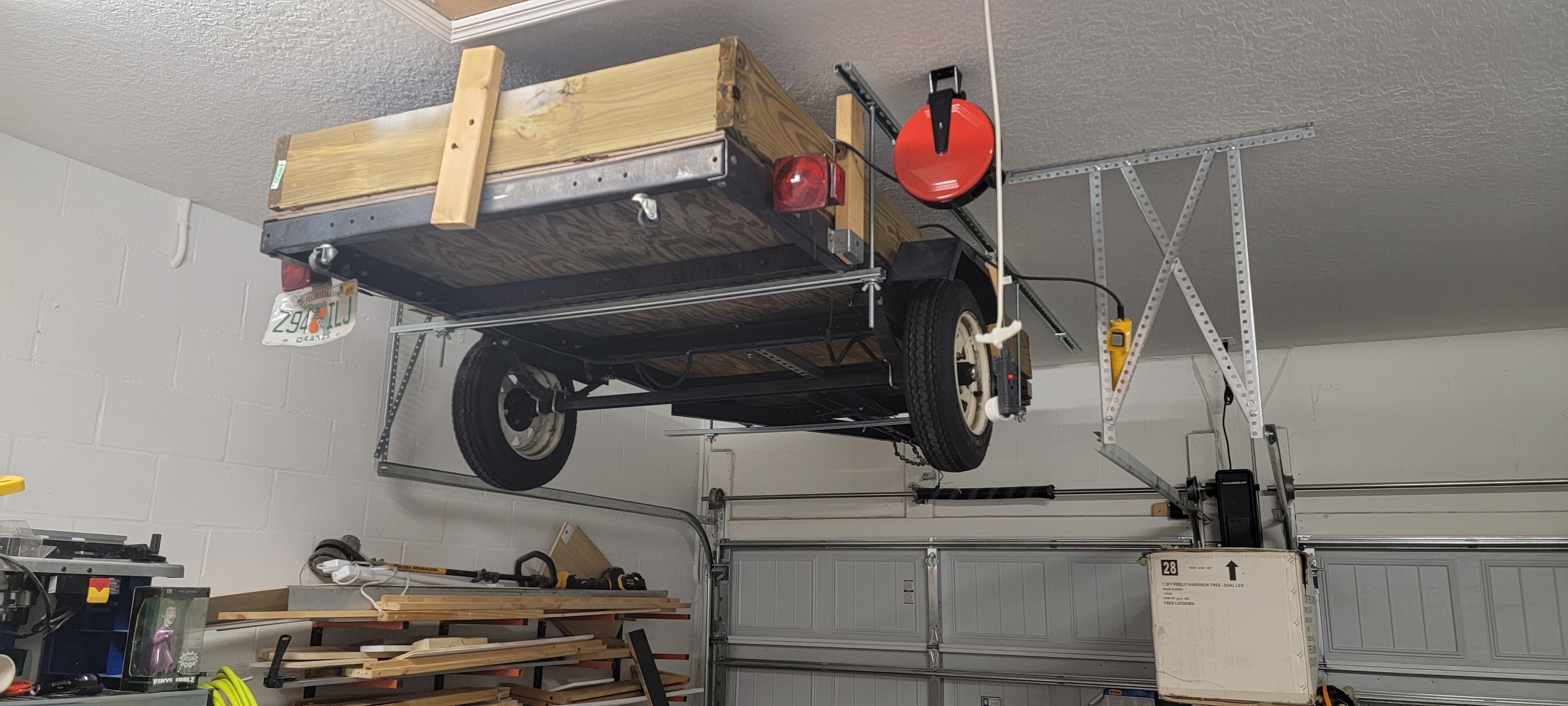

I attached some unistrut to my garage ceiling to keep stuff off the floor.
Until you decide on a fancy way, many small shops just stand it on the short edge, against the wall, almost vertically. It isn’t much fun digging out the back sheet, but it minimizes warpage.
that’s cool but how do you get it up/down?
Pretty sure there is an electric hoist … controller is the yellow box in the garage door rail supports.
