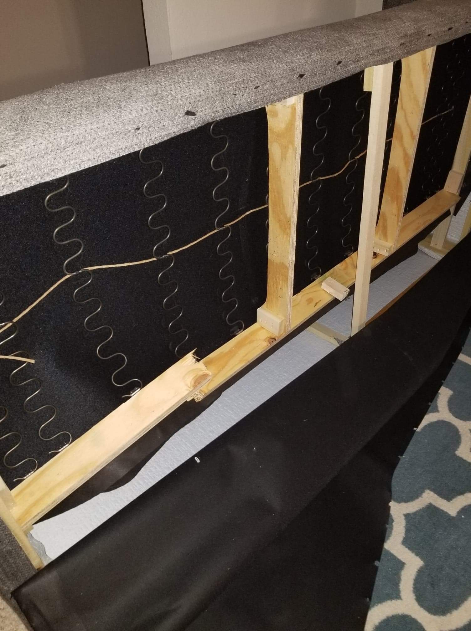

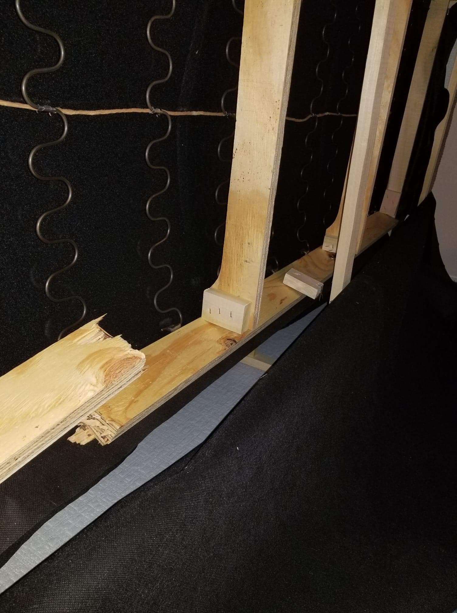

Hi y’all, I’m not sure if this is the correct community to ask, but our couch broke yesterday. One of the support beams completely snapped apart which pulled apart some of the other connections. I have attached photos. Is this something that my partner and I could repair at home? His dad suggested holding the main support beam together with another piece of wood on the front and one on the back. Any advice is greatly appreciated.
That’s the right idea. Easy enough to glue a splint on. Looks to be about the width of a 2x4. Just cut to length, use wood glue on both the original pieces and the 2x4. Clamp together for ~4+ hours. In 24 hours, better than new.
Home depot and Lowe’s both should* have miter boxes and hand saws to cut the 2x4 to the length you need. You should use that 2x4 to reinforce the other sections on the back.
Is the fabric attached on the back of the broken piece? If not, run the 2x4 across the entire back board. Use a lot of clamps or screws to hold in place as glue dries.
If fabric is attached to the back, attach the splint from the inside.

Thank you so much! I greatly appreciate. I’ll message you if we get stuck. Thanks again!
