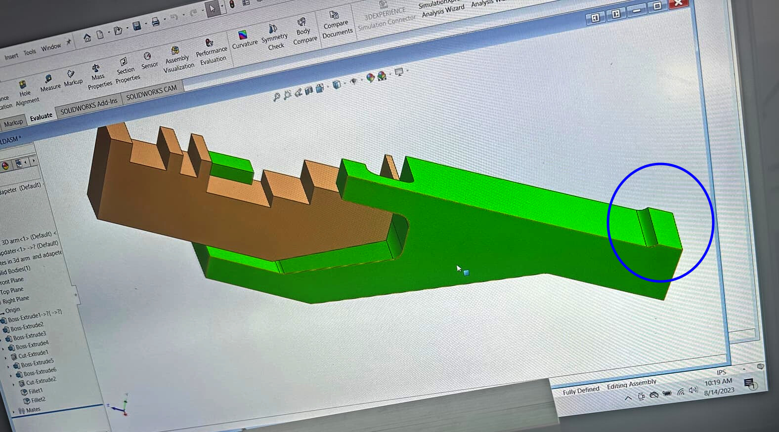

So I have design an adapter to held my big spool on the 3d printer. I am wanting to learn new things. The design is by no means set in stone( or aluminum) I want to make the green part and use the aluminum block as shown.

How important is this feature?
I just need so keep of dip at the end to keep that spool on
Do you have a holding strategy for machining that part? In what order are you going to machine the faces so you can hold it while you’re machining it?
