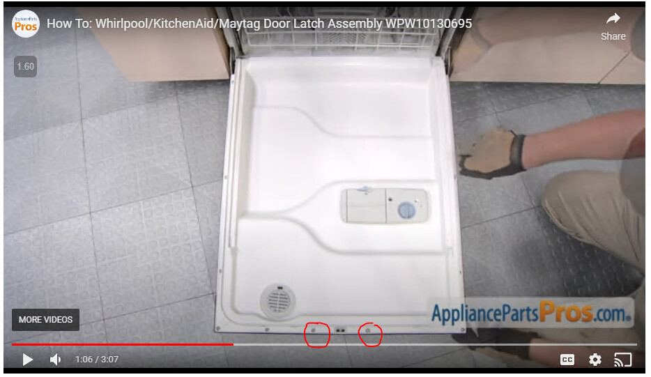

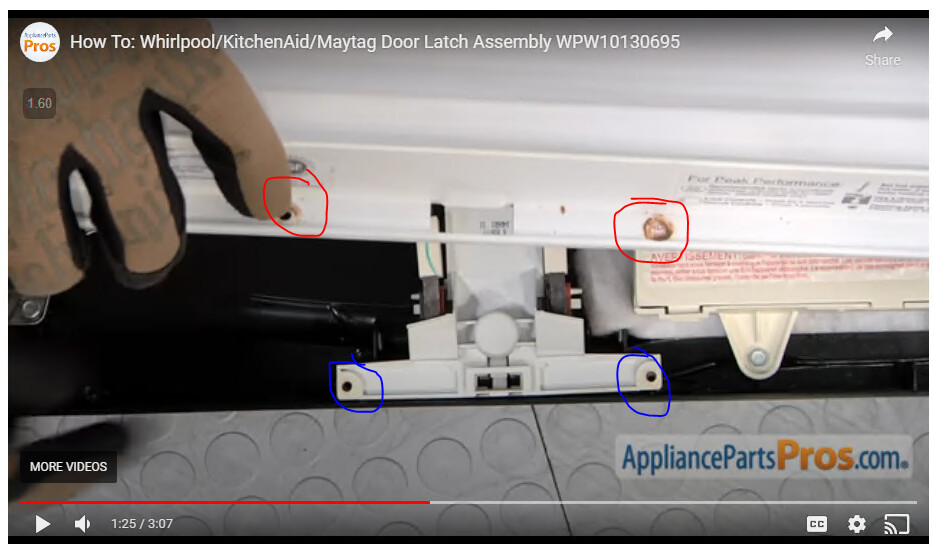

Assuming you mean the 2 screw holes circled in blue below
they use the same screws as the 2 holes circled in red, which go OUTSIDE on the cover panel:
I’ll see if they fit…thanks.
