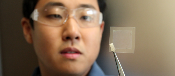

A small furnace (~$500) and some nickel foil (~$150) is all that is needed to create graphene… Well that and a little experimentation to determine the best temperature and cooling profiles…
Now that you could make it, you just need to decide what to do with the stuff…
