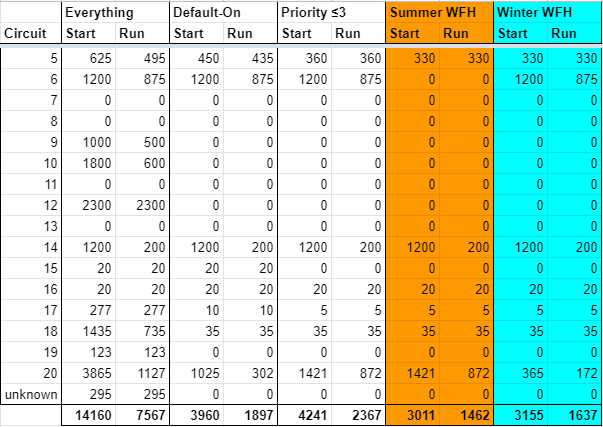

Finally dialed in my minimal WFH needs and it looks like I could nearly live within the envelope of a ~2000W starting / ~1600W running generator if I had to:
The real key was separating out the nonsense situation of running the window unit AC and the furnace simultaneously. Also, the sum of starting loads is deceptive since circuits will be enabled sequentially.

Eh, this was for estimation purposes and it was a tedious manual process. It was a combination of using the maximum value on appliance (individual loads i.e. lights, computer, furnace) labels, making generous estimates for appliances with no label, associating each appliance with a circuit, then dicing and slicing each appliance based on categories (priority/default status, seasonality, etc). I hope that I was overly generous on the estimates and that the actual load ends up being a tad less - some overhead on running watts is a good thing.
