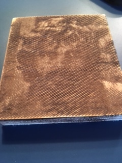

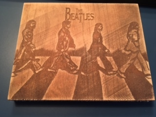

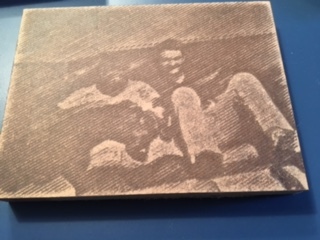

I’ve attached photos of the finished versions of three carvings I attempted. Of these three, only the Abbey Road carving had a recognizable image at all before I stained it. The photo of my son, his girlfriend, and our dog looked like a blank piece of wood (actually, it was melamine-coated particleboard), because the carving was so shallow. The third piece (does anyone recognize this image?) was completely unrecognizable.
