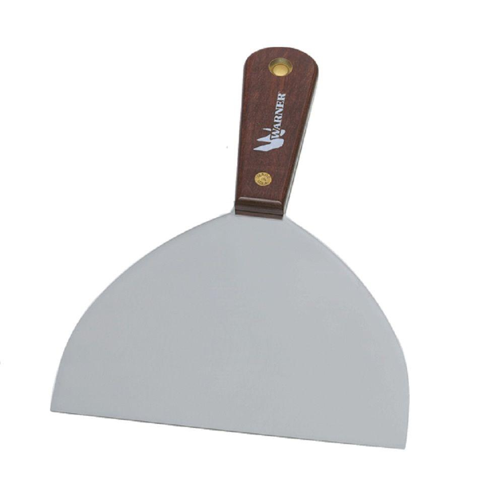

I am also having a brain fart. What is the trowel called that is used to smooth spackling on drywall?

I would be willing to buy some from you. You could drop it off when you drop the shelves off. What is the putty knife called? If I do this job it will have to be with the door in place. While I am finding I am more able than I thought when I have tools, there are still limits to what I can do. I must be realistic.

I’d apply it with a broad putty knife to help keep it flat relative to the undamaged door surface and minimize the sanding needed.
