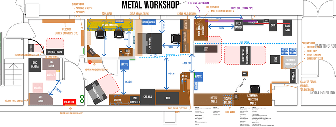

I’m from Stockholm Makerspace, in Sweden and we are right now renovating our metal workshop.
We have been considering getting an English Wheel, but we are a bit unclear on how much usage it would actually see.
We don’t have a ton of space (around 50m2 total in our 375m2 makerspace), so we want to make sure we get tools that will actually be used.
I saw that you have an english wheel in your workshop, and I was curious to see if you would like to share your experience with it?
For example:
  • How often is it used compared to other machines?
  • Can any beginner maker easily learn how to use it with just some youtube advice, or does it require significant instruction?
  • Does it fare well in a workshop that is not always perfectly clean?
  • Do you think it was a worthwhile thing to get in general?
  • Any examples of things people have made with it?
Attached our work-in-progress plan of the metal workshop, for any curious people :).
Really thankful for any advice :slight_smile:
@Mrholthaus is likely in the best position to comment as to specifics of the acquisition of our English wheel, it’s general usage, and some projects or makes that have been done with it.
Speaking more generally, we’ve always tried to let the active and vocal users of a particular area (we call them “committees”, for some reason) guide what tools ultimately end up being acquired (or, on rare occasion, disposed of). These decisions are usually discussed in regularly scheduled and publicly announce committee meetings that are overseen by an (periodically) elected chairperson, and guided by typical constraints of floor space and costs, including opportunity cost.
And any large purchase usually, in fact virtually always, requires approval by our board of directors, who have ultimate financial responsibility for the organization.
So I’d suggest a similar approach for your metal shop area users. Questions should be posed like:
– “Is this floor space better used for some other purpose?”;
– “Where are the funds coming from for this tool and what will we not be able to purchase or do as a result?” (I assume it is not a donation?);
– “How many here have a specific need/project in the near term that this tool could be used for?”;
– “Who will volunteer to be responsible to manage the acquisition, install/set-up, maintenance, and teaching/instruction for it?” (assuming that volunteer considerations apply in your organization? e.g. No employees responsible for these activities?)
That’s a good-looking metal shop vision/plan. Best of luck :–)

Looks like it will be a bad fit for our metal workshop in that case.
Hey! Great to see you remember us!
We are planning on getting one of those combination shear/brake/roller machines in the center of the room. Sadly, due to some limitations of this particular workshop (it’s in a wartime shelter, so there are rules that it needs to be possible to empty in 48 hours without too much specialized equipment), it’s hard for us to get the really big machines.
The one we are looking at right now will be able to bend 760mm wide sheets up to 1mm in thickness (mild steel). That’s gauge 19 if I read the tables correctly. Would love to get a beefier one, but they all seem to be too big or too heavy.
I would guess that most sheet metal bending is done with relatively thin (<=1mm) metal anyway? Or would you disagree? Personally, I’ve never done sheet metal work before.
We are also planning on getting an ArcDroid CNC plasma for our welding room. An iron worker machine hasn’t been in any plans, though. Never quite considered it before.

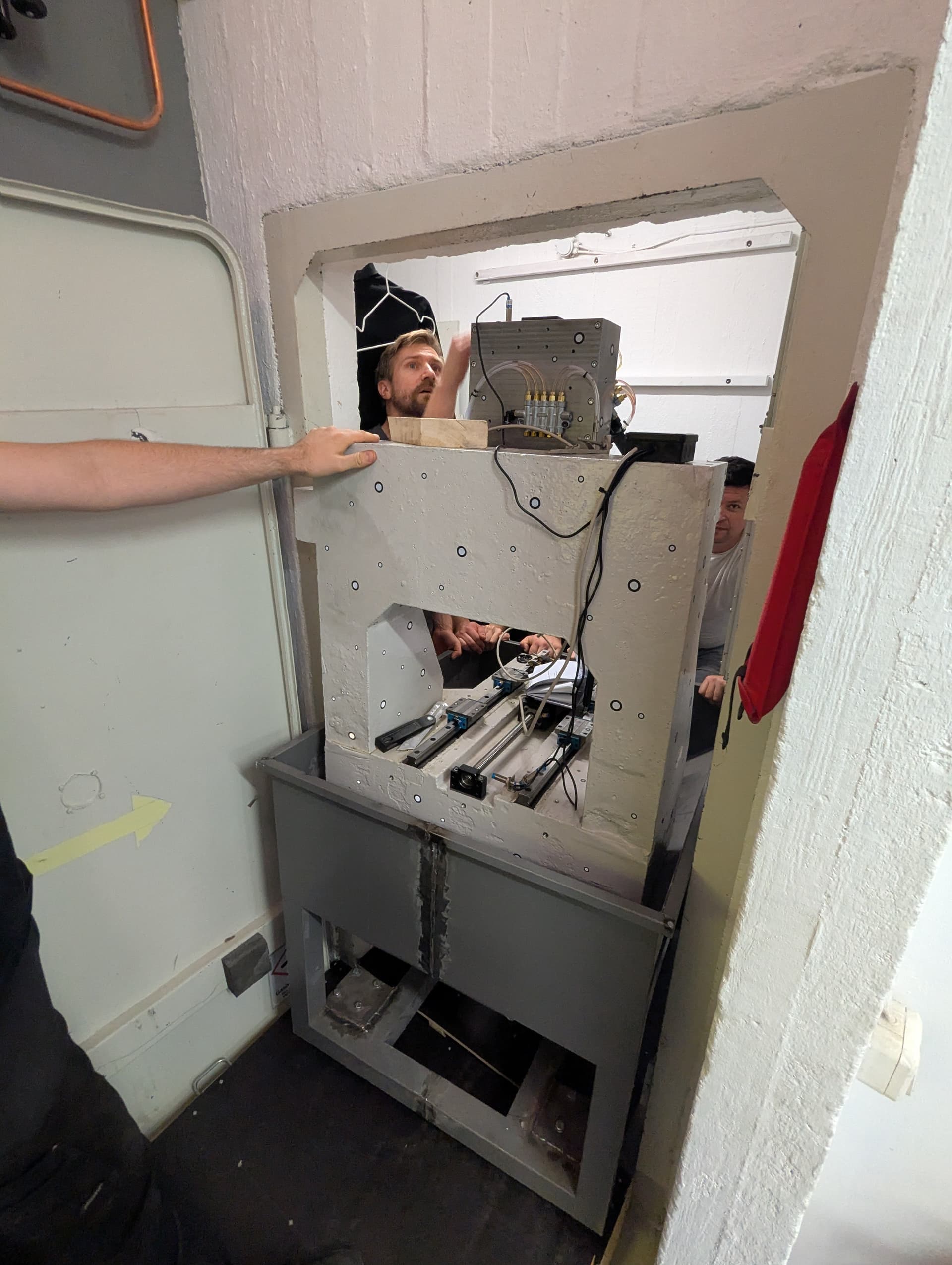

@TBJK Yes! We are trying to keep a lot of things on wheels.
Here’s a picture of us moving a 450kg CNC mill a few days ago. Had about 1mm of margin to the electrical cabinet, but it worked :rofl:
