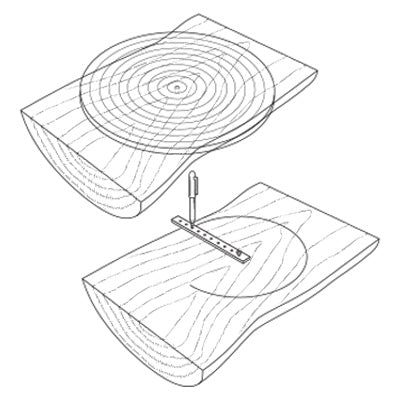

Do you know if we have acrylic that can be used for templates or should we buy our own? I’d like to cut an acrylic bowl blank pattern. Essentially, it is something like this:

What diameter do you need? I might have some scrap laying account. You’ll want to use cast acrylic, not extruded, if you are etching the concentric rings.
Made on our Laser cutter.
This is exactly what I was wanting. We could also make one for DMS as this would help the bowlturners mark their wood for turning into bowls.
The example below is pretty much what I was thinking. Any thickness works as long as it is reasonably stiff. Thanks for the offer. I’d say a 14 inch square piece would be adequate.
Thanks for the suggestions everyone. Going to order some pieces from sendcutsend and make the marks with the laser.
