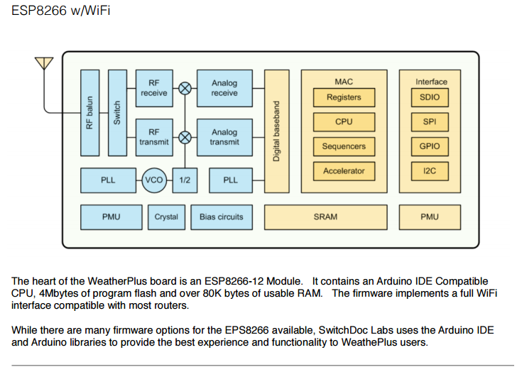

I did some testing with my own ESP8266s and I can’t seem to re-create the issue we had. I’m at a loss as to why it won’t connect to the “DMS Member” wifi network.
Might just be a faulty chip or fried during hook-up… i’ve only done that 6 or 7 times. Depending on the number of output pins y’all require, I’d recommend using the Wemos (pretty sure it’s the same chip as ESP8266) through the Arduino IDE or checking out the RasPi 0. I have much experience hooking the Wemos up to the DMS network and find it can go from working great to suddenly slowing down to a halt forcing a reloading of the code. Y’all might just have caught it at a peak usage hour or something.
We were able to connect to DMS Guest and has been fine since then. We’ll have to try again to see.
Awesome and muy bueno. Lately, we haven’t had much trouble with connecting through the chip. Can’t wait to see what’s coming! Also, I think but am not sure that connection might be better in some parts of the building than others

What he found is that DMS Member and DMS Guest are apparently both 5GHz. Our board is 2.4GHz. I’m not quite sure why those two frequencies would keep us from connecting but we were still able to connect to DMS Guest.
Using the GPIO0 pin he was able to reboot the board back to configuring the wifi settings. We tried DMS Member again and still were unable to connect.
Will try these instructions located in the specification manual:

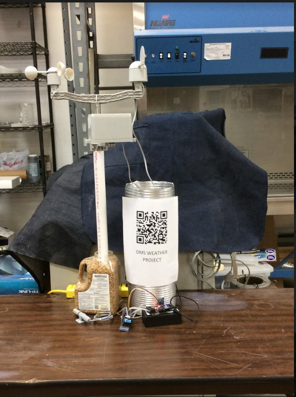

I moved the BOM for the base/antenna mast into the Wiki Page:
https://dallasmakerspace.org/wiki/Weather_Station
I’ve started acquiring components. If anyone wants to help with the construction (such as it is) let me know. Otherwise I’ll just put it together at home and bring the completed parts in.
Construction will likely take less than an hour and consists of a 2x4 frame for the base, a “Homer” pickle bucket bolted to the frame and filled with concrete, with a capped 6’ PVC pipe sticking out the top.
The box of electronics and the secondary mast with the sensors will be attached later.
