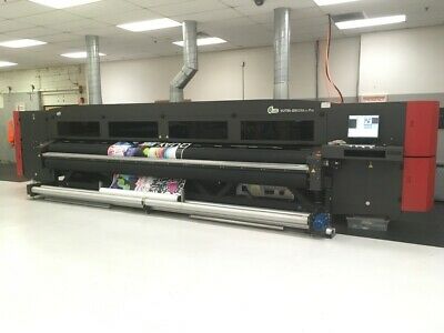

We sold Vutek for a while, this 3250 was about $300k. You can get a used one on eBay for about $100,000. Great machines, but they require tender loving care.
s-l400 (1)
You might call up Blank’s Printing downtown Dallas. They have a couple of big Vuteks, and they might like to give it shot.
