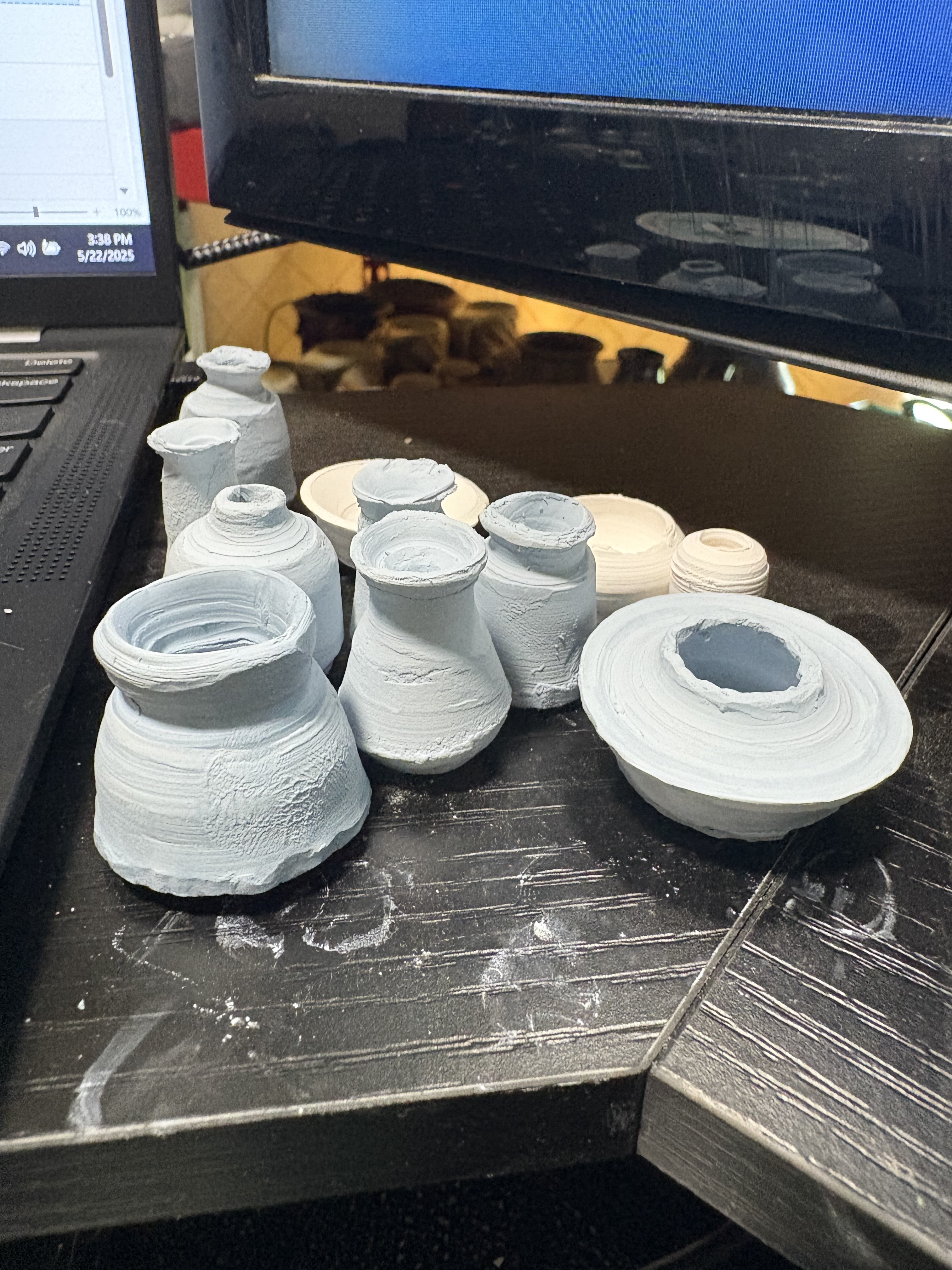

I am attempting to glaze a set of tiny pottery. It was suggested to dip them but I’ve never tried dip glaze before.
  1. I have mostly Amaco Potter’s Choice and Stroke & Coat glazes. Is it possible to dip with these glazes?
  2. Any suggestions on what tool to use to hold the tiny pottery when dipping?
Thanks!
