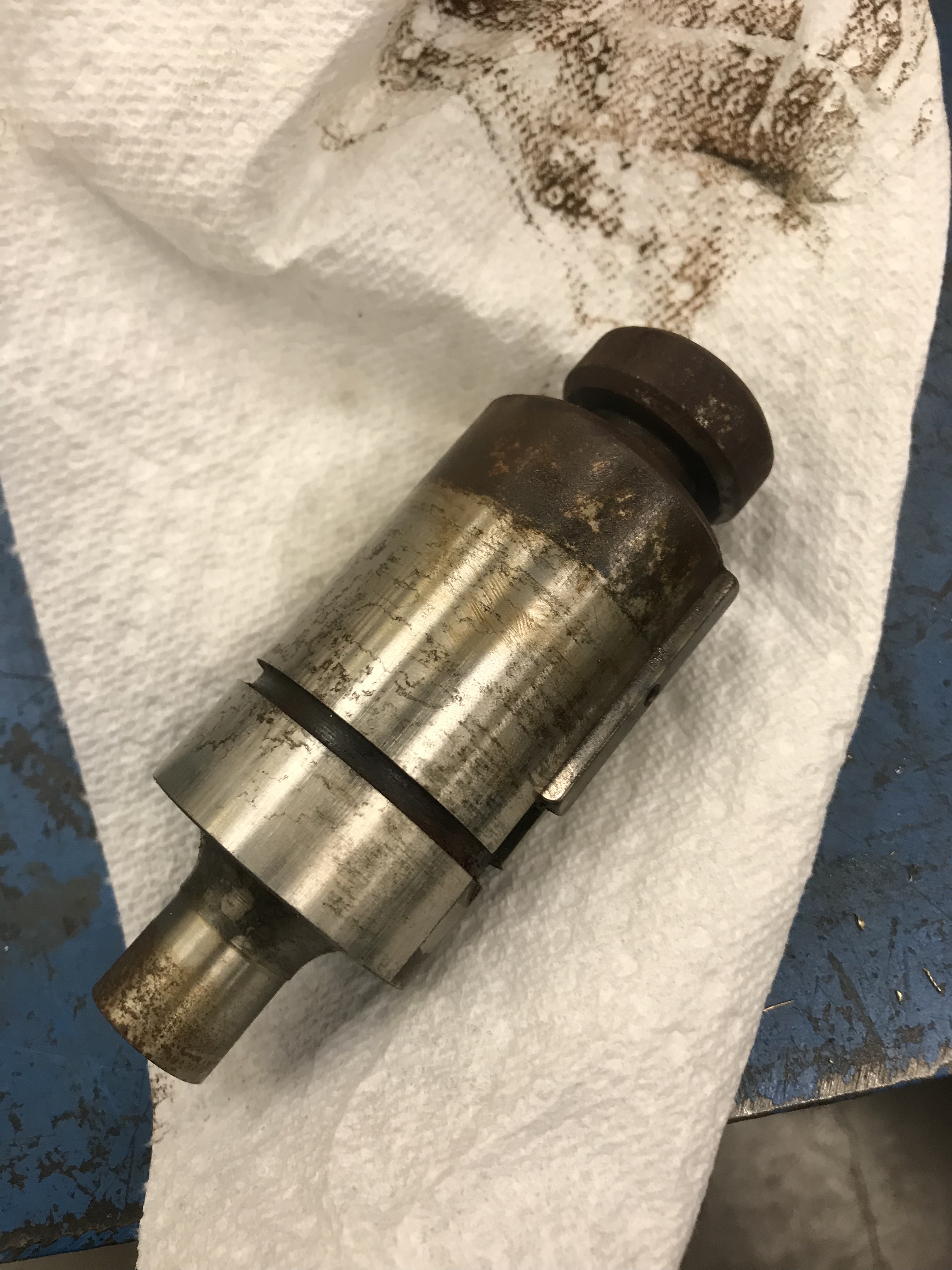

I freed up the turrets and all of the punches. I took 4 of the punches to the Vapor hone machine to clean them up. They cleaned up real well I think. The capacity from what I can tell is 16 gauge. It is hand powered.

Cleaned up more of the punches today.

Did these all get finished? If not I need practice on the vaporhone and doing something useful at the same time would be efficient, unless it’s capable to screw one up.with the vapor hone
I’m actually not sure because there is no solid documentation that I have been able to find yet. They say it depends on the thickness of the material, hardness of the material & diameter of the punch
I’m not sure if anyone finished up. I know there had been quite a few of them done last time I looked. Feel free to look & clean them up. You wont mess them up in the vapor hone. Just make sure you dry them of really well, There is a hole in the top, blow that out really well. I used the parts washer air to dry them.
