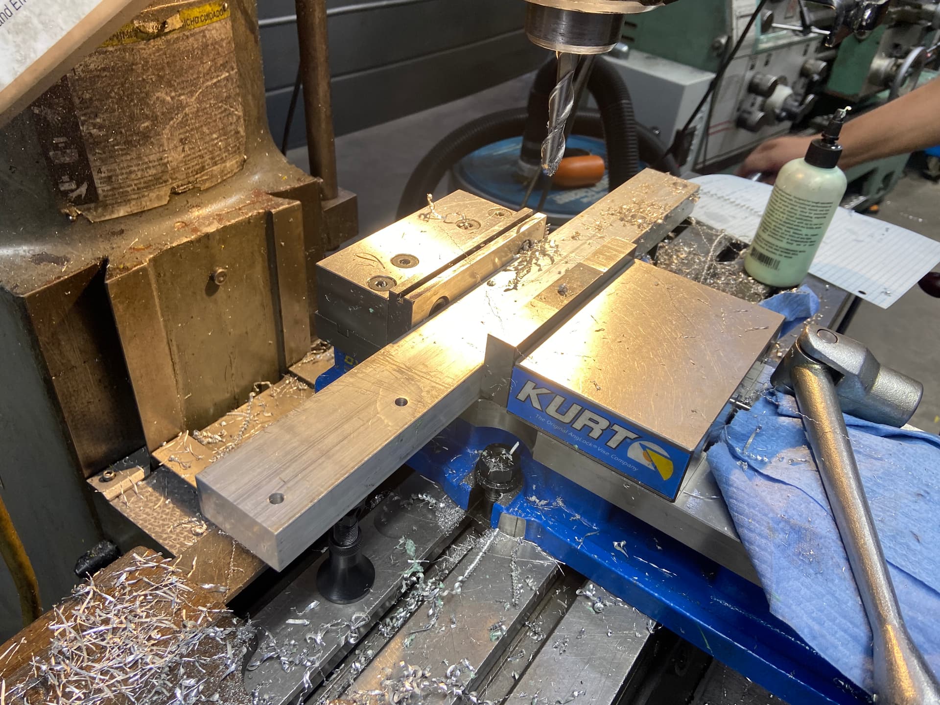

Thanks for the help today @ce_posadas & @BobKarnaugh in getting a new fence fabricated.
I took some pictures of the progress but not the end product.
That’s not a fence, it’s a barrier.

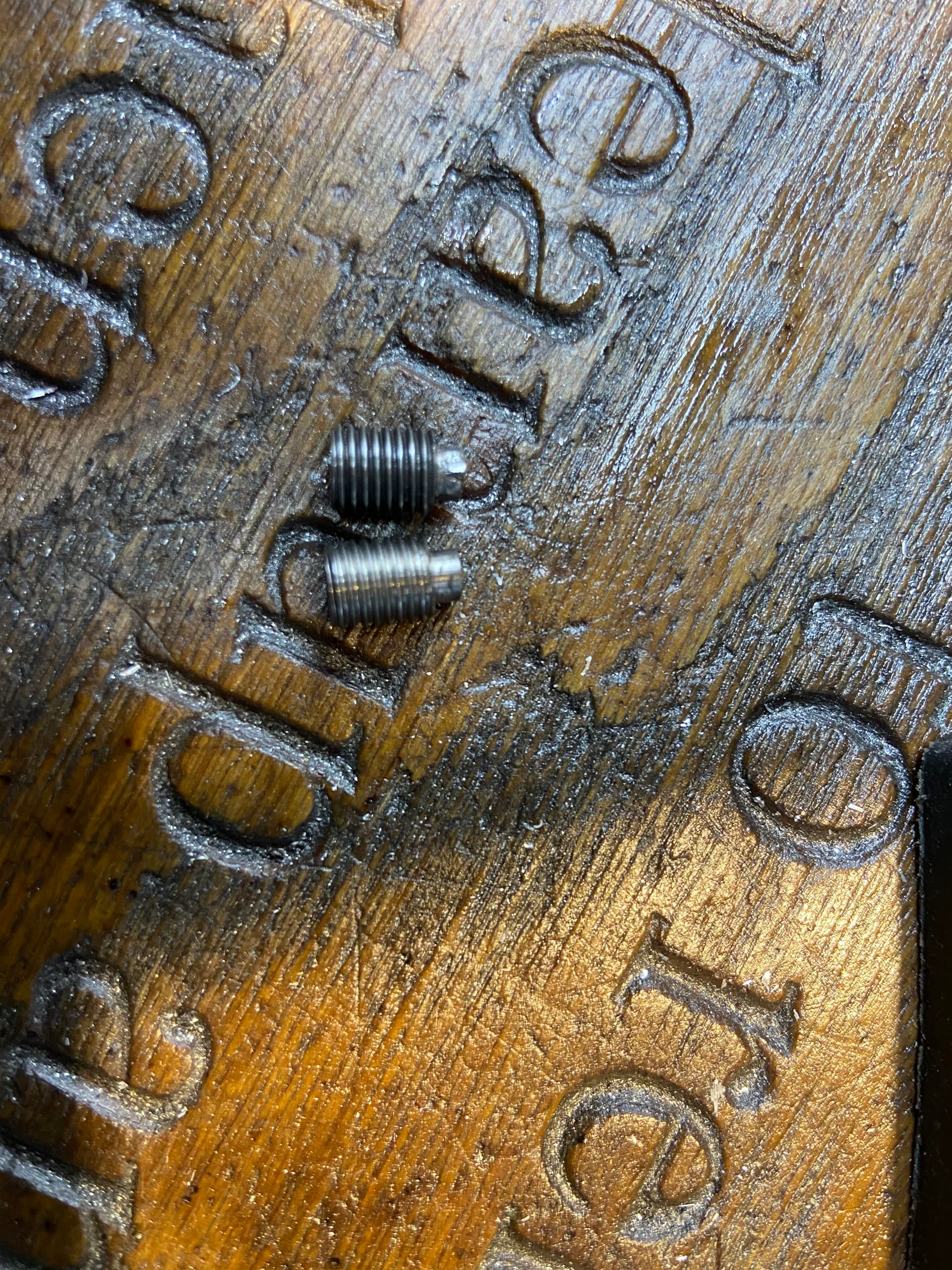

Also we fixed the Bridgeport while we were rebuilding the fence.
What do those pieces do on the bridgeport?
The collet pin & collet pin retainer. The smaller/thinner one was binding between the quill & spindle, thats why you had to hit it in reverse to free it.
