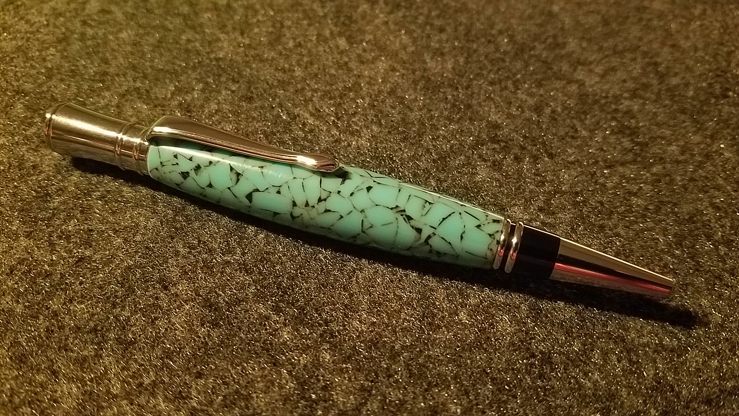

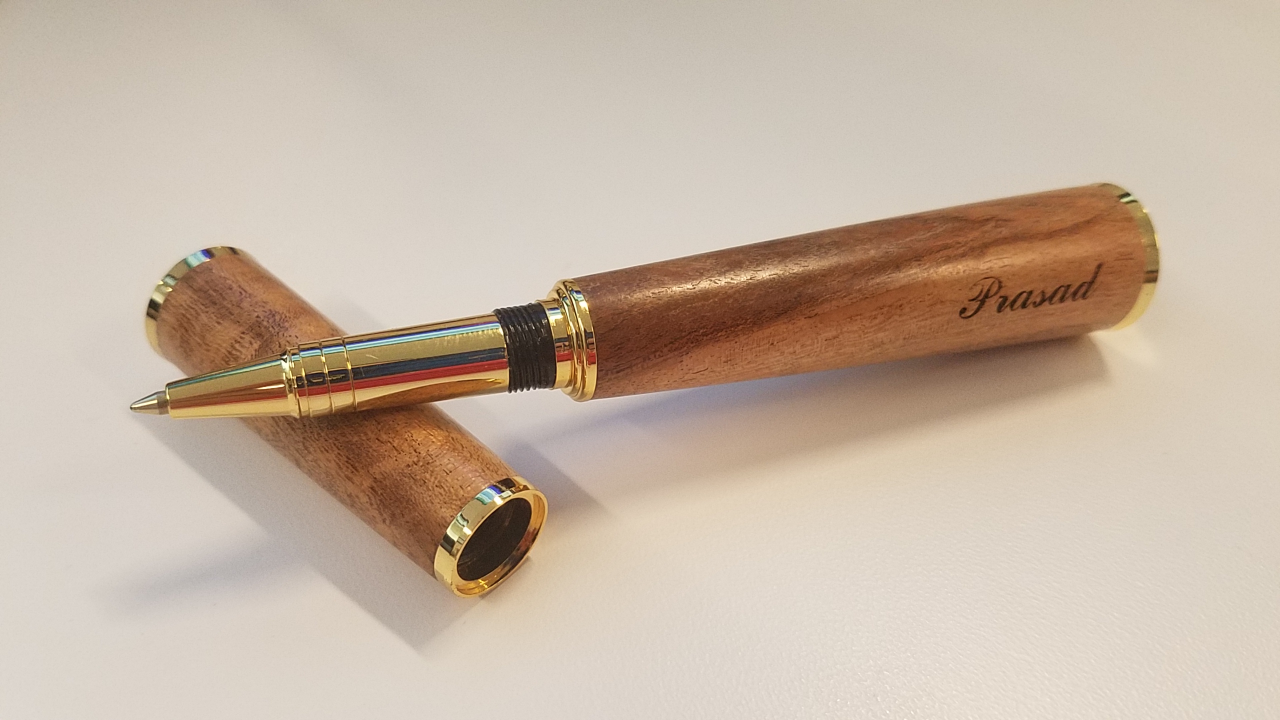

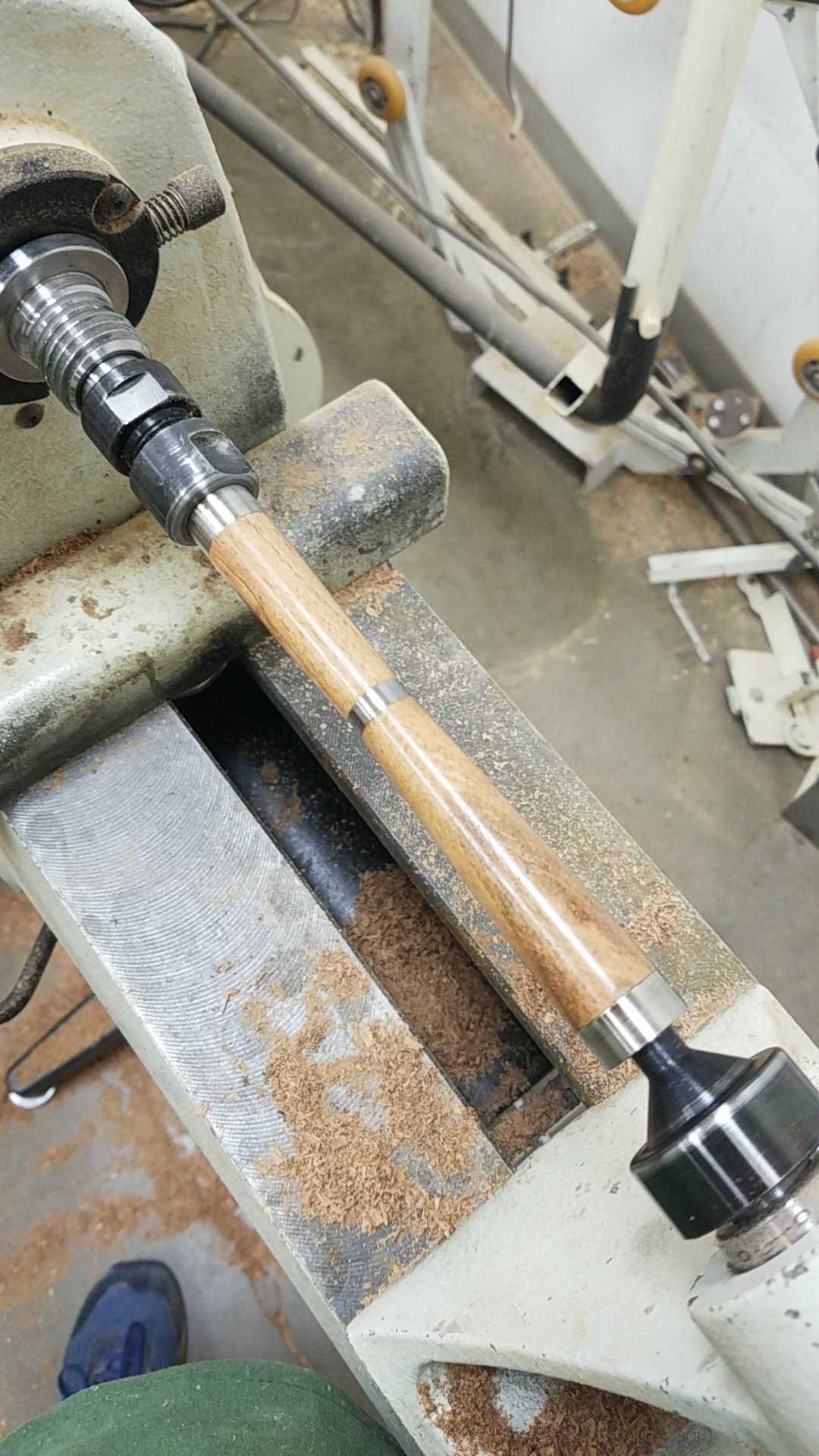

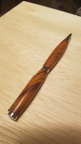

Been on bit of a ‘turning’ phase this last month, here are a few of the pens I made.
Mesquite with laser rastered name
Ironwood (might be my favorite now, can’t see the full shimmering beauty in the photo)
and turquoise acrylic

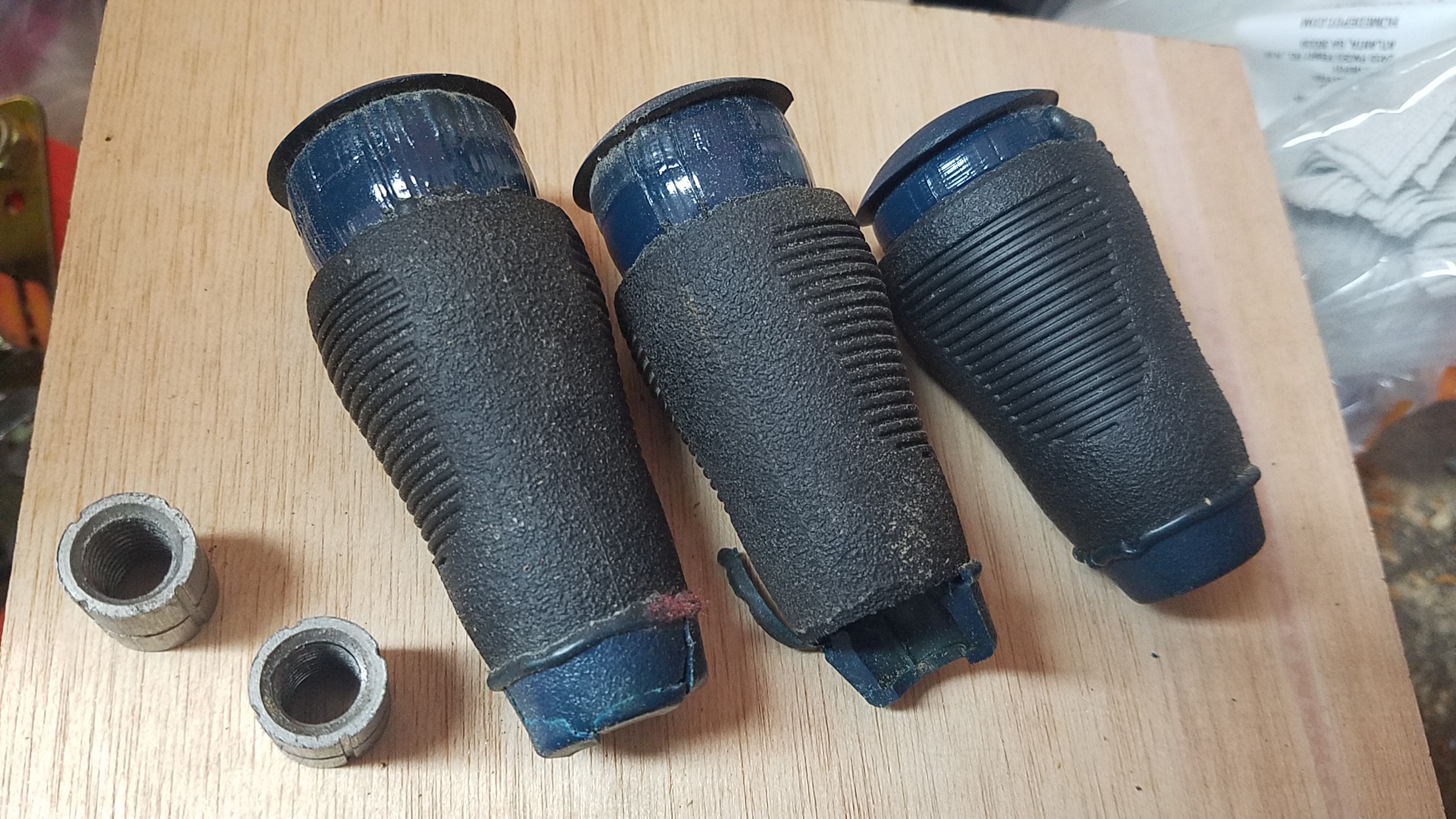

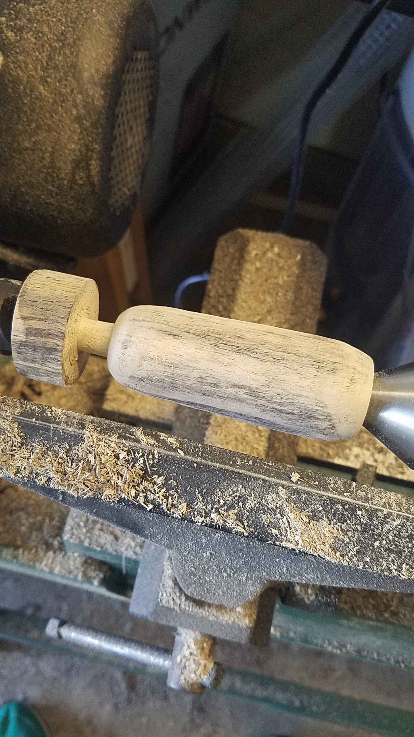

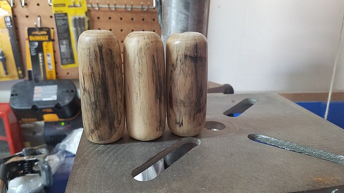

So apparently, after about 8 years of being used in a hot garage workshop, the original glue used to construct the handles of the $100 Ryobi will expand and cause the handles to fail and fall off. (it was quite impressive)

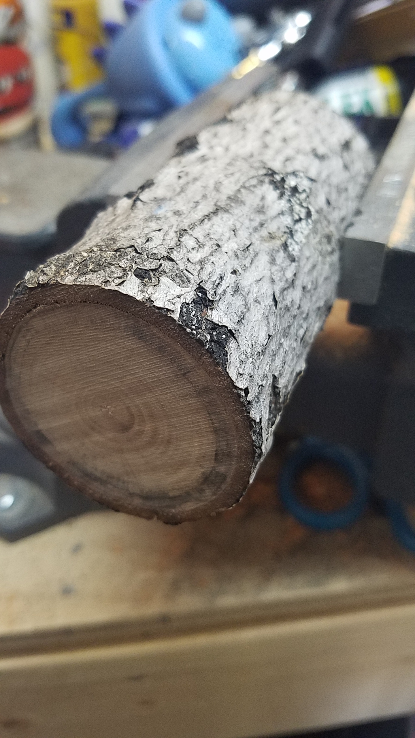

Thankfully someone donated a branch of walnut so, lathe to the rescue!
Fancy walnut handles makes a cheap Ryobi drill press all the more fancy :smiley:

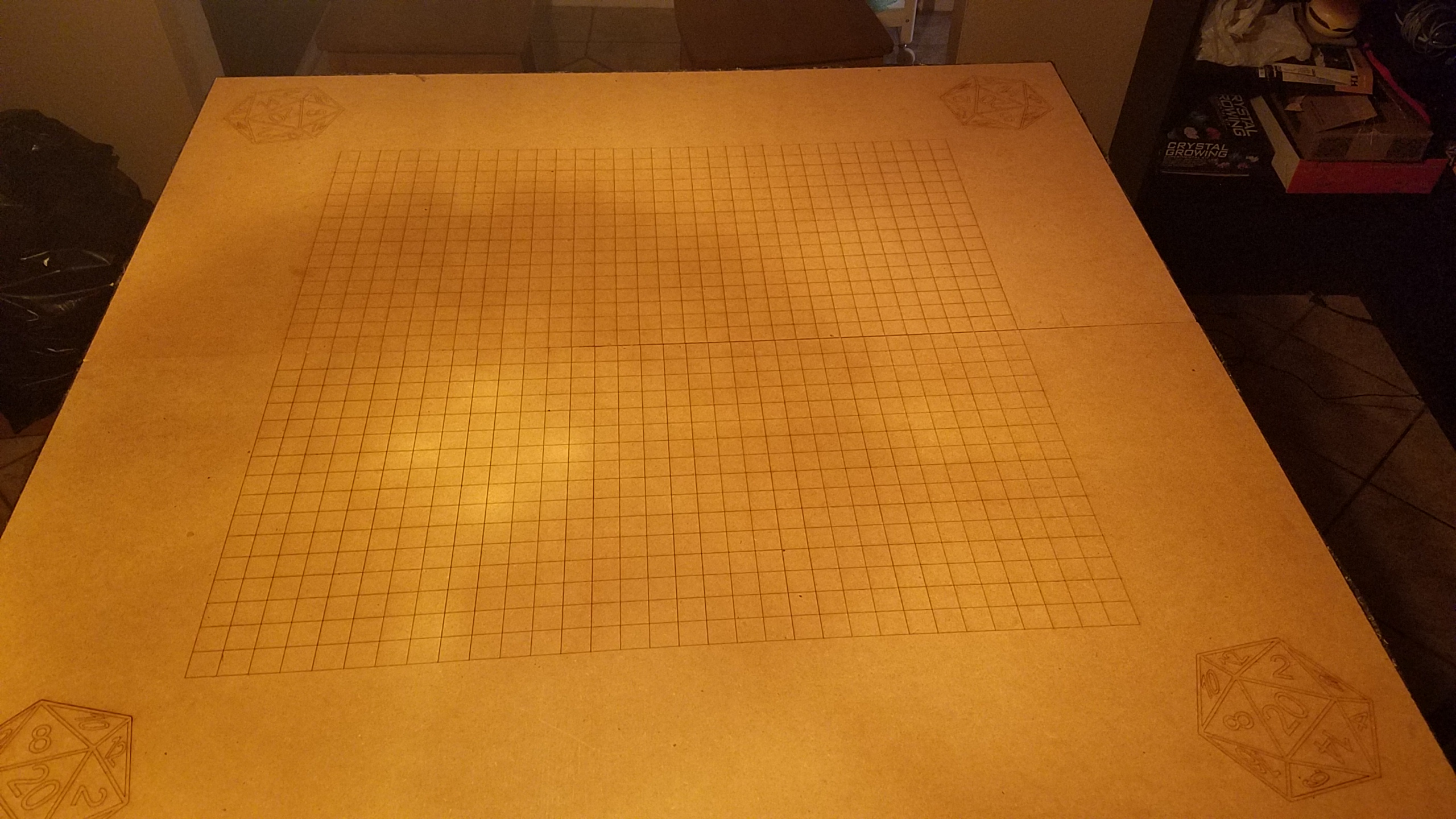

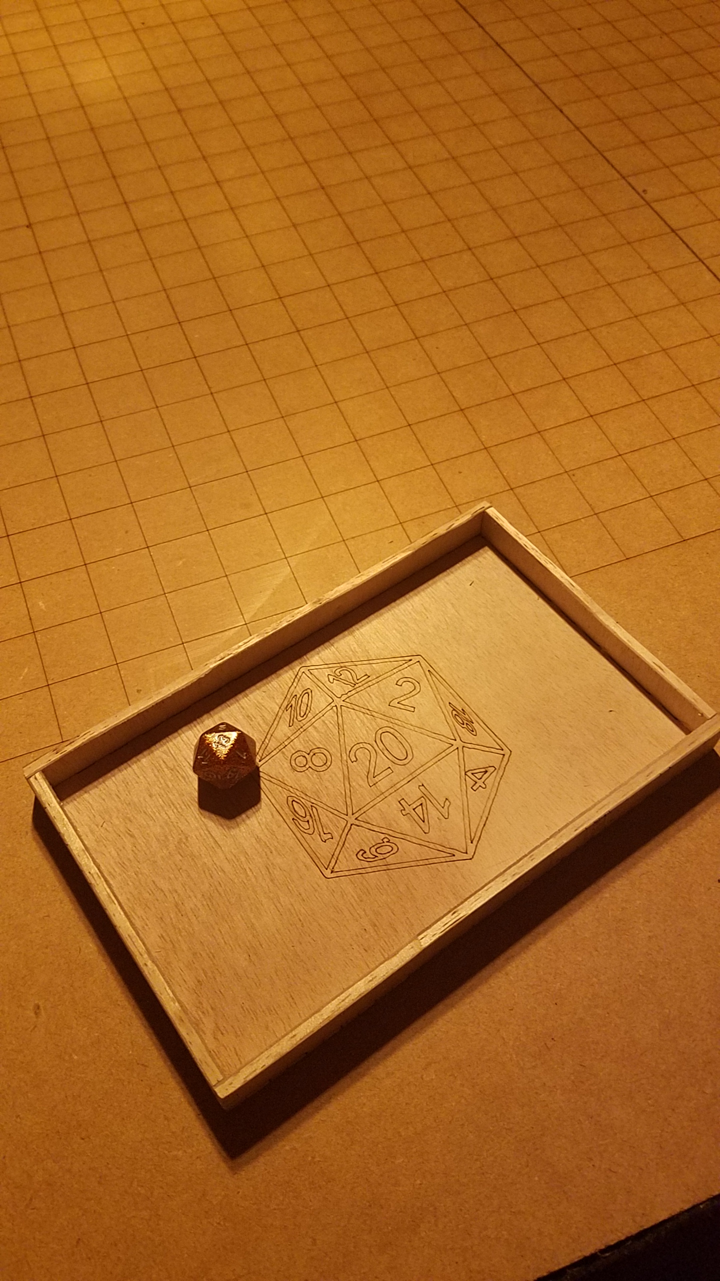

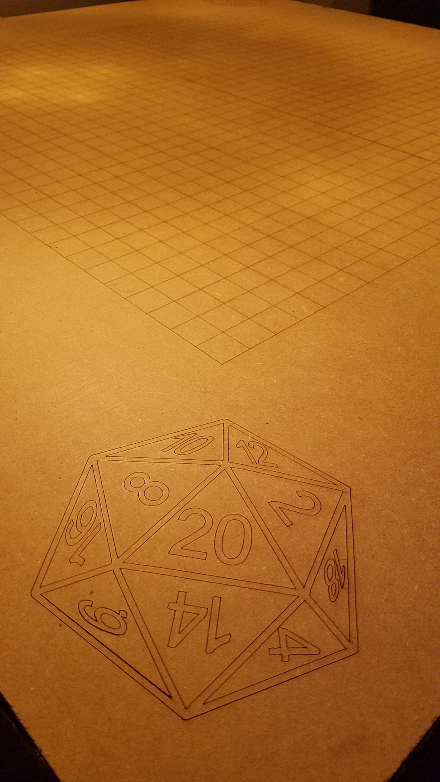

Last, but not least, project for this month was a quick upgrade to our gaming table/dining table.
Two sheets of 24x48x1/2" MDF, some craft-felt (cause i’m cheap) from jo-anns, a little time on the laser and boom. A flippable/foldable covering for the table.
Felt side for board and card games, hard side for D&D.
Boy approved.
Squares!? You’re supposed to use hexes man! :slight_smile: Glorious nonetheless.

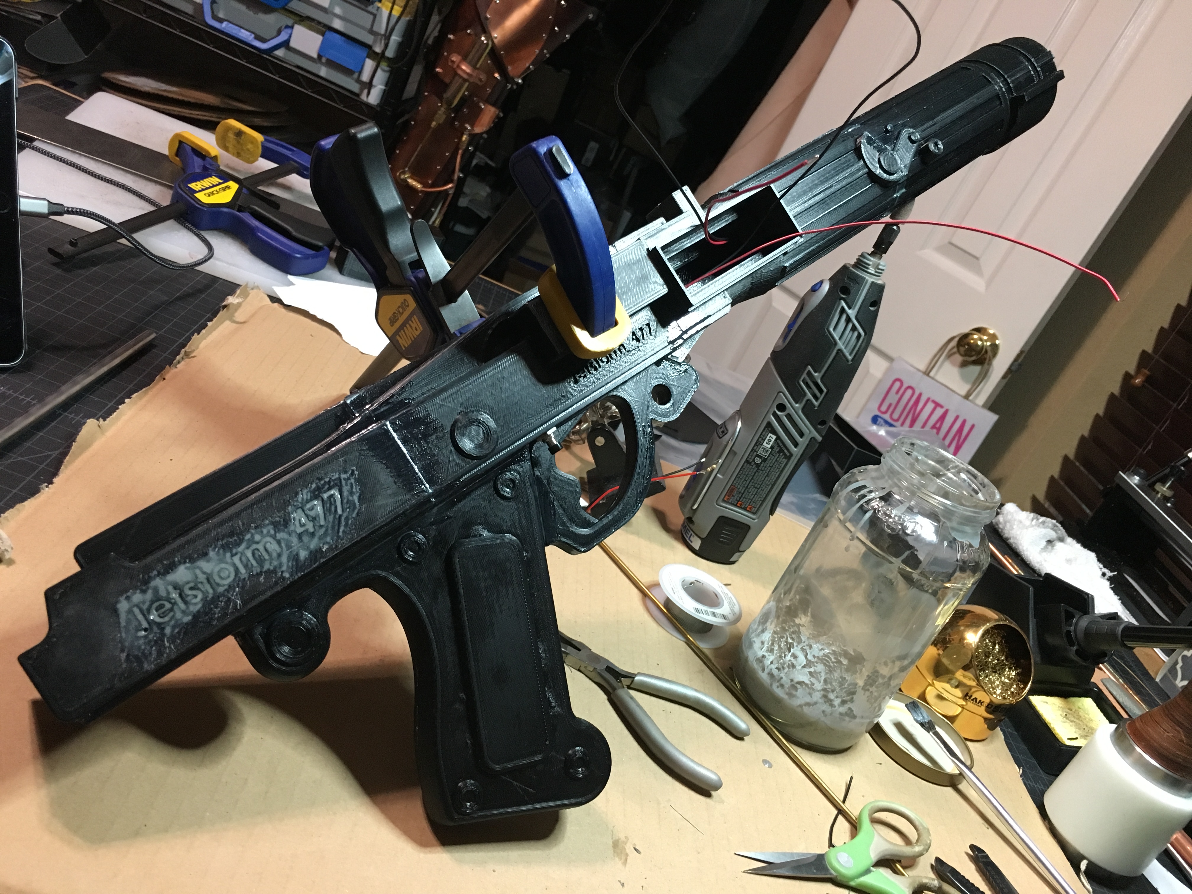

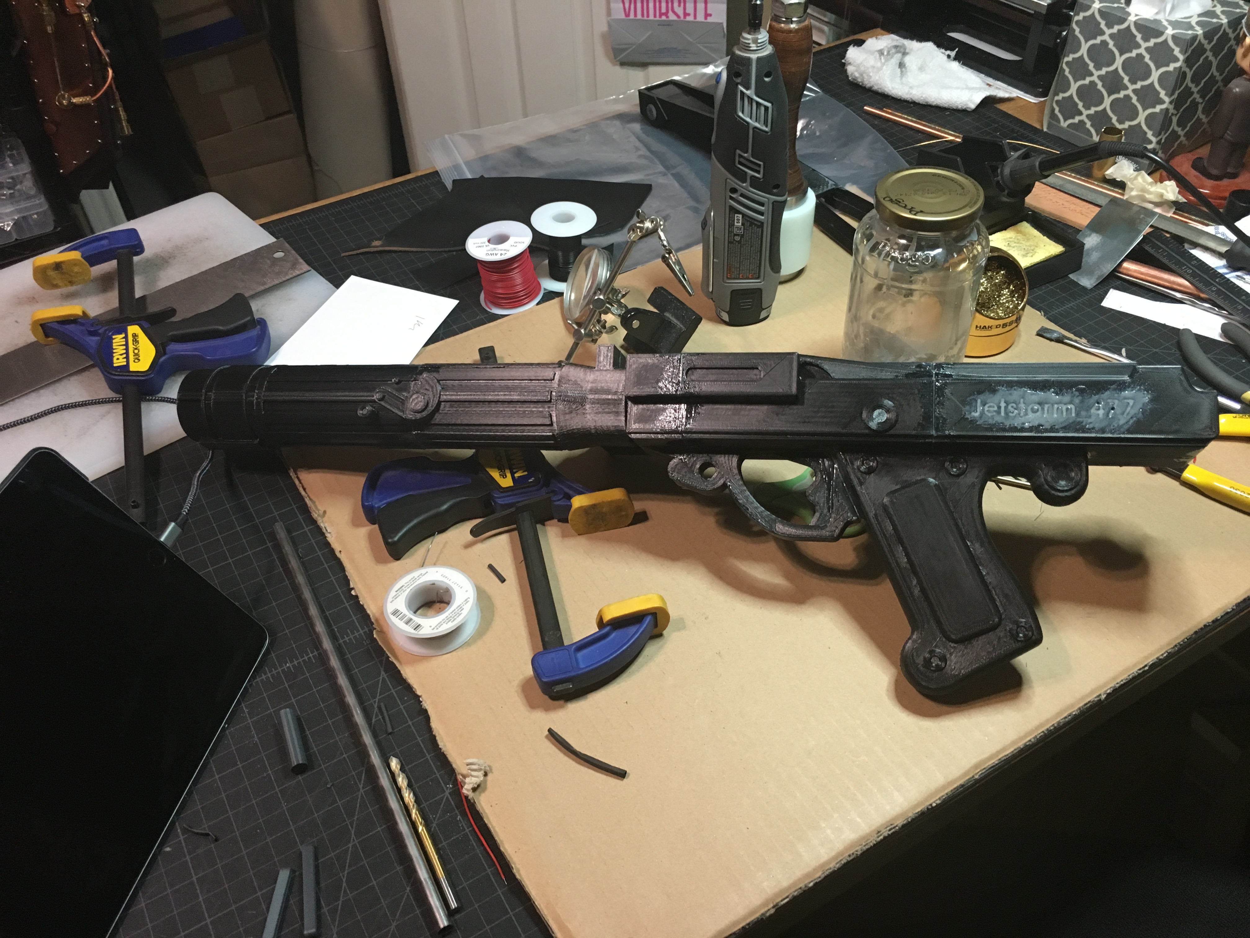

I’ve been working on building a DC-15S Blaster for a friend. All parts were 3D printed at the space. I’ve got it to the point of just needing to prime and paint it.
Video of the Light here: Imgur: The magic of the Internet
WOW! WOW! WOW! WOW! Amazing!

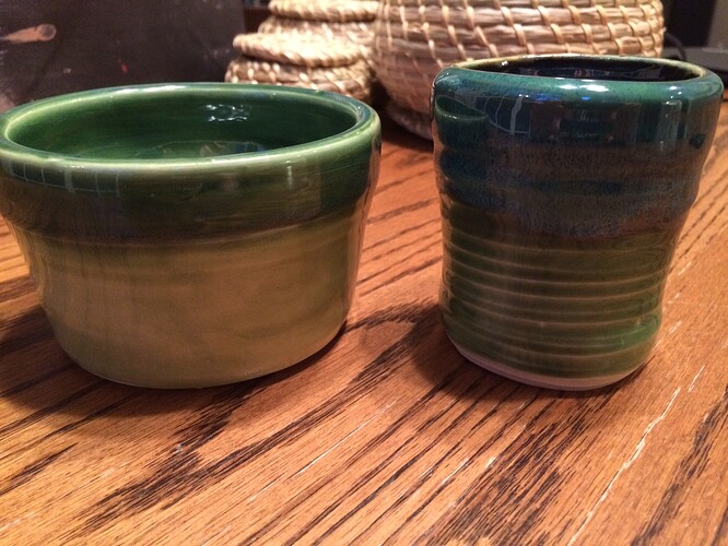

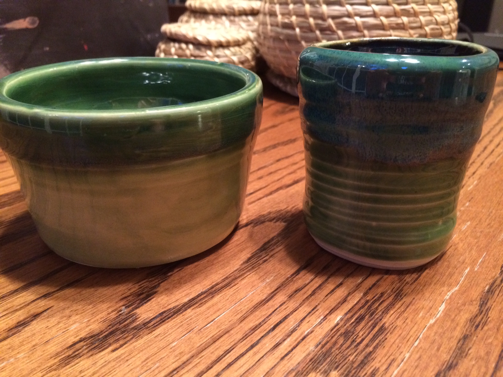

I took a pottery class with @cmcooper0 and @Shirley this month or should I say 4 classes over 1 month. This isn’t the first pottery class I take at the space but this is by far the best! We learned how to throw, carve and glaze. Christy and Shirley had a course plan and were thorough in their explanation and willing to share tips… and super patient! I have a lot of work ahead of me but pretty proud of my first 2 little pots :smile:
They made me like pottery again! If you want to learn about pottery, I would recommend their classes.
These are wonderful!
Wow that is beautiful. Any suggestions on how to get started on something like that?

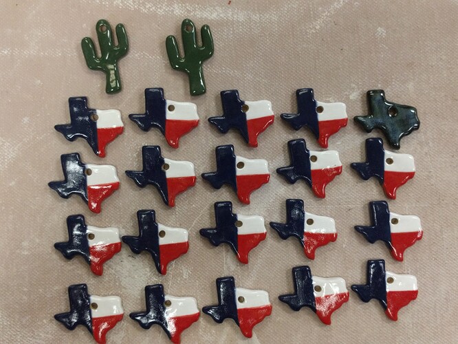

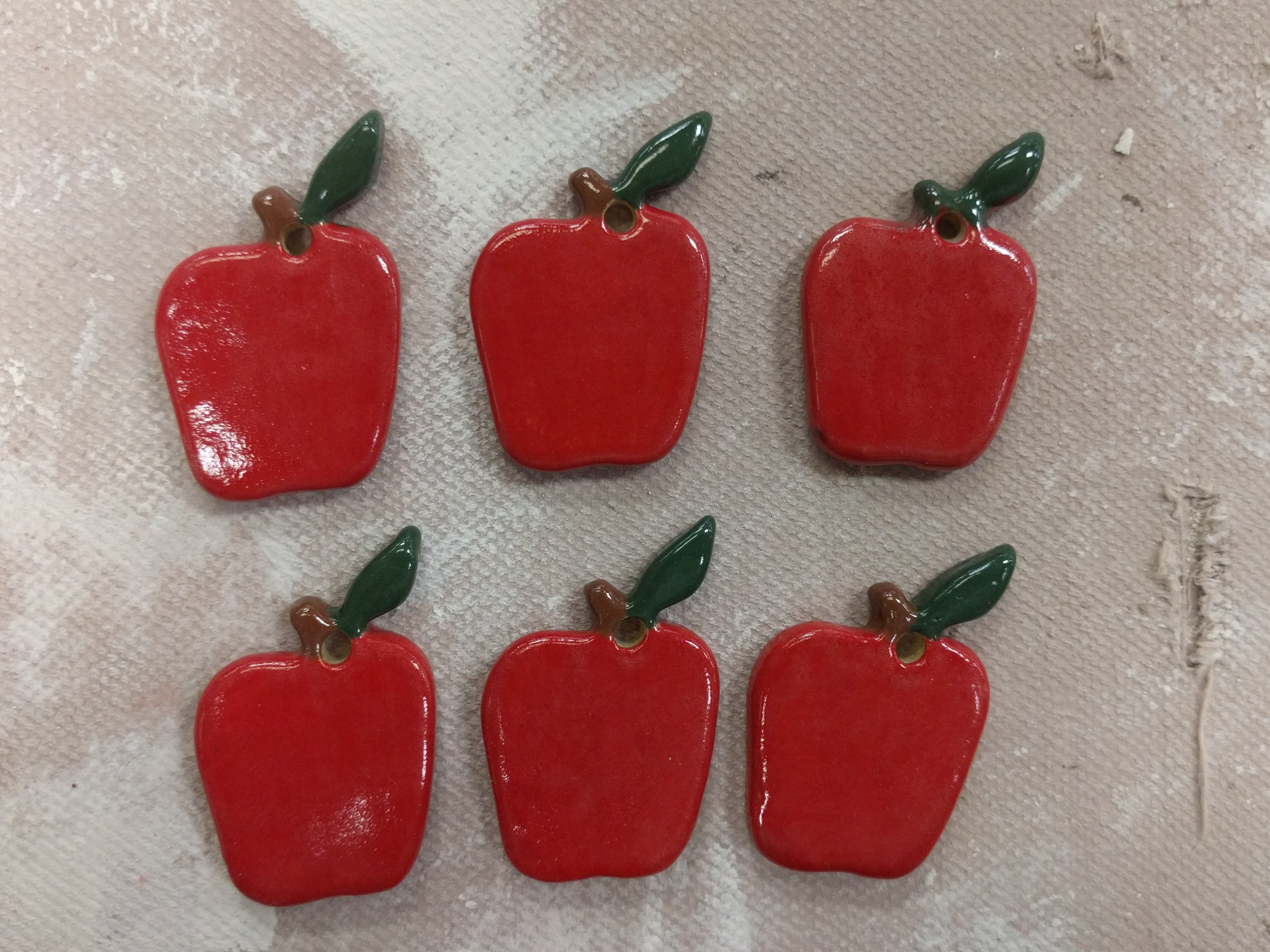

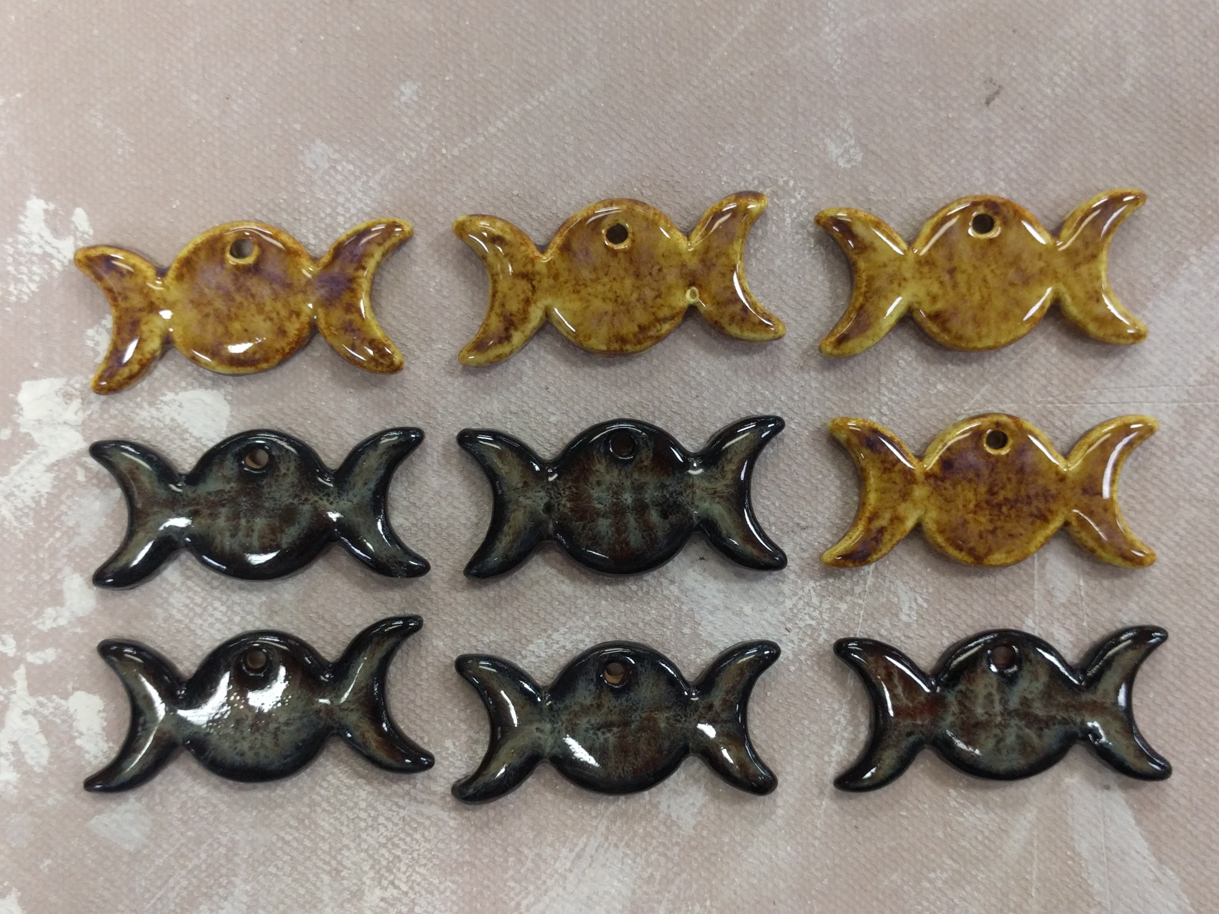

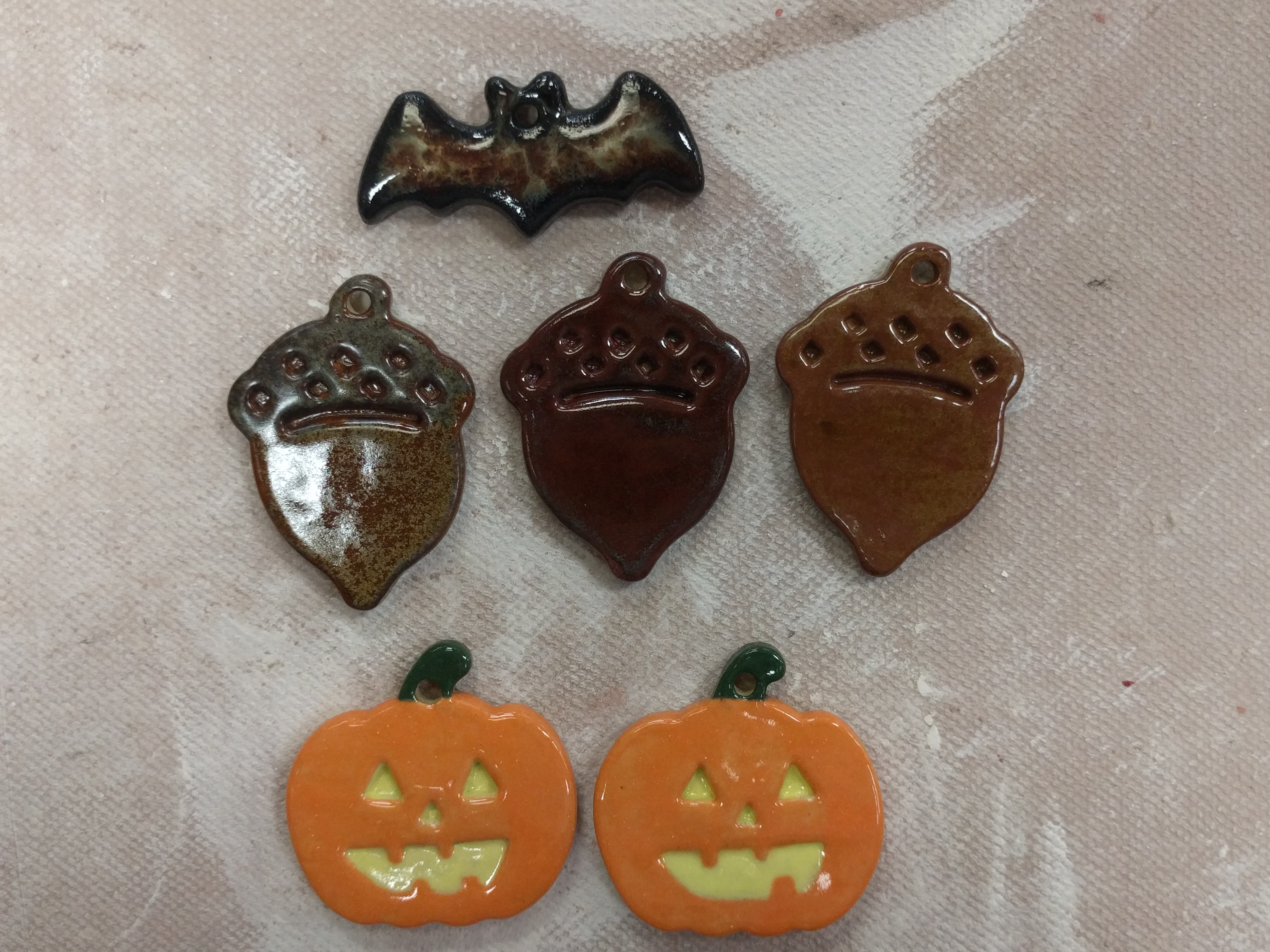

Fall pendants and future gifts.
Love the Texas ones! Love my adopted state.
Thank you!! They are challenging for me to paint but these were worth it. I was pretty pleased that I only messed one up badly enough to have to paint it solid blue.

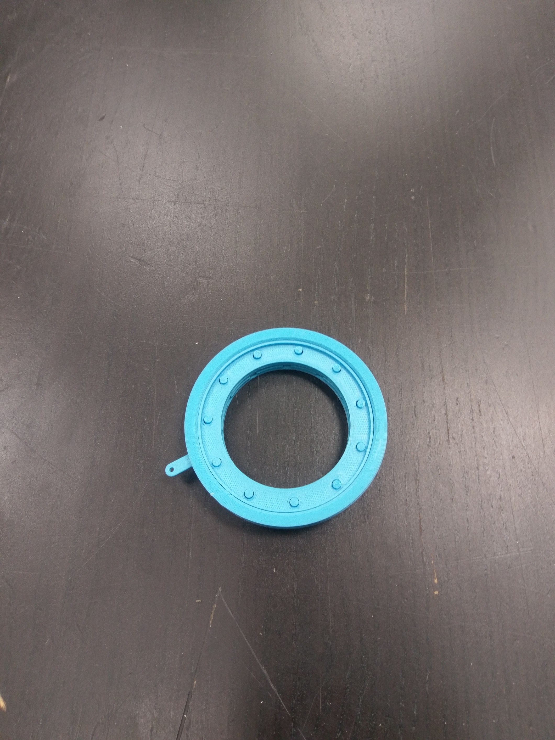

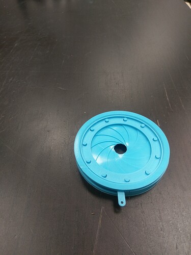

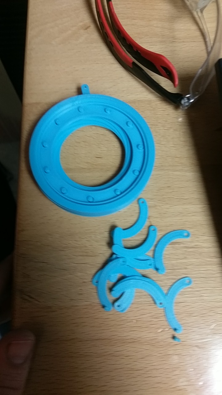

3D printed adjustable iris! Been a very productive month for me

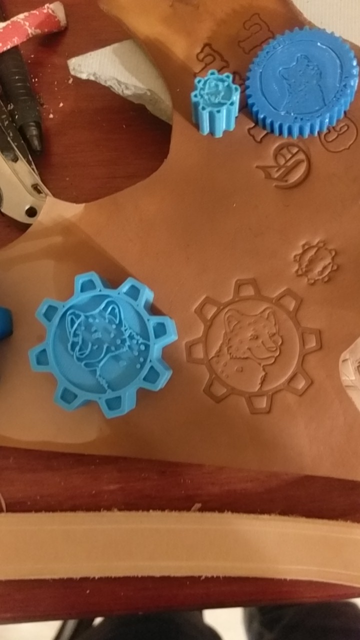

3D printed leather working embossing stamp

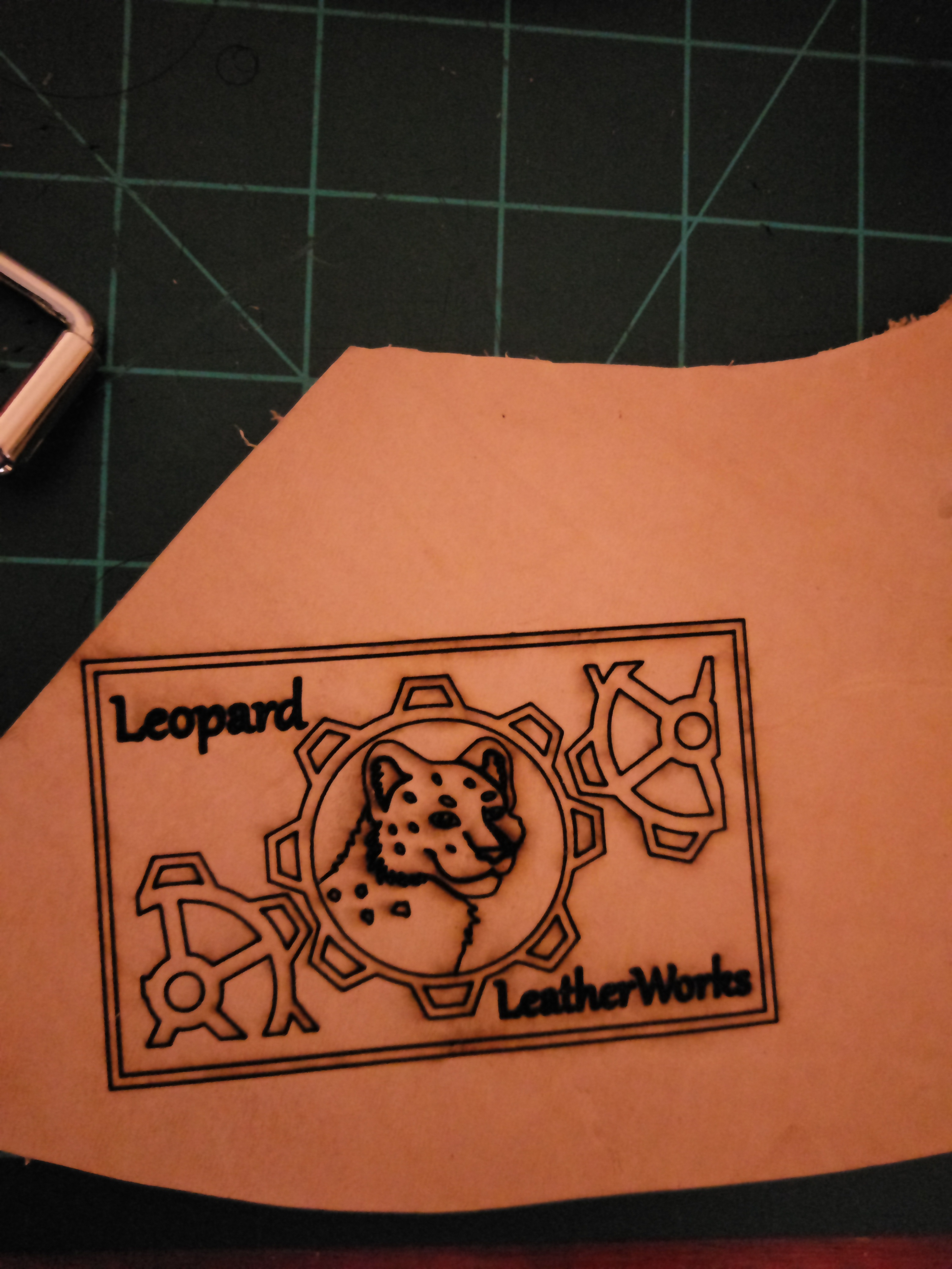

Laser cut leather

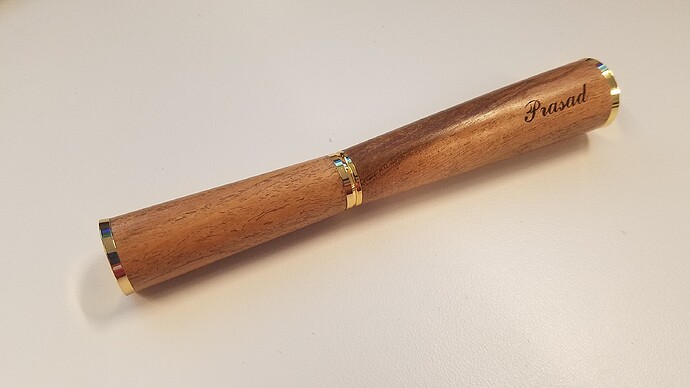

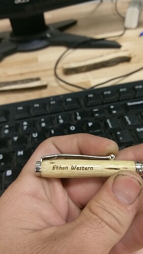

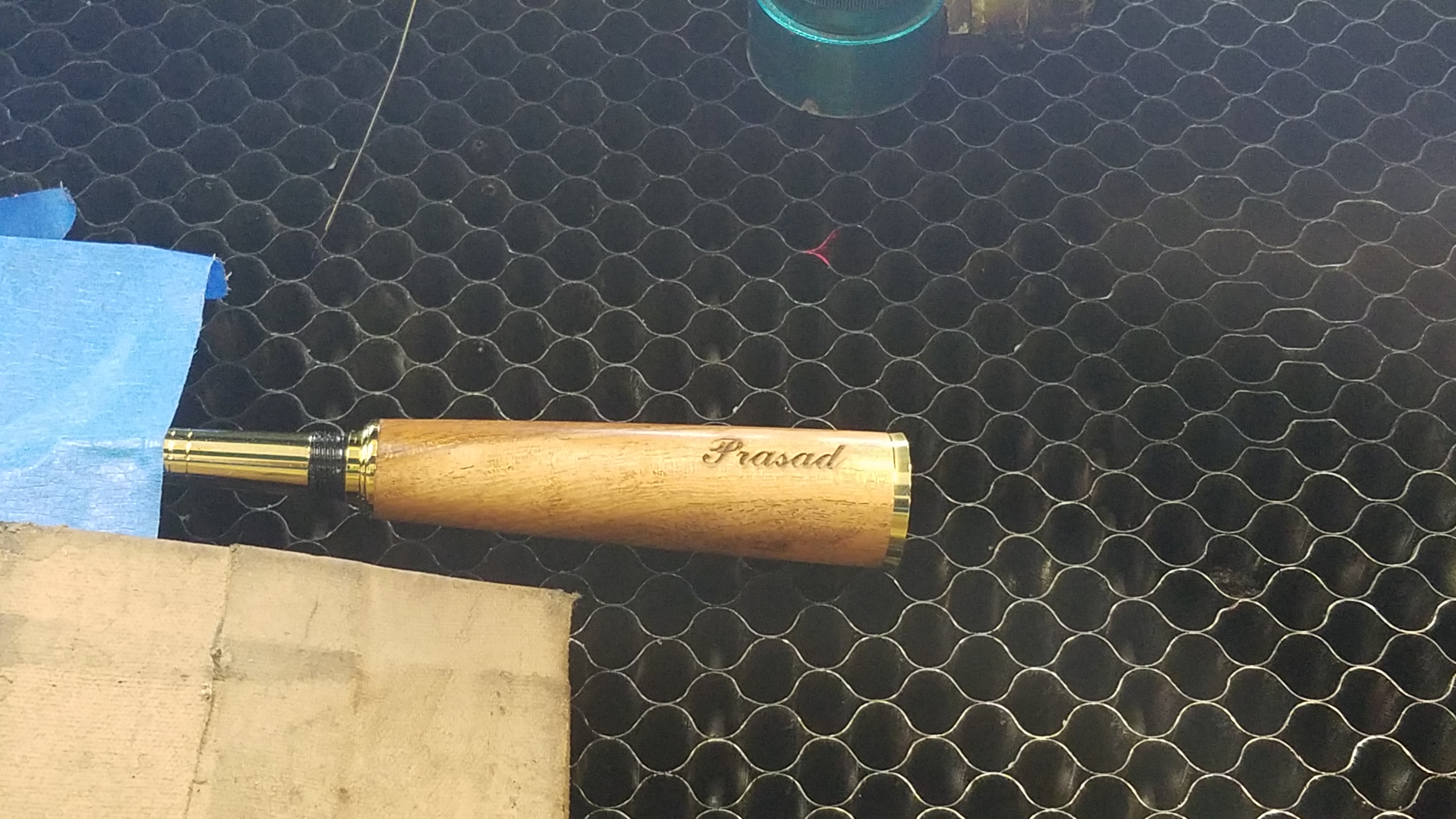

Turned and laser engraved a Slimline pen

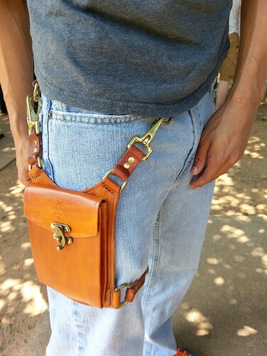

Leather hip pouch I made for a friend
