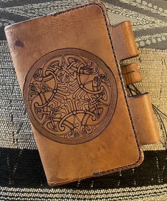

I vector cut line art in 3-4 oz vegtan for notebooks and knife sheaths with good success.
I’ve also done patches for ball caps.
The line art and lettering on both of these were vector (not raster) cut.

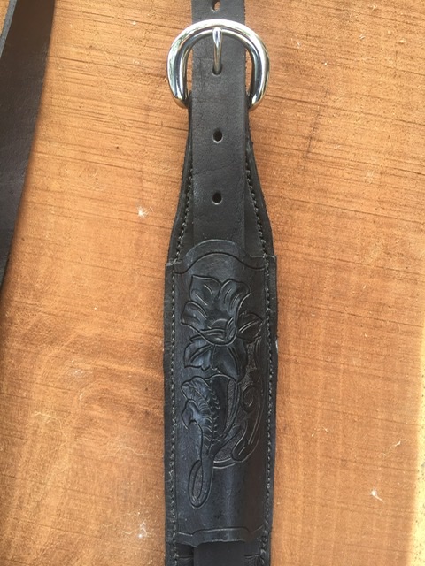

Curious for those of who have etched in leather. I am needing to make some belts with a repeating pattern on them but they will be dyed black when done. Has anyone dyed an etched leather product with a dark dye afterwards and has the etching remained visible?
Laser cut, opened up with a swivel knife, tooled, and dyed black.
Without the tooling and knife work, the laser cuts would still be visible, but subtle.
Laser cut and etched. No swivel knife or manual tooling.

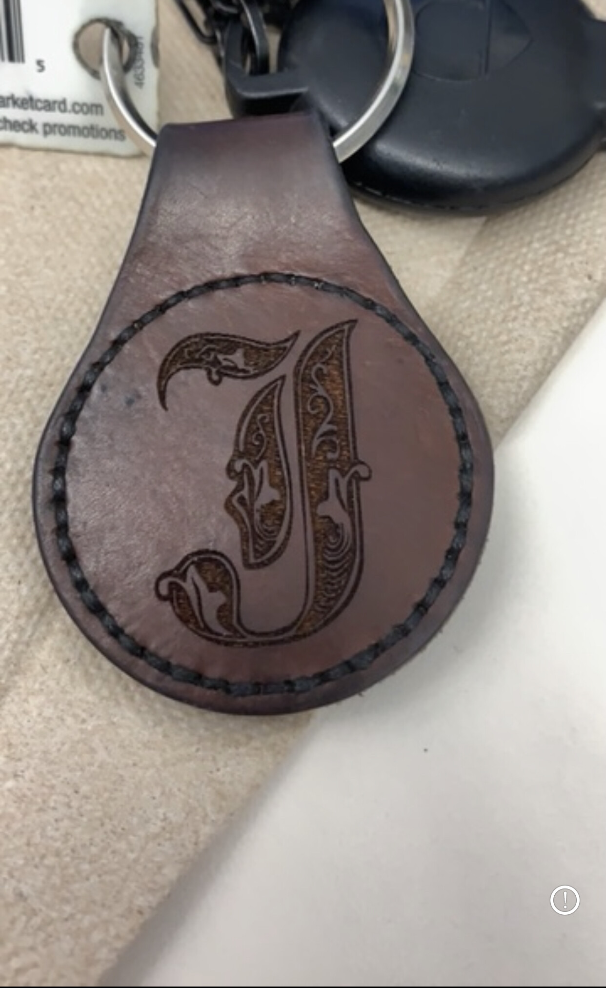

When you laser cut and detailed. did you also make the stitching holes with the laser?
Yes I do on all my laser projects. I prefer it to the traditional hammering technique. Also allows me to do nicer curves in my opinion.
I laser 0.05” round holes for stitching, usually 5-6 per inch. To space them in InkScape by placing a bunch of holes, then using a circle (perhaps 0.15” diameter) as a spacer, arranging each stitch manually. Once I have 10 or so laid out and evenly spaced, I remove the spacers and clone the stitch holes to make the remaining stitches.
Once cut out, I enlarge the holes with a diamond awl prior to stitching.
