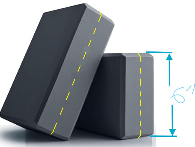

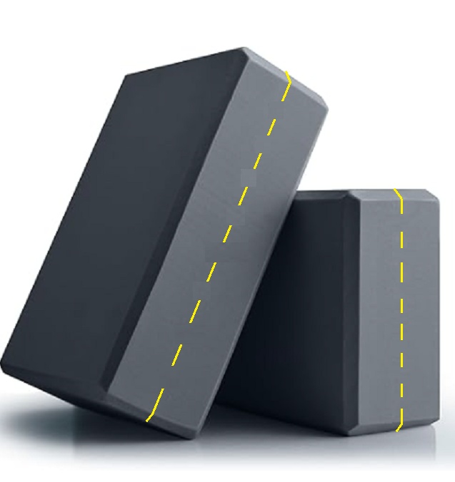

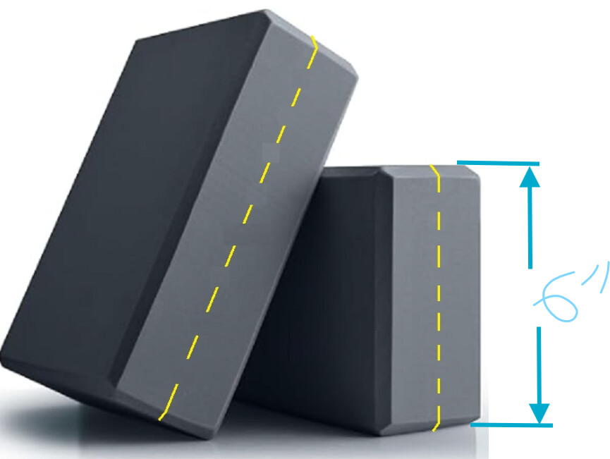

I need to cut some High-Density EVA foam Yoga Blocks in half - the long, wide way (see picture)
What tool / blade combo would work best for that?

tl;dnr - table saw, standard blade should be fine with cut-flip-cut method
Longer version:
I’d think a table saw with 10" or larger blade would work fine. Their depth of cut is approximately 3.5" (or more for larger blades), typcially, and at 6" wide,
those blocks should be severed in twain by the standard cut-flip-cut method (keep the same side of the block against the fence for cut 1, along the length, then flip length-wise, keeping the same side against the fence for cut 2 along the length - et voila - 2 ~1/2 depth blocks).
Minimizing the kerf could be done with rip-type, finishing-type, and/or thin-kerf blade, but really a run-of-the-mill blade should work fine.
I would also think, as has been suggested by others, a bandsaw would work well offering a finer kerf than a standard issue circular blade. I expect it will be tougher to keep straight & true, even with a fence, but just 1 cut to line up for each brick.
Reciprocating saws are impossible to keep straight & true along any length. They’re meant for rougher work.
Too shallow, at less than 1" stroke length for most jigsaws, even if you could get a full-depth cut on all 4 sides, you’d be looking for a way to saw the other ~4+" out of the center. In a pickle, one might try this, and expect to finish up with e.g. handsaw, but those would be dire straights, in my opinion, and likely much poorer finish requiring much more cleanup work.
