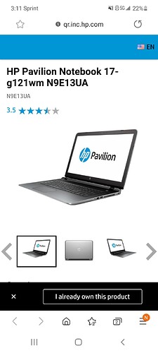

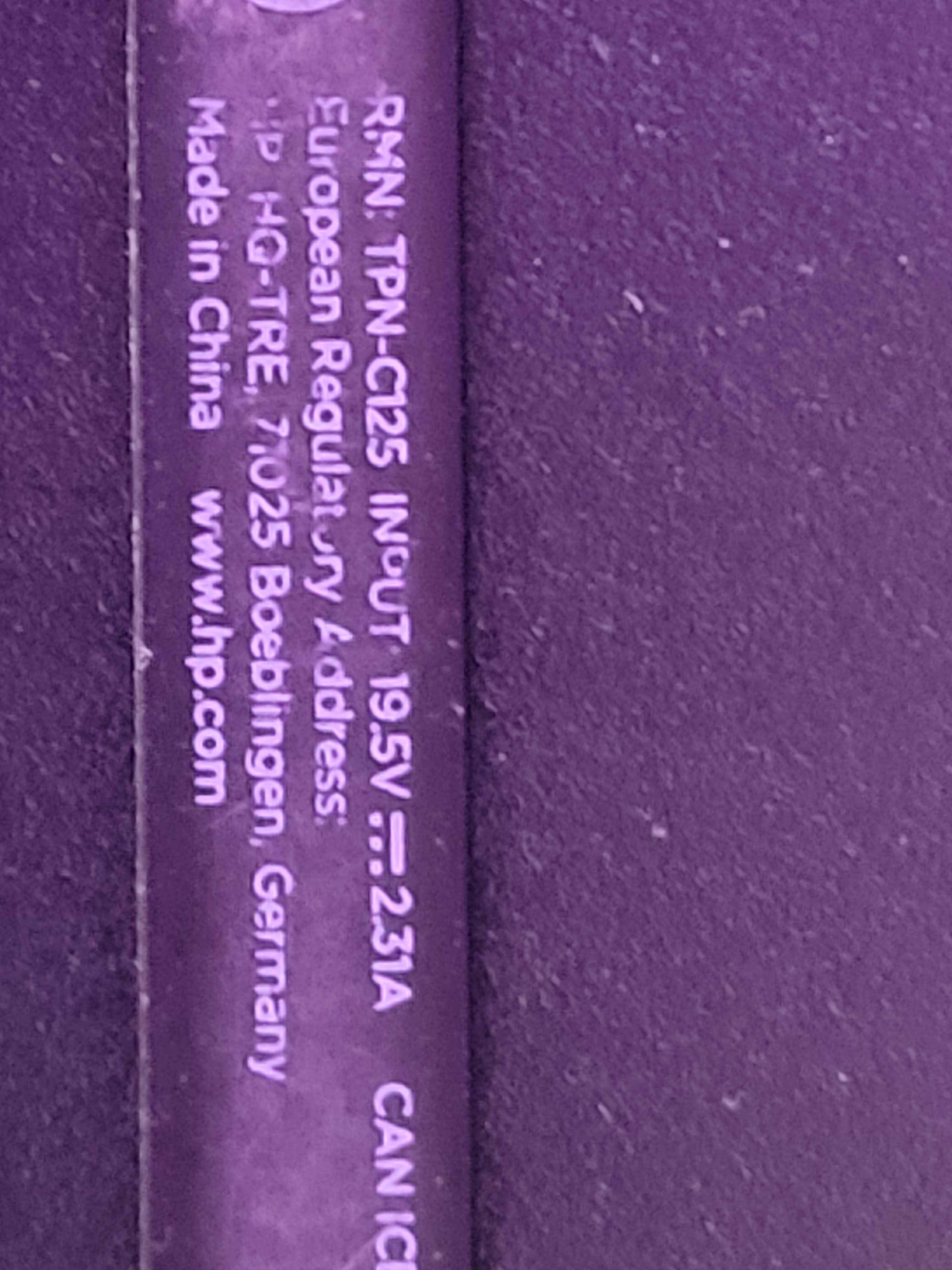

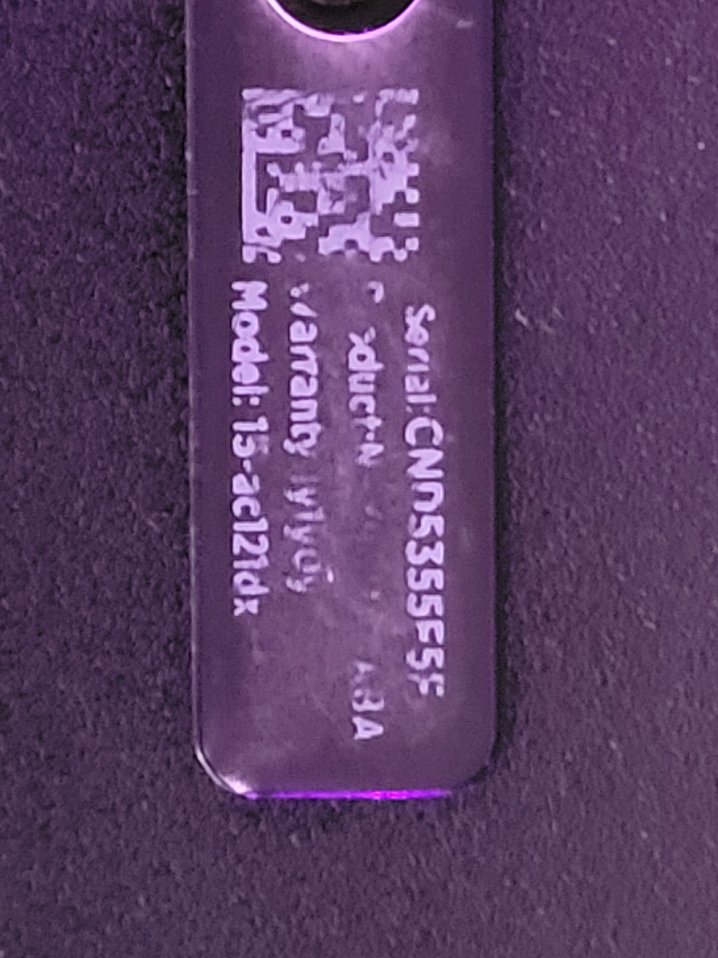

One is a HP pavillion and its about 6 yrs old. It runs super slow it takes forever just to load the home page. The second one is also an HP don’t know the model, since this won’t even power up.
Model number should be on case somewhere, usually the bottom. Same place serial number is, power requirements, etc.
The first image is the info for one and the other 2 pics are for the second computer

Could be a variety of issues here. Do you get any lights on the computer when it’s plugged in?
If not, I’d verify the power adapter is working. Once that’s ruled out, I’d focus on the DC power jack.
Does the connection feel solid when you plug it in? Is there any wobbling? Does it seat fully?
Following that, I’d open it up and use a multimeter to test the voltage where the DC jack meets the motherboard (it’ll either be soldered directly, or, hopefully, connected via a cable). If the motherboard is getting power, then things get more complicated.
