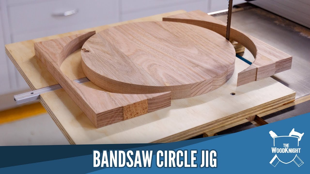

You can easily cut a clean circle on the bandsaw if you put a board underneath it with a nail or peg in it, and partial-depth drill the center of your intended circles.
This article describes the concept, although he makes a fancy jig he can use for multiple diameters. You can accomplish the same thing with a hunk of board with a nail in it, clamped to the bandsaw table.
One can also make a simple circle-cutting jig for the bandsaw. It would require a pin for the disk to rotate on, which in turn leaves a small hole in the center of the disk. This can be plugged later, if desired. No sanding to the line would be required and once dialed in, such a jig makes very repeatable, consistent cuts.
Here’s a how-to:
