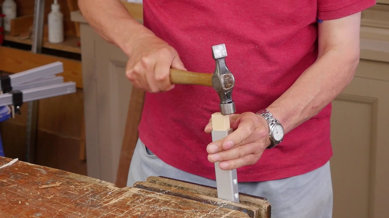

The Bessey’s cost on average $40 each, while the Harbor Freight ones go for $10. If the HF ones last even a fourth as long it’s a break even proposition, and with a couple minor mods/tweaks when we buy them I think they could last much longer than that.
Youtube modification/upgrade guide here:
I’d be willing to do all of the mods on a set of these for testing if the shop wanted to try out a small batch to see how they hold up.

Only mod to PS’s approach I’d suggest would be to substitude 3D printed pads that can be slid on for the wood squares he tapes on. But overall a very solid set of upgrades to some very inexpensive clamps.

I went and got a set to play with to see how much improvement is gained with the mods.
Stock, they’re very easy to twist and feel flimsy. After mods, they’re much more solid, and the ability to twist them is almost eliminated. I will try to make the next woodshop meeting to show the difference between the two if there’s interest.
