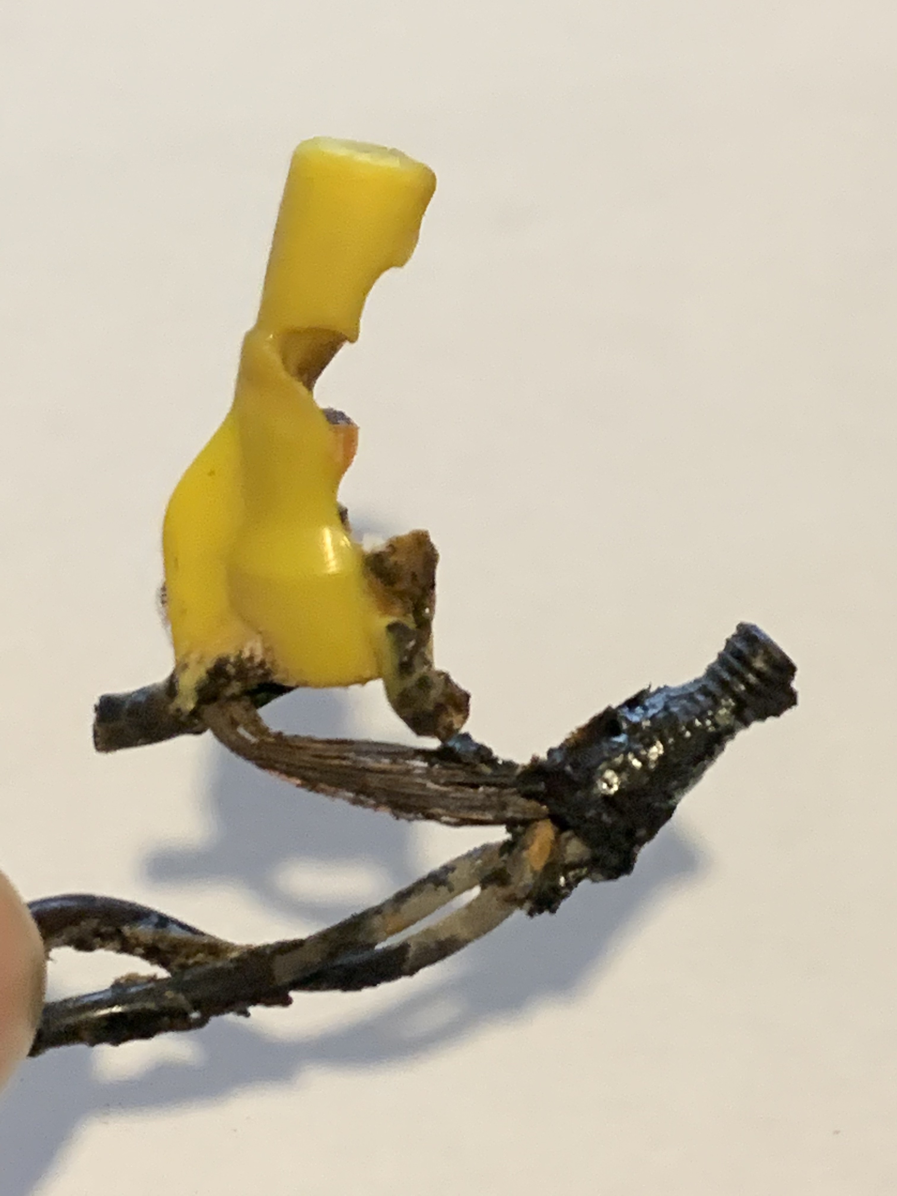

After smelling a funny smell I eventually found this melted mess in a ceiling fan junction box. I fixed it, but am concerned if there is something else I should be worried about. Any advice appreciated.
My guess is one of those connections was loose or corroded. A loose connection presents as high resistance and the voltage drop over the connection is dissipated as heat.

I’m guessing that’s the receiver for the remote control? Was that tucked up in the junction box above the fan? It looks like what got hot was a wire-nut connection and not the doohickey itself?

From what I am reading I think you are probably right. It was opened about 6 months ago when the fan remote quit working maybe a wire was knocked loose then. I am switching over to the uline connectiors to avoid using the plastic caps in the future.
It is all copper no aluminum. Not sure about the other questions but I will ask my neighborly electrician and see what he says. Thanks
Nothing wrong with wire nuts but I’m in the “twist the wires tightly before screwing on the wire nut” camp (as opposed to those who use the nut to twist the wires).

If I had to guess I’d say they were not properly together. Ie the one wire was not making full contact with the other full length of wire.
